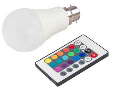

This Lampandremote.jpgis the cheap option, bulb and remote cost I think £9, my wife uses a remote from Lidi Lidi-remote.jpg it has key hole bits in back so can be wall mounted, but it needs the zigbee hub and zigbee bulbs.
Each option has plus and minus points, I use Energenie lights switches, had 5, now down to 2, and the remote Remote control.jpghas no handy way to mount.
The remotes can also be a problem the Energenie one will not work with the energy monitor, and the Lidi one would not work with relay only bulbs.

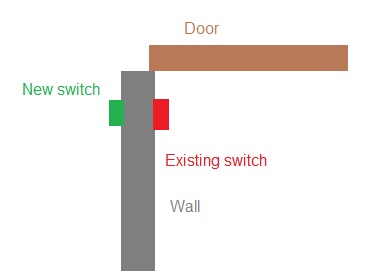

This may be a simple low cost solution
Remove the existing ( red ) switch and drill a hole through the wall where the switch was.
Fit 2 way switch ( green ) over the hole in the wall directly behind the existing switch,
Replace the red switch with a 2 way switch,
Using triple and earth cable through the hole connect the two switches as a 2 way switching circuit.
:) Not that "the other side of the door".. The current switch is on the hinge side so behind the door when I open it.. I want it on the other side so its easier to get to.
This is a room above my garage which is in absolute darkness as there is no light of any kind.. So I want a way to switch the light on a bit easier by making the switch more accessible.
That said, you have got me thinking now, the green switch in your drawing could be on the outside so could be switched without going into the room.. But it would have to be weatherproof and it would open a can of worms regarding protecting the circuit from the environment....
