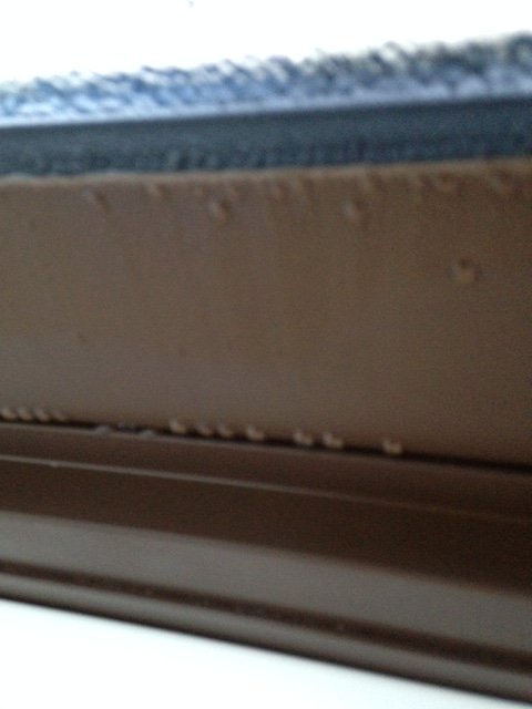

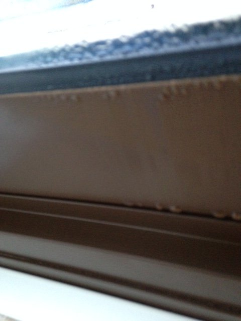

I am new to this site and am wondering what the solution was to the damp aluminium doors mentioned. My aluminium doors were fitted 3 weeks ago and condensation at the base of the frame has appeared. The fitter returned to fill the gaps outside with sealant and it helped with the problem for 2 days or should I say 2 mornings. I never had condensation problems with my upvc doors before and now I am at my wits end.
I have read so many threads that I can guess now there is a fault with the brand new doors as the sealant has not resolved the problem. Some hope from the forum, maybe....?

Can you post some pics inside and out of the worst effected windows? (showing whats above and around the windows too) There may be something that is more obvious in a photo.
Pictures attached. Condensation on base of frame on outside, not on glass. Sealant that fitter came and plugged holes outside has improved on below pictures and now left with damp on second base of frame and difficult to photo damp. Do you think it could be localised cooling because thermal break faulty or fitter still has more sealant to apply to outside. I am having a meeting with windows company in the morning and would be grateful for your view so I am not given the b.s. Regards Su

I meant pics of the whole of the window showing what is around under and above, So we can see the sealant, Walls, Lintels etc.
It wont be a problem with the thermal break other than the fact they are Ali. It is most likely either a moisture problem inside the house or thermal bridging somewhere.
