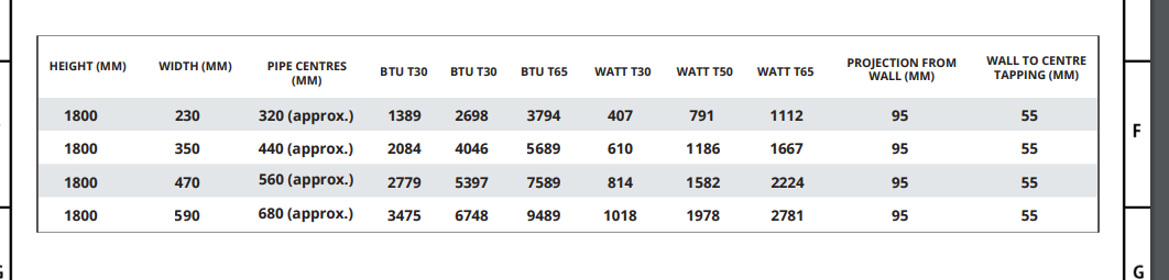

Are aluminum rads worth the hype? Looking at a high output but they're obviously more expensive.
Looking at the following:
This is the BTU output the larges one at the bottom.
Also where is the best place for rads in general?
The outputs aren't significantly to different to the steel ones. The 1800×590 aluminium is 1978w, the 1800×590 steel is 1832w (although strangely the web page disagrees from the specification sheet for the aluminium one and actually gives that a lower figure of 1789w). I buy all my rads from Plumbase. The advantage of the aluminium ones is that they aren't as heavy, the disadvantage is that they're much more prone to corrosion from poor system water quality.

Thanks, from everything I've read online everyone suggests going aluminum for the additional heat advantage that's why I've come on here to check with everyone.
I don't want to make the wrong choice as it's such a large radiator and a high heating output is required for a large room.
Essentially we are saying it's not worth the additional costs? As there is negligible difference in heating up the room but in regards to weight and installation makes this easier?

Common sense suggests there cannot be much difference. Aluminium, and especially copper, are both more thermally conductive, but the amount/thickness of the metal is so very thin, it presents barely any barrier to heat transfer, from the water, to the air. The big advantage, is weight saving, which usually is only important during the installation.
As suggested , lighter to fit, faster to heat up, quicker to cool down.
Additional heat, I wouldn't think so, maybe a little more efficient. Also as suggested, the system needs to be monitored to ensure it is kept PH neutral, otherwise it can start reacting.

the difference is with aluminum rads or steel at a given size is they can have a larger surface area as its far easier to extrude complex shapes and fine details in alu than it is with steel and surface area is what gives you your output this is more true in designer fancy radiators
take the ultra heat visage 595x1800 2151w at dt50 that one above 1978 or 1798w if the other figure is to be believed
or this one 470x1800 2343W at dt50
Aluminium radiators are no more efficient than steel ones. For the same heat in they give the same heat out. The only operational differences are:
1. They feel warm sooner than steel ones.
2. They go cold sooner then steel ones.
3. You can get them in fancier shapes.

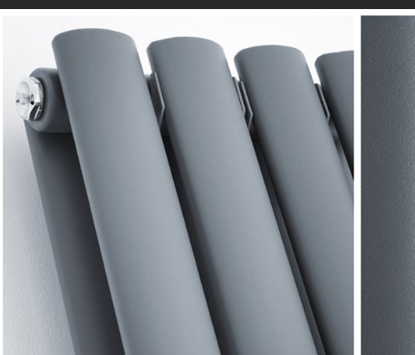

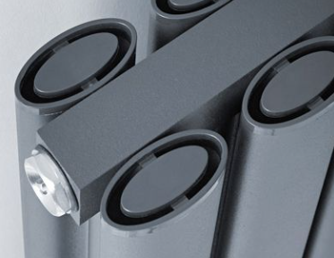

The consensus being that Aluminum is not worth the hype? I thought the rad linked had a more efficient form for heating/moving the air through:
Than over the steel counterpart:
Price difference
Alu - £665
Steel - £485
