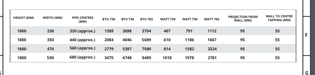

Hi all,
Are aluminum rads worth the hype? Looking at a high output but they're obviously more expensive.
Looking at the following:
This is the BTU output the larges one at the bottom.
Also where is the best place for rads in general?
Don't get the wrong idea about efficiency. Rads are all 100% efficient, as all the heat lost from the water goes into the room. Where they differ is in heat output, which depends on the size and type (single, double, with or w/o fins) etc.
IMO you should decide what output you need and choose a rad accordingly, making sure all the options are at the same water in/out temperatures. You can then decide which best suits your available space, and any other criteria.
BTW your table looks like column rads. That type seems to get a bad press on this forum.
It seems that Mr Baker has been taken in by "all this hype" which has no justification from any technical viewpoint.
If you want a higher heat output you fit a larger rad . That will be steel. And to be more efficient you would fit a conventional rectangular rad low down.
