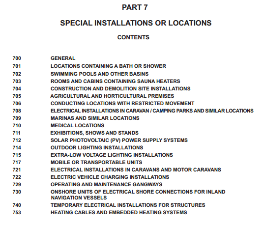

After all the heading of Part 7 of BS7671 is;
So without an actual definition, does that not imply that all those things are special locations or special installations?

Surely that means that the zones are not actually in the location.
After all the heading of Part 7 of BS7671 is; ................ So without an actual definition, does that not imply that all those things are special locations or special installations?
I don't think one can (should!) draw much in the way of conclusions about 'definitions' from the titles of Sections

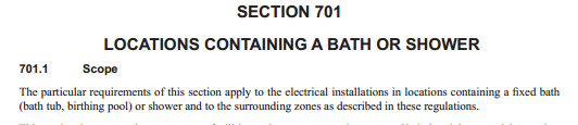

Does (or did) this clarify the situation or confuse it further? View attachment 334607
Do you mean because of "....and the surrounding zones as described ..... "?
If so, don't they mean the zones surrounding the bath or shower, rather than 'surrounding the location'?
Kind Regards, John
Yes, "and".
They do (I presume) but that means the zones are not in the location containing a bath etc.

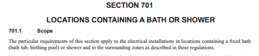

"The particular requirements of this section apply to the electrical installations in locations containing a fixed bath
(bath tub, birthing pool) or shower and to the surrounding zones as described in these regulations."
Agreed. Badly worded - although (dare I say it>? :) ) I presume that we understand correctly what they were trying/intending ti write?
