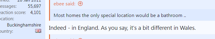

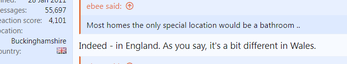

Most homes the only special location would be a bathroom ..
Indeed - in England. As you say, it's a bit different in Wales.
