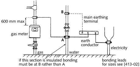

disconnect the existing earth running to the CU
fit an 8 terminal main earth terminal to the fuseboard and take a 16mm earth from the clamp on the service cable to it
take 16mm earths from the main earth terminal to both CUs
take 10mm earths from the main earth terminal to the gas and water pipes where they enter the house

Cant see any bonding cables leaving the board....
What are these?
The incoming service pipes (gas, water), assuming they are metal, should have a connection to earth. The earth cable that comes from direct from your incoming supply (BTW - is that clamp an approved method of connection?) should go to a main earth terminal (MET). The MET should then be connected to the service pipes and to the earth block in the CU.
