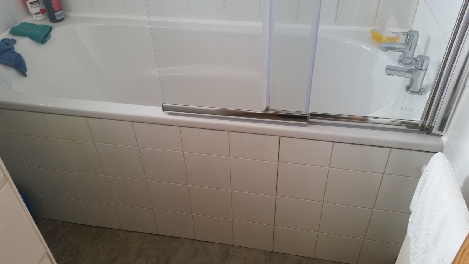

Am I being to fussy?
Lol he's gone now doing a 5 bedroom house now in the village. I'm tempted to knock on and let them know how bad he was.
We've found damaged kickboard's & damage to two of the doors he took off!! plus we've got to sort out the grout mess in the bathroom now.

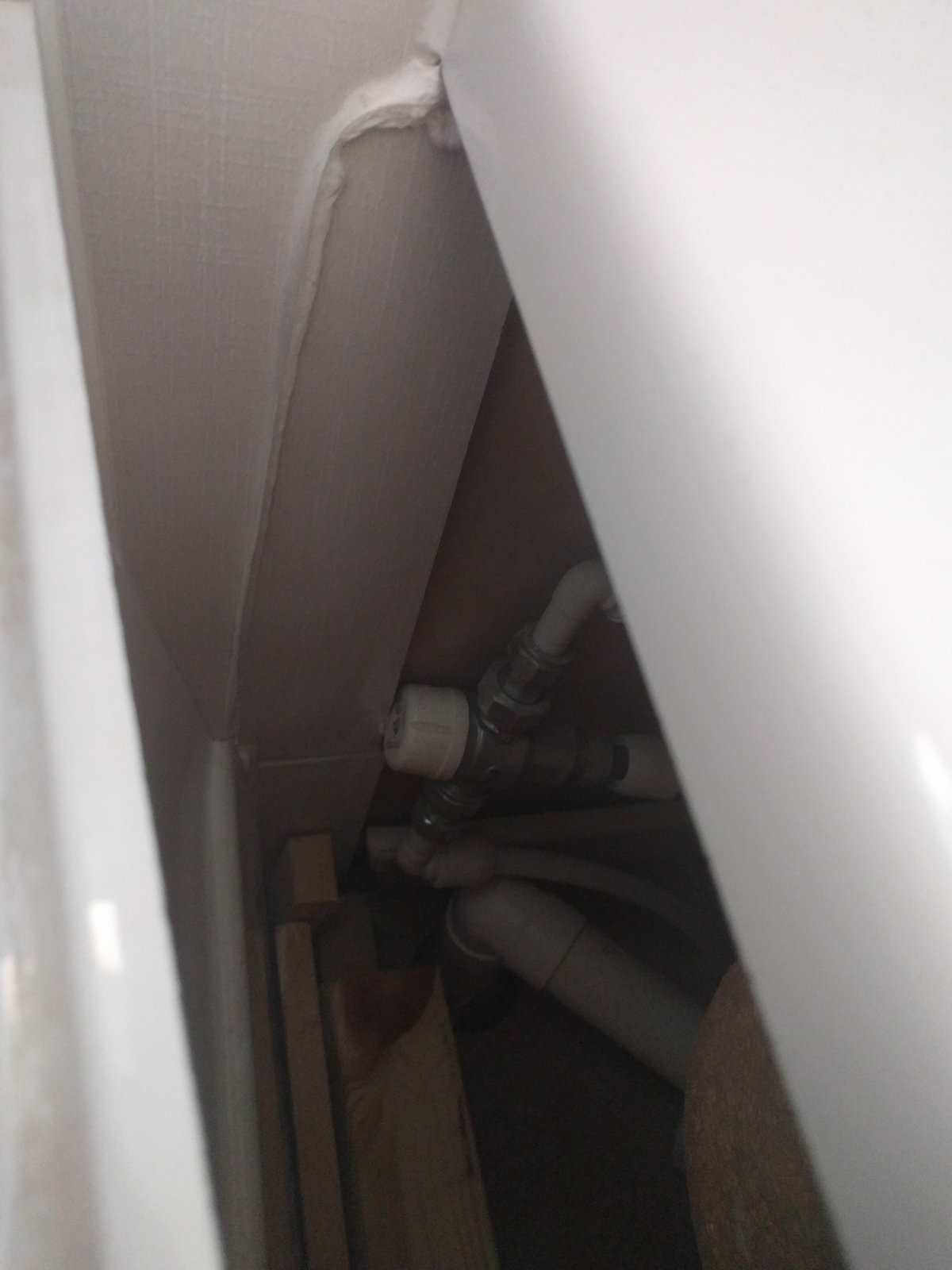

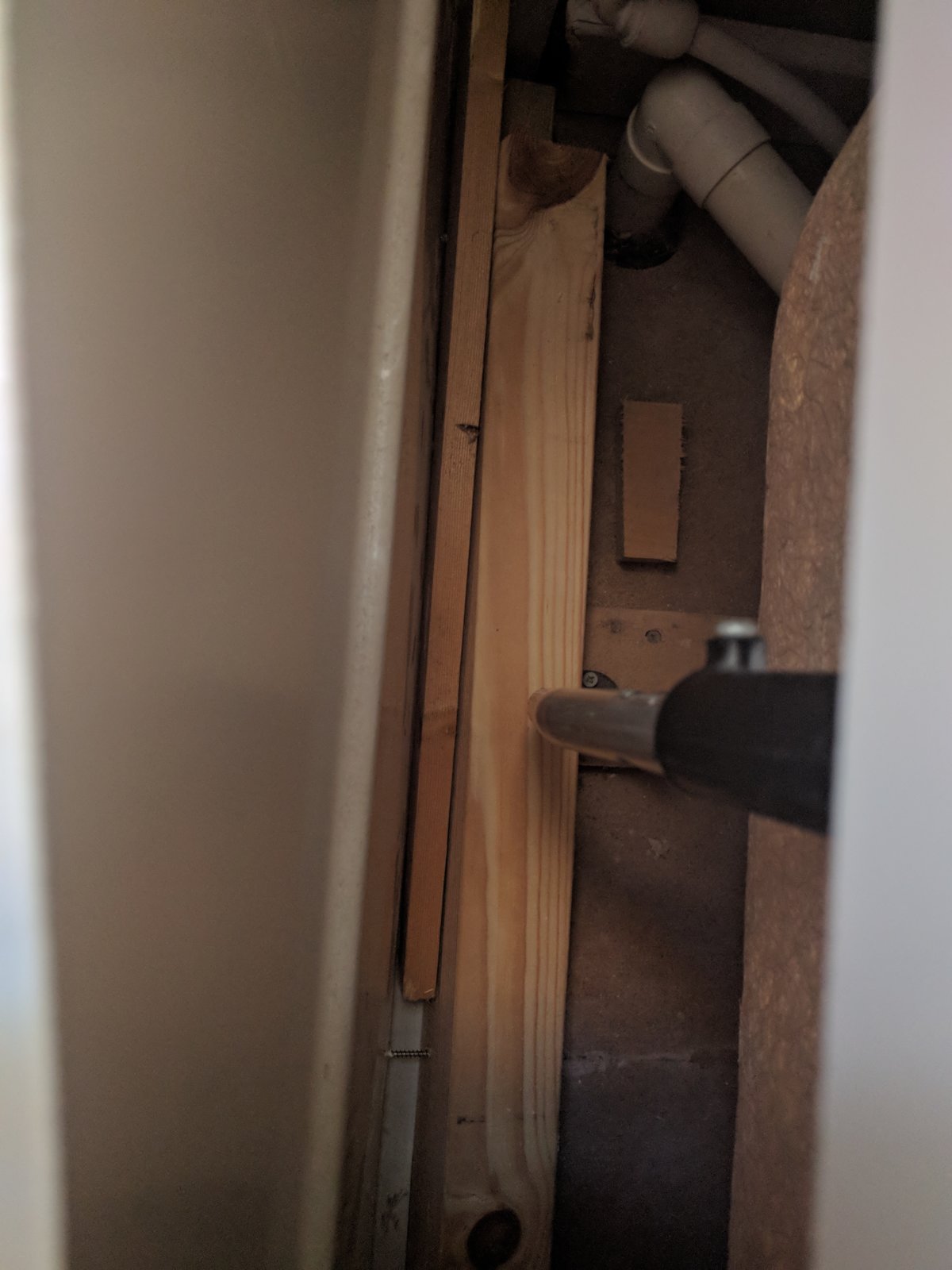

I don't suppose you have any pics?
That's what it looks like inside at the moment
Actually, that's pretty much as it should be, but the board under the leg is a bit minimalist, and needs to come out as far as it can. That' one is a bit small under the leg, and I suspect it could be a bit thicker as well.
So if I added another thin strip of wood Infront of the existing wood it would pack it out more.
Any tips on how to make the middle part more secure? Same thing put a strip of wood in the centre?
Adding another bit of wood wouldn't add any more strength. I use 2x3, and make it as long as possible to spread the load across as many boards as possible. But you could use 1x6" just as easily. It's a bit of a judgement call, but the trick is to change from a point transfer of weight under the feet, to spread the loading across a wider area, and that stops the bath sinking as you fill it.

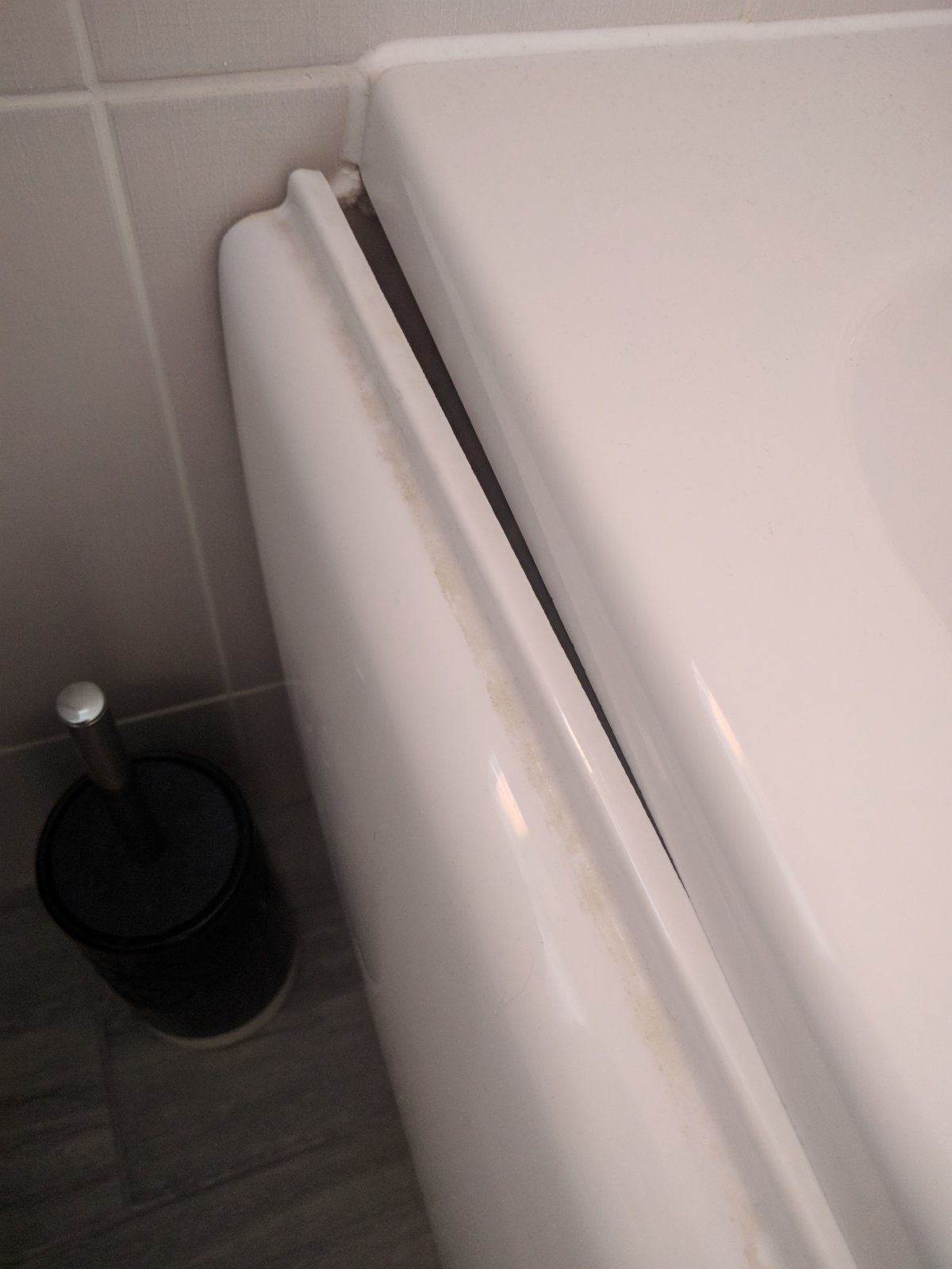

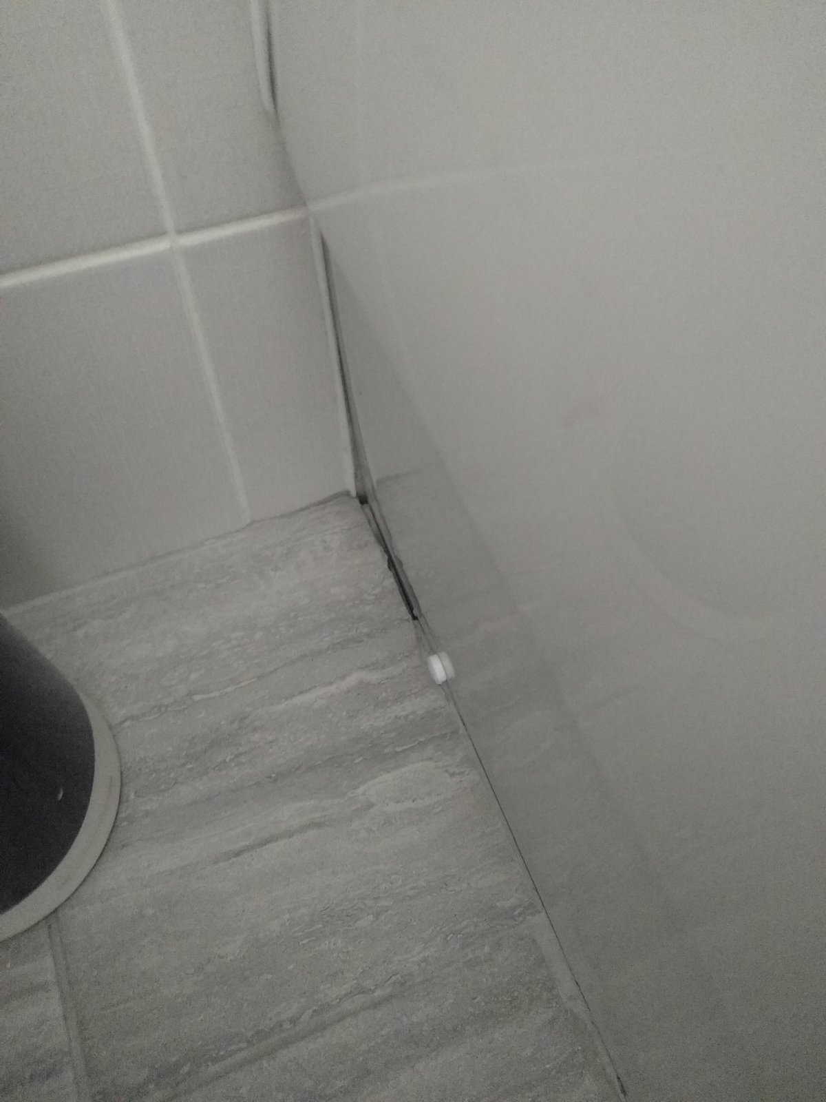

Trouble I've got is, I think the wood is glued down as I couldn't find any screws.
I think the acrylic panel fits underneath the wood and if that's the case it pushes alot further back which will leave me quite a big gap from where he's tiled up to.It will however stop the panel moving back any further
You can see in the pic that's the part that's causing me all the problems.The silicone on the wall isn't doing anything

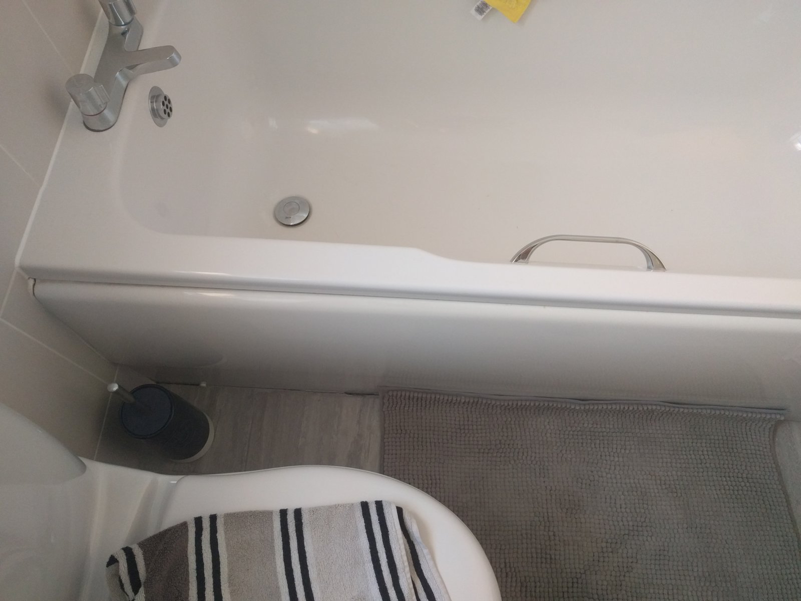

I made a frame for side of bath (which also acts as more support).
Made a solid panel out of MDF but painted and sealed it with 3 coats of varnish (especually the cut edges) and it's been fine.
We had acrylic panel and it was bloody useless!.
Was considering board and tile but found MDF tile effect panel so used that instead.
Don't suppose you have any pics?
It's nothing fancy, the right 1/3 is separate so easy access to pipes and stop taps.
Screwed frame to floor and theres 6 uprights where the panel is attached via velcro so it can be easily removed.

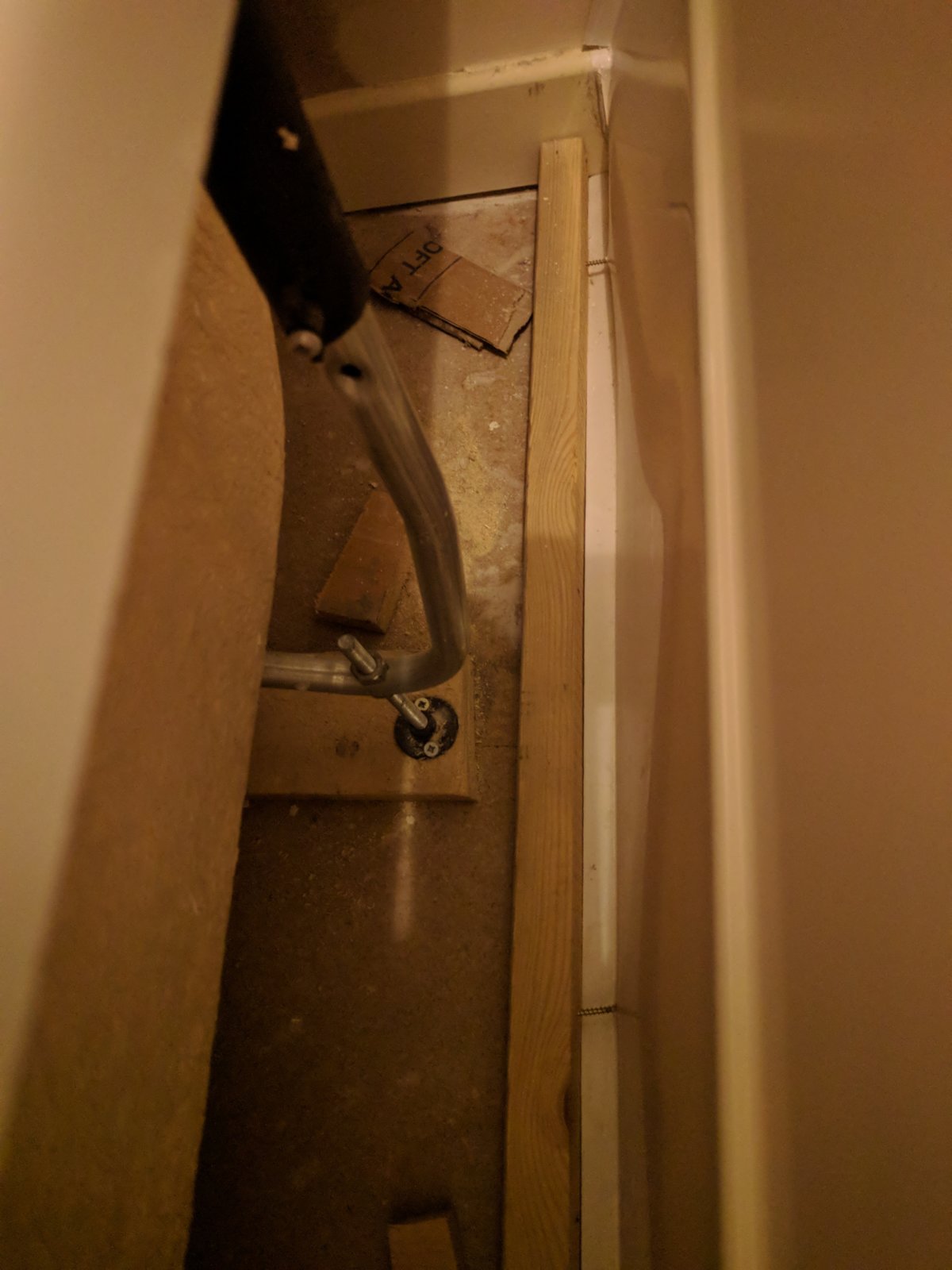

I'll have a play with the bath tomorrow going to get some wood and see what I can do
Right bought some more wood to make a sturdier frame only prob I have is once I've made the frame I've no way to access behind the panel once I've regrouted.
Any ideas?
I can't move the panel further forward to sit on top of the tiles as it'll be at an angle and look odd.
Other option I can think of but don't really want to do is cutting the panel from the bottom,but it'll look messy .
