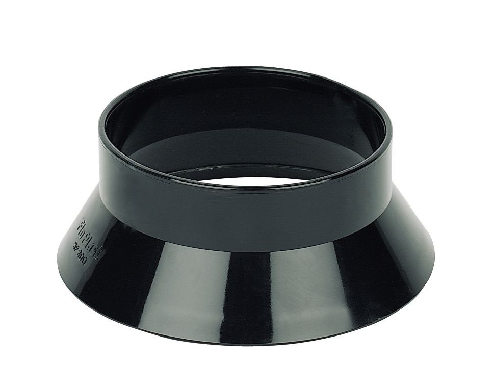

Does it have to be lead? A Macflash RS1 has a lot of play in it and doesn't have to be exact.
I had thought that since traditionally a lead slate is used for such purposes, that perhaps the type of product you refer to is more a temporary fix. Perhaps I am incorrect?
Would the rubber seal which is positioned exactly vertically straight up from the base be able to bend down by 70 degrees from the vertical, that is, 20 degrees from the horizontal base plate?
Not temporary at all but finding a 70° one might be an issue.
It is possible to have angled lead slates produced on a one-off basis, so I could probably have one made specially.
