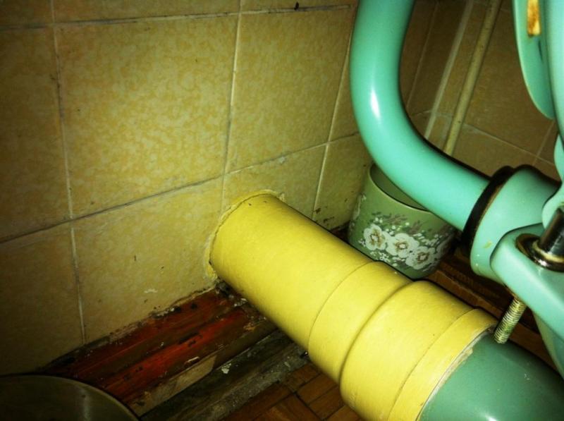

Soil Pipe leaking In Wall (Lead to Plastic) !
With respect to Delta - I`d go from inside and if necessary heat and bell out the lead to take a finned connector inside of the lead pipe . I`d rather sit on a floor and work than off a ladder ;)
Very true mate, but the chances are the lead is shot, or it will be when you put your cold chisel right through it!!!.............. :LOL: :LOL: :LOL:

Packing joints in cast iron fittings with putty and hemp used to be a way of sealing joints in the past. The plumbers mate route is a modern alternative. Its not the best solution (or guaranteed permanent solution) but it should work if done properly and last for a few years.
Is it just the photo or does the soil pipe extension off the back of the toilet taper down quite substantially?
Pics as promised.
The simpler the solution the better as far as I'm concerned.
Will filling the joint with Plumbers Mate work as this definitely seems the simplest solution and would save having to remive any tiles.

I think I'll definitely try going down the Plumbers Mate route first and, if not successful, then start bashing holes in the wall.
I think I'd be looking to get a new plastic pipe right through the wall with a new 90 degree elbow on the outside.
Then another short run of plastic before attempting a new joint to the old lead pipe, right out in the open where it's nice and easy to fix.

Do you mean removing the lead completely ! If so, how will the lead pipe be fixed to the cast iron stack and will it be easy to remove ?

No I was thinking that the plastic to lead pipe join might be better if it was just out in the open where you can keep an eye on it.
I'd probably be wary about disturbing the stack itself and would likely try and make the join not far down from the 90 degree bend.
It's hard to judge the lead pipe size and condition from a photo though.
The lead soil pipe has been compressed after the 90 degree bend (but has never caused a blockage) and so finding a decent piece of lead to couple up too before the CI stack will be difficult.

This is a picture of the where the lead soil pipe connects to the CI stack which I'm very reluctant to mess with for fear of creating/finding a bigger
problem than we have already.
