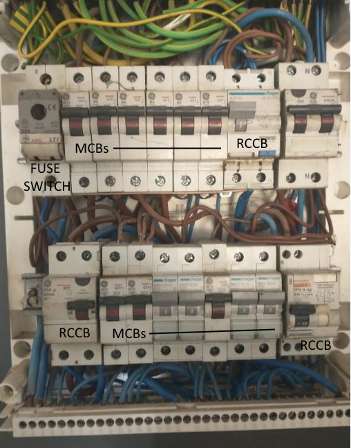

Another consumer unit question. Moving.
RCCB - residual current circuit breaker - earth leakage only - double pole device that covers several circuits with MCBs.
RCBO - residual current breaker with over current protection - earth leakage and overcurrent.
Both are RCDs - residual current devices.
MCB - miniature circuit breaker - overcurrent only.

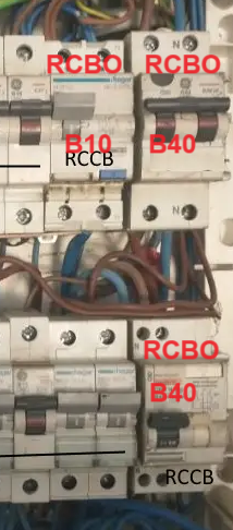

Thanks for this. You learn something knew everything they say. Which ones do I have then on my unit.
Ignore - Mistakes - see below.
