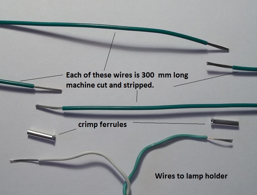

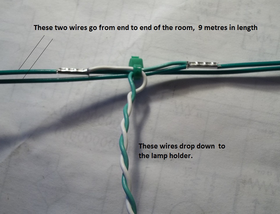

The design is to hang 372 lamps from the ceiling in 12 catenary strings each with 31 drops to the lamps holder spaced 300 mm apart. The drops vary in length from 4 foot to 1 foot . Each lamp is 12 volt 2 watts
The 300 mm lengths were machine cut and stripped.
Each assembled string will be tie wrapped to a support cable which will also feed the far end of the string to reduce the effects of voltage drop along the string.

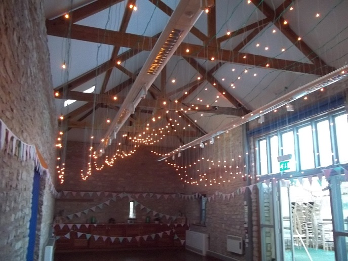

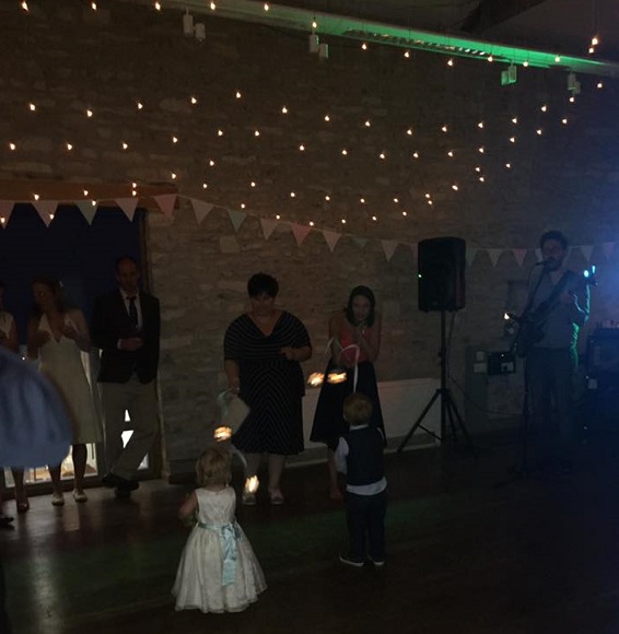

Seen in daylight, the 372 lamps in place for my daughter's wedding. At night during the party and dance they were the only lights in the room other than the band's disco lights.
