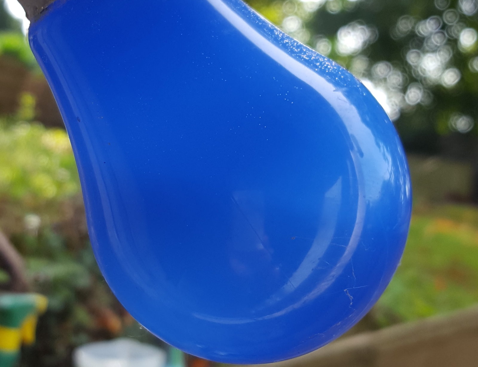

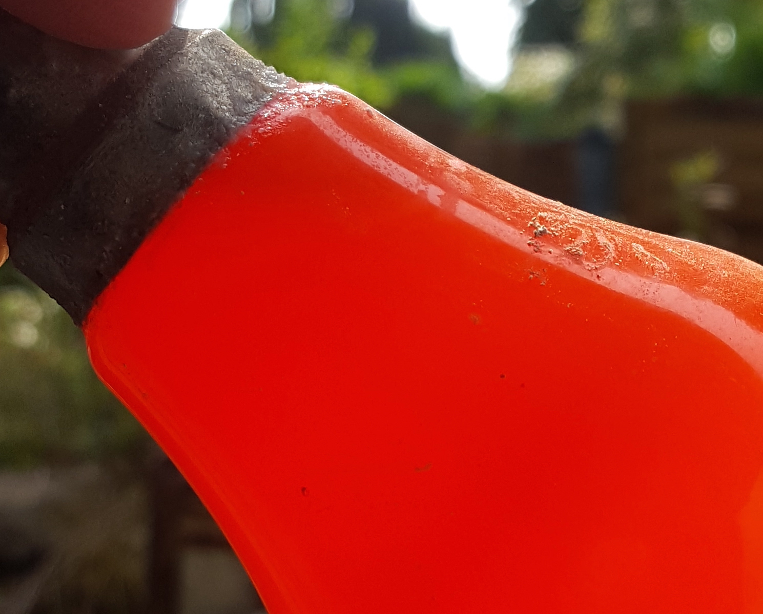

Well the issue is that water gets in, and thanks to the design is clearly causing a short that's putting the light out. It's clearly after the voltage dropping components as it's not getting hot - just going dim or out.
I'm thinking that if I do try and fix things myself, I'd take them apart and clean & lacquer (or equivalent) the boards to insulate them. Then put it back together with a dose of sealant between cap and bulb. Maybe even drop a few beads of silica gel in the bulb for good measure.
An update ...
The other evening it was pleasant as the sun went down, and we ended up sat outside. I put the lights on, and SWMBO almost immediately said "there's a bulb out" - actually there were two. Went and unplugged them, they were "a bit heavier than normal", the red one especially so o_O
See if you can spot the water levels in these photos (apologies, the camera wasn't straight for the blue one) :whistle:
Yes, the blue one is about half way up the main bulb, the red one is almost completely full :eek:
I think I'll try just drilling small drain/breather holes in the bottom of all the bulbs - it can't make them any worse :whistle:
