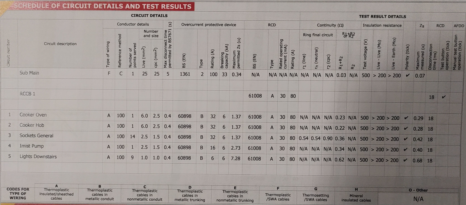

When the house was being built, I had a look at the cabling in the consumer unit, and that was the impression I got at the time. Perhaps I saw things in an unfinished state, or I was simply wrong.

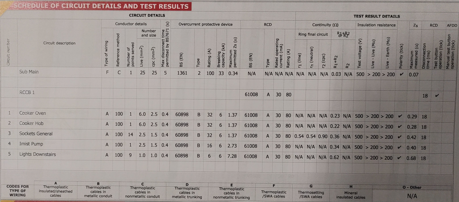

Anyway, last night I found the electrical installation certificate (circuit_details), and the size of the cables confirms its nature. I should have looked for it sooner before posting misleading information and looking like a fool. :oops:

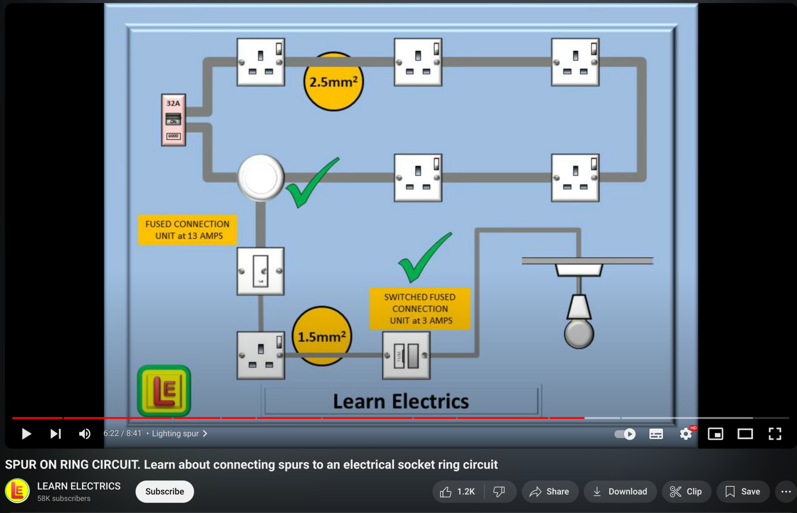

If the outside socket is part of the ring, then I would be in a similar situation as the one in this video.

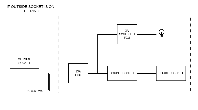

This way, "I" could run the 2.5mm SWA cable from the socket to the shed, and from there a 13amp fused connection unit before all the sockets. Another FCU, this time with a switch, would allow me to have lighting as well. (Diagram 1)

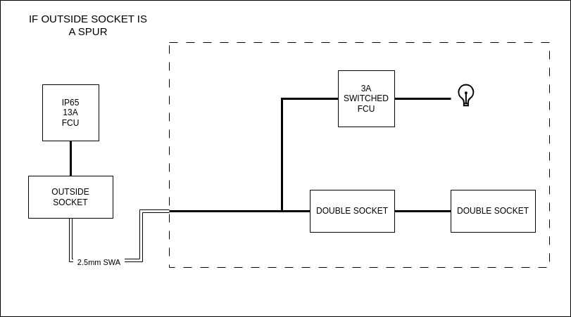

If the outside socket is already a spur, then maybe the least invasive way would be the one suggested by @Murdochcat, and so "I" would replace the outside socket with an IP-rated FCU, then connect the outside socket to that, and from there a 2.5mm SWA cable to the shed. Inside the shed, I would only need one 3amp switched FCU for the light, whilst the sockets are fine as is. (Diagram 2)
This is the most likely scenario / solution
I would say most outside sockets are spurs off a socket that’s part of a ring….usually the hole goes out the wall behind the socket, then outside either straight into the socket, ot surface mounted cable to a suitable location.

The work, as proposed, is not notifiable as it is an addition to an existing circuit.
BUT, on completion, your electrician will need to provide a certificate that says that the DESIGN, INSTALLATION and TESTING work that HE (SHE) has done conforms to BS7671 (The Wiring Regulations). You must get them in at the start and they can approve your plan and tell you what (if any) of the work you could undertake.
