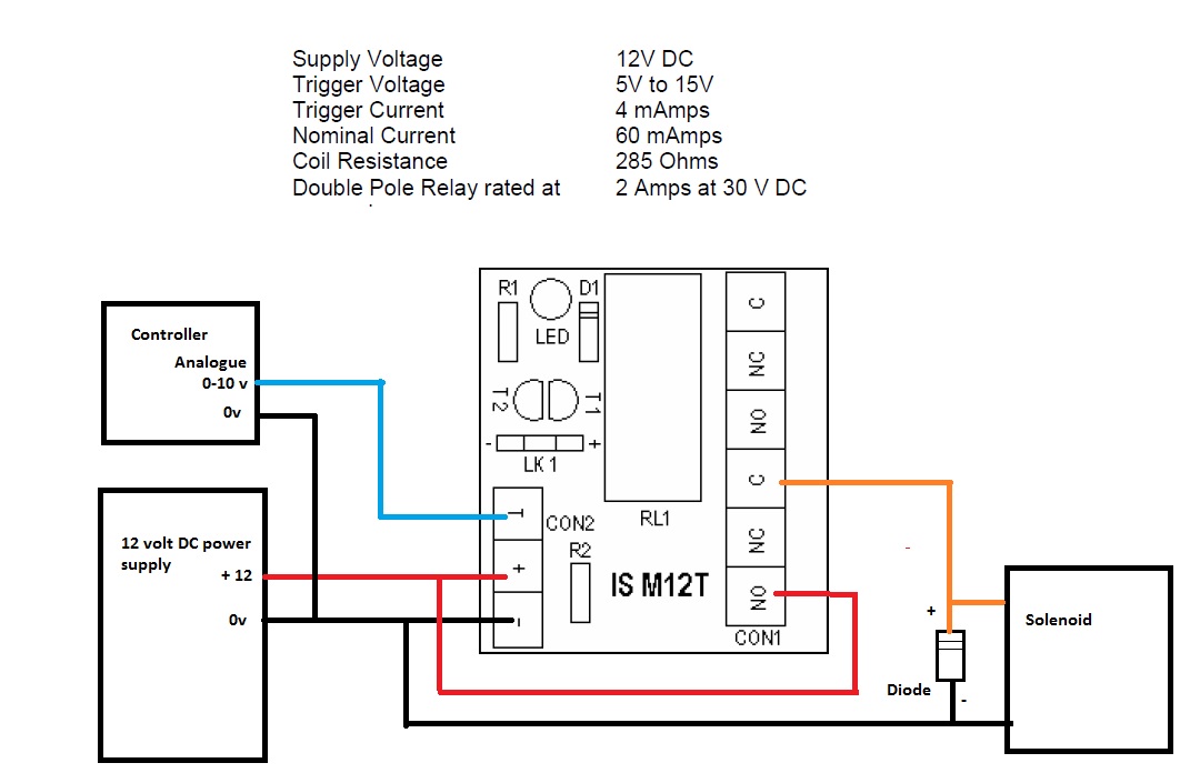

Any electronics people? 12v output and 10v input

Hi,
The specification of the solenoid is
  • DC 12V 1/4" Quick connect Solenoid valve.
  • Turn on water when system start;and cut off water when system stop.
  • Working pressure:0.02-0.8Mpa
  • Rated power:4.8W.

Probably the easiest way is for you to buy one of these
https://cpc.farnell.com/interface-solutions/is-m12t/relay-12v-trans-dp-single/dp/HK00987
and connect it like this
Thinking some more about this and taking into account (a) your level of experience based on your comments, (b) a guess that this “aquarium computer” is probably not cheap, and (c) knowing how much back-EMF you can get from a solenoid, my suggestion would be to get an opto-isolated relay module. These are widely available from e.g. eBay etc.
Thank you. Yes, I'm a total novice... and yes the aquarium controller is expensive :)
I'm going to order a few of the options here and have a play with each one. I will report back.
