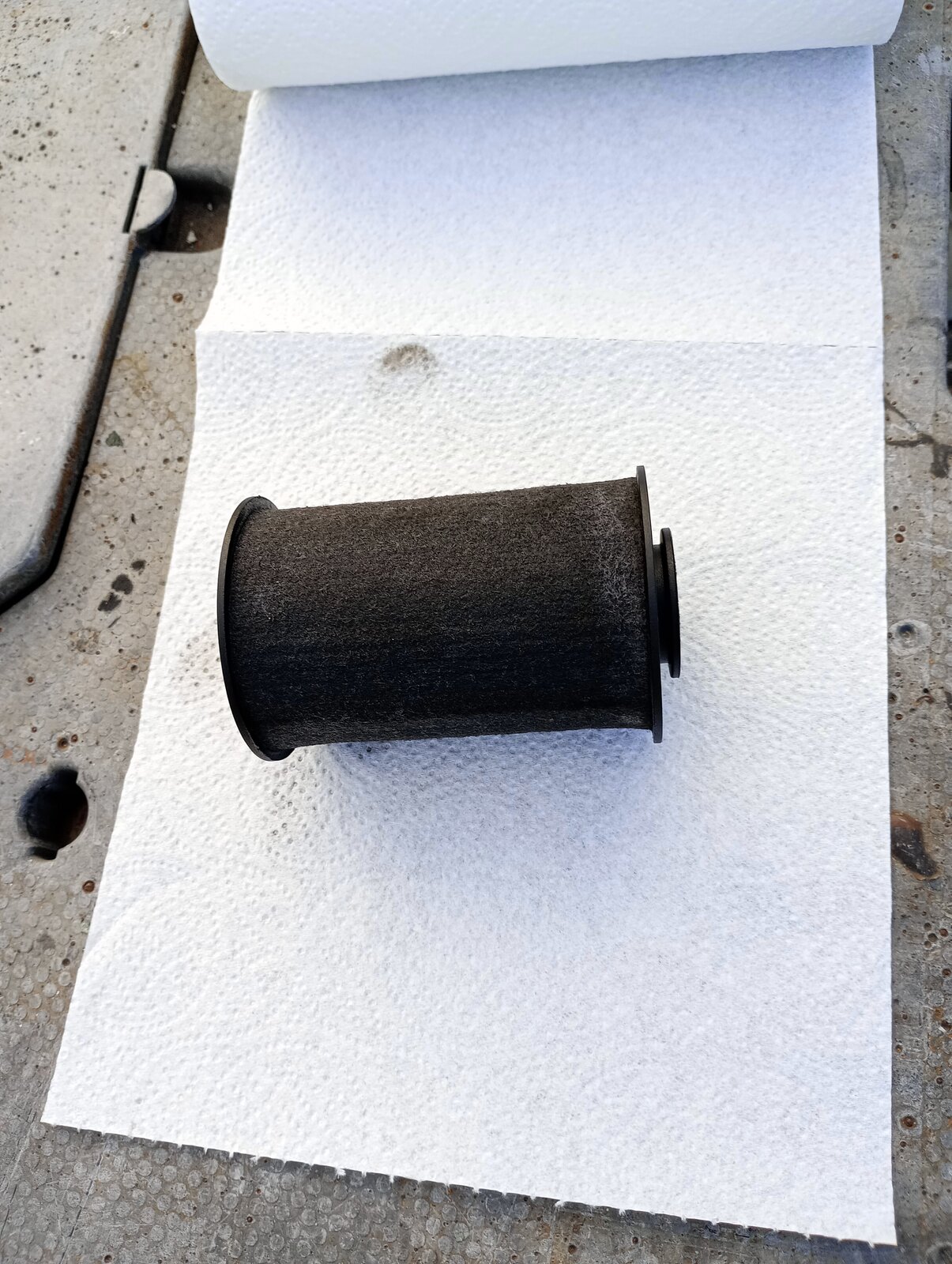

PS don't suppose this was helping (fuel filter)
Good news! Were you able to see any water in the filter bowl?

Oh yes, the actual fault was interesting. Split in the leak pipe from the injectors- which returns to the input on the prefilter (glass bowl). There is no lift pump- there's a suction pump below the injector pump (so sequence is line from tank and leak line from injectors > prefilter > suction pump > main filter > injection pump. )
This means the fuel line is at low pressure so split = no fuel from tank rather than diesel ****ing everywhere. Cute solution really :)

No, no water in either fuel filter (lot of cr*p though). Think @norseman was right about the noise being due to Easystart- probably detonating.
