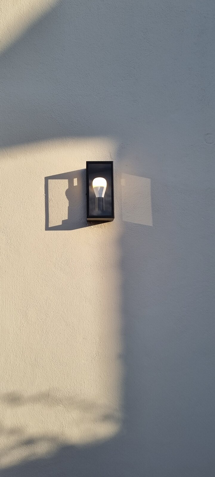

Studied the wiring diagrams to understand what was going on, looked at the pictures of the changes to be made and plucked up the courage to give it a go.
For the first time in 8 years, I finally have an outdoor light!
After checking the changes worked, I removed the brown sleeves on the neutrals I changed in the light fitting and switch as i understand they're no longer switched live; hope that was the right thing to do!

the blue in the left light and 3G switch has changed from a live to a neutral, the right switch and 2G switch stays as it is.
Now the next thing is it requires testing with an appropriate meter and paperwork to be issued.
Well done for getting this far.
