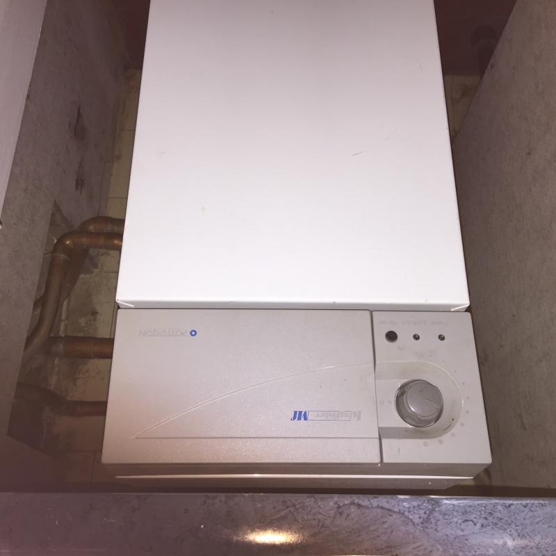

Hello all again, apologies for not replying sooner and thanks for posting responses here. Further apologies that my own lack of knowledge is contributing to making this harder to discern what's going on. It may be worth me flagging the bits about the system I do know and then explaining its current behaviour.
What I know about the system:
The system has a potterton boiler installed c 2002 into a kitchen cabinet (this gives it access to a Chimney). Here is a picture (apologies this picture is upside down!):

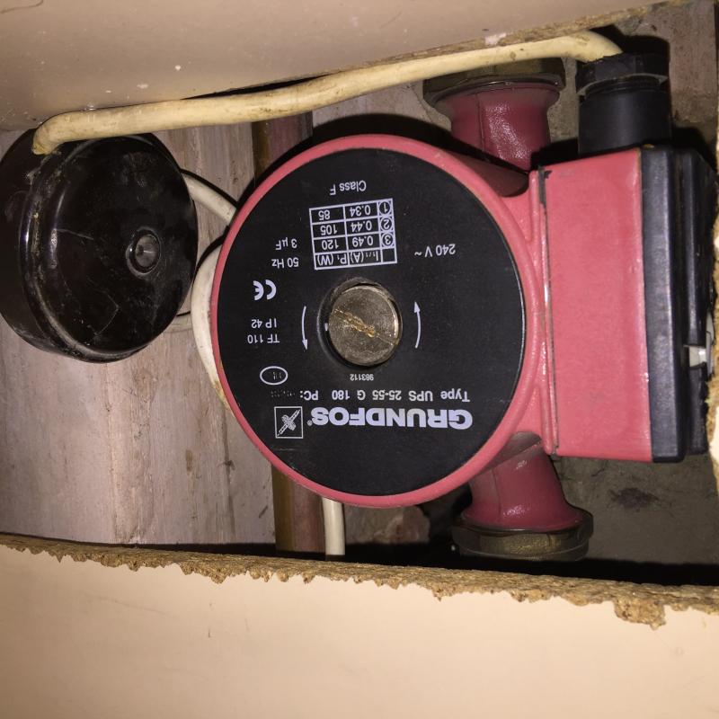

The pump is installed next to the boiler, not in a kitchen cupboard but accessible through a cut out in a cupboard (apologies again this picture is upside down!).

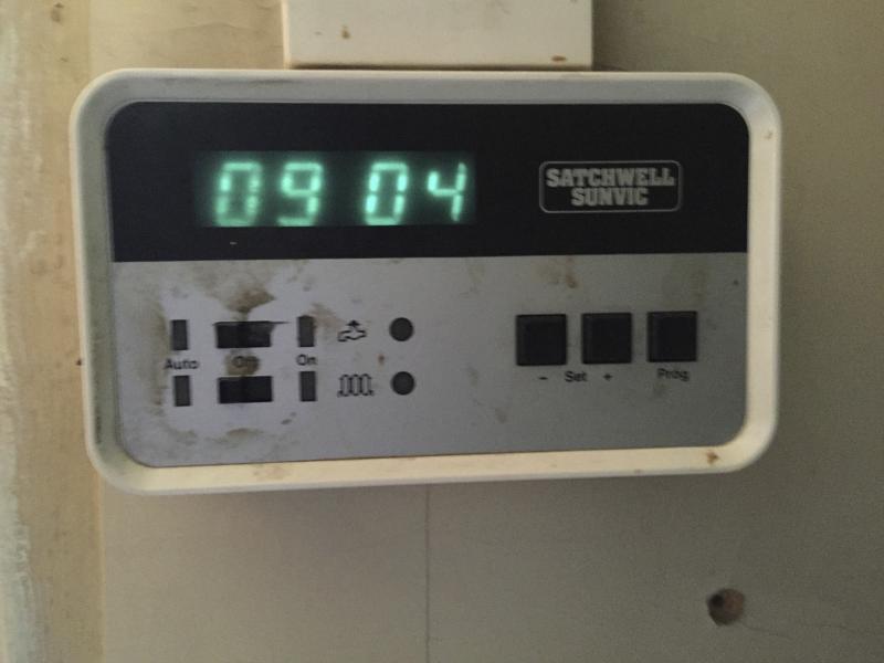

Historically the system had an old Satchwell/Sunvic Programmer (seems likely to predate the boiler and is now removed) and a wall thermostat installed :

That suggests to me that the original programmer has been removed and the Nest is being used to switch both the central heating and hot water together. But if so, this doesn't make sense. How will you have the hot water only on in the summer?
Usually the old programmer is left in place and used to control the hot water, whilst the Nest looks after just the heating. Unless there is some limitation on the system. So we're back to not knowing how the flow of the water from the boiler to the cylinder and radiators controlled and distributed.
I'm still unclear about what control you have, unfortunately the photos don't help any, I know what the various components look like, it's how they relate to each other that is important.
Having said all of that, if you can have the hot water on without the central heating and if the cylinder thermostat is actually stopping the boiler firing when the cylinder has heated up, then I don't see how you will achieve any savings.
