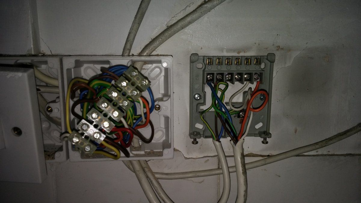

Can you identify what is connected to each terminal in your junction box? If so, post the info and I will modify the diagram.
I will try and post a picture tomorrow, it's spaghetti junction at the moment...

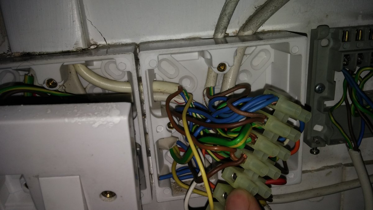

Regards to the wiring, i've attached a very crude diagram (the best I could do). Just a few things to note: The light gray cable in the diagram is actually white. I suspect cable 1 is the room thermostat Cable and Cable 2 is the cycliinder thermostat (only by determining where it's corresponding wire ends up connecting to on the programmer). FCU is fused connection unit. And i notice the 2 zone valve has only 5 cables not 6 (the cable directly from the valve actually goes to a junction box first which looks like it was put in to extend the cable length to the main junction box but i haven't managed to look in there to see if the 6th cable is present). Also, some pics of the mess of cabling....
The valve needs six wires to work correctly - Brown, Blue, Green/Yellow, Grey, White and Orange.
Please check in the junction box - the grey wire is not shown on your diagram. I can't do any more until this missing wire is sorted out.
Edit: Which cylinder stat do you have; and which wire goes to which terminal? This could explain the missing grey wire

It's not just a wire missing! The whole system does not follow the C Plan wiring. (Ignoring terminal numbers.)
It would be safer, for the moment to turn the programmer back to gravity
Which pipe is the motorized valve in? It's important
