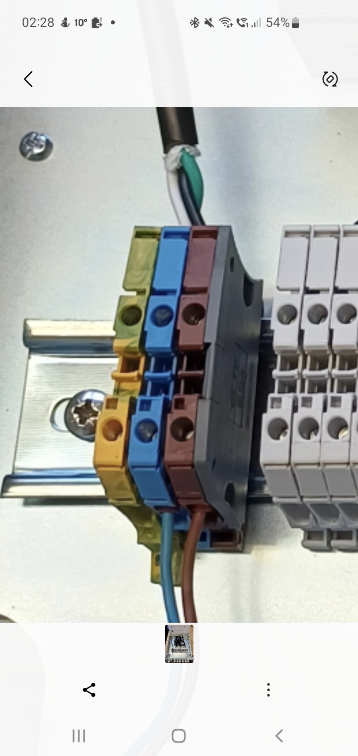

Anyone know what brand these terminals are?

Anyone know what brand these terminals are please?!
Need to link the mains out to another box, so need additional terminals and push-in links, but I forgot to check the brand before I left!
Cheers!

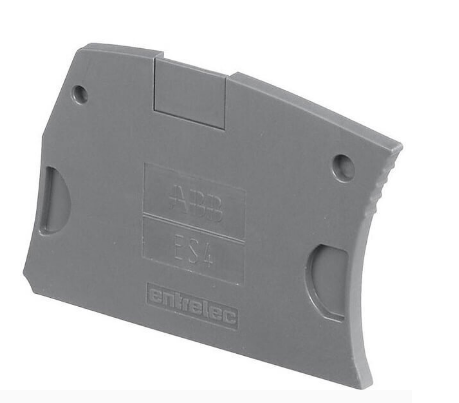

They look like an Entrelec terminal to me, but not entirely sure which model.
The grey end plate on the brown terminal has info printed on it.
BTW whoever built that assembly seems to have been cuting corners. There don't seem to be any end stops to prevent the terminals sliding along the rail and seperating (which given that din rail terminals are only insulated on one side is a rather suboptimal situation)
At least it's an earth terminal at the end although with nothing connected to the bottom terminal rather than a live with exposed terminals to the side!

I have a box of very similar shaped terminals by entrelec. :)
After looking through a box of random terminals earlier today I have 4 different designs of Entrelec, I came back here to report I have a couple of ABB ES4's. I see in EFL's picture the markings are different to my older products and now show both names.
I assume there has been a merger of some sort
The live terminal has an end plate to provide insulation but I agree there should be end stops.
I take it you are aware that earth terminals make contact with the DIN rail.
The earth terminals can be used in place of end stops, not as good as a screwed stop but that's what the manufacturers say.
A lot depends on the make, some have a really good screw clamp (such as Wiedmuller) and I tended to use them instead of end stops until the price went through the roof... one can never have too many earths :mrgreen:. However on some the earth connexion is only just strong enough to break through the coating.
EDIT: It also depends on the end stop, some are not fit for purpose :cry: and the matching earth terminal offers a better solution.

They're a stock item at RS, and I realised that the manufacturers of these boxes had installed spare terminals that weren't needed. I repurposed them, and ordered the jumpers from RS.
To be honest I wasn't aware that end stops existed or were needed!
In this case the box will never be opened up while energised so I'm not going to lose sleep over it, but I'll keep an eye out for end stops in future
