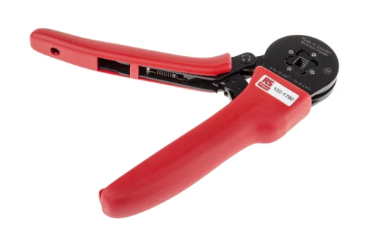

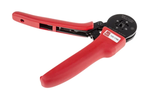

I prefer a universal type crimper such as these:
https://www.ebay.co.uk/itm/UK-Bootl...r-Crimping-Tool-Pliers-0-25-10mm/174237351843
Saves having to pick the right die when doing different sizes, and the need for another tool for the doubles. I think 10mm is a bit optimistic for those though!
I have used one of this style but found it was tricky to line up the square crimp to align it with the sides of a double ferule. I'm sure, like most tools, the knack is quickly learnt but not in the short time I used it for.
What problems do you have with Omron bases?
With the P2RF-08-E cream 2 pole relay bases the terminals are so small that I cannot use a double crimp and 1mm crimps are either very tight to get in or only fit part way, especially when you have 2.
@Magicmushroom - thats the same as the one I have, I prefer it as its 1 size fits all - very clever design I think.
neat design. How does it know when it's "tight?"
It's not a problem I've had, admittedly 1mm is as far as they will go and 2 single 1mm's are OK but the plastic parts do collide. I find this style of jaw: https://www.cablecraft.co.uk/crpt-0-5-16-plier-action-tool-for-cord-end-terminals-size-0-5-16mm or https://www.tlc-direct.co.uk/Products/DVDCER510.html (Note I'm referring to style of jaw and not the whole tool) makes 1mm very difficult, or impossible, in them and certainly cannot get 2x 1mm in.
EDIT: I find the 14 pin base is a bit tighter and 1mm is tricky. Trying to get 8 ferrules side by side doesn't happen.
Don't know about this exact tool but the one I used didn't know, it relied on feel.
