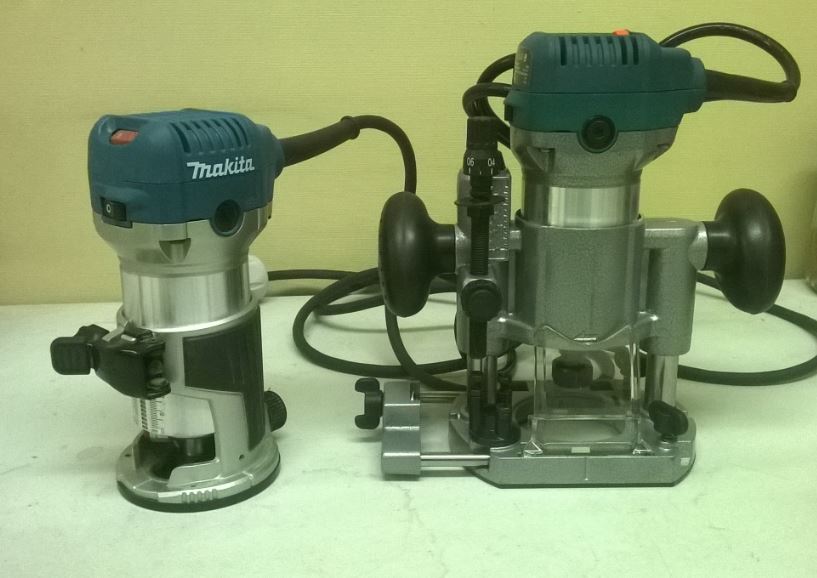

It's sort of mish-mash between the top end of a Bosch GKF600 (Colt in the USA) and the clear plastic laminate trimmer base which used to be fitted to laminate trimmers by Makita, Hitachi and Ryobi. Katsu also make quite a reasonable copy (i.e. very close knock-off) of the Makita RT0700, their model 101748. The motor from that one fits all the Makita bases and the Makita motor in turn fits all the Katsu bases (fixed base with side fence, plunge base and tilting base) - even the collets are identical and interchangeable. Those are also available on Amazon (see link above) although you are paying more for the better quality aluminium base. I went for that model because I believed that it would be much more durable. Personally, I.ve never liked those clear acrylic bases because they mark far too easily, they won't stand rough handling such as being dropped and they can also develop cracks as they get older (had that on both Hitachi and Makitas at work). BTW the follow guide bearing looks OK in the photo, but the bearing itself wobbles about a lot making it pretty useless for accurate work, however that should be curable by just fitting a decent quality screw and bearing, I think. I've not had mine long enough to make comments on useability, durability, etc but the tools seem to be naccurately machined and reasonably well made if not quite as well finished as the original Makita
Above: Makita RT0700 in fixed base (left) with Katsu trim router in plunge base (right - model 101492). The motors and bases are completely interchangeable between the two

The 101492G I have with the plunge base is a great little router (as is the RT0700 I have at work) but you need to realise its' limitations. The collets are so small and the power so limited (at circa 700 watts) that you are going to be limited to doing stuff like rounding over edges, cutting small coves (up to say 6mm radius), running small groovers and rebate cutters, etc. You are never going to run panel raiser cutters in it or do deep mortising with it. They also tend to struggle a little on hardwoods like oak unless the cutters are dead sharp and you reduce the feed rate and/or the depth of cut (not an issue, just make 2-passes instead of 1). But they are beautifully light and easy to handle - I find the plunge base with its' two-handed grip much better than the one-handed grip fixed base which can be a bit awkward on some cuts. That said, though, the first router I ever owned was the much-lauded (in its' day) Elu MOF96 (plunge router) - and that only had 600 watts of motor power.
In reading this please realise that I'm a carpenter & joiner (mainly site-based) and so I expect a lot more out of my kit than most DIYers. Also my kit is subjected to more heavy (ab)use that the average DIYer will tend to mete out, so my comments are necessarilly somewhat biased by experience

I think so, yes. The 101492 is the kit with fixed, tilting and plunge bases (I bought one a couple of months back), the 101748 is the basic trimmer with the fixed base only. The "G" suffix indicates 110 volt (for site use). Possibly not up on Amazon because they've sold out?
