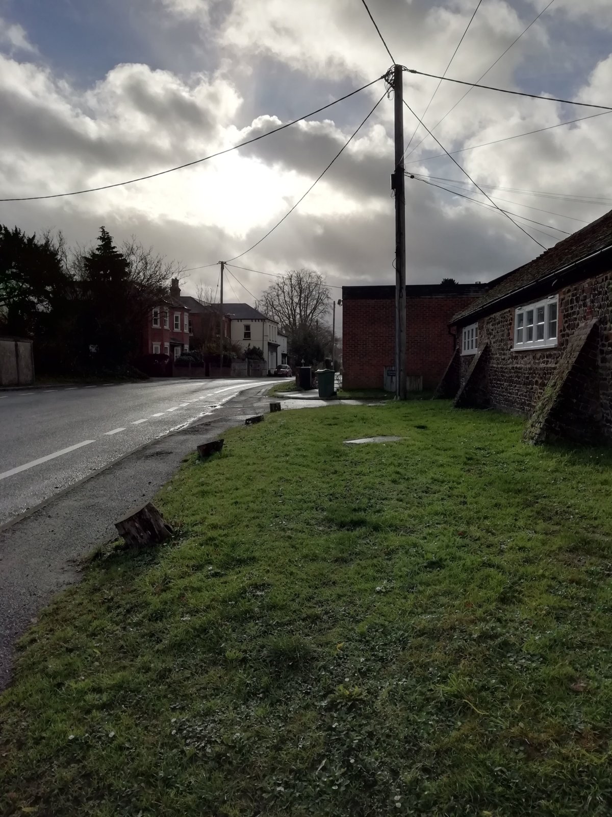

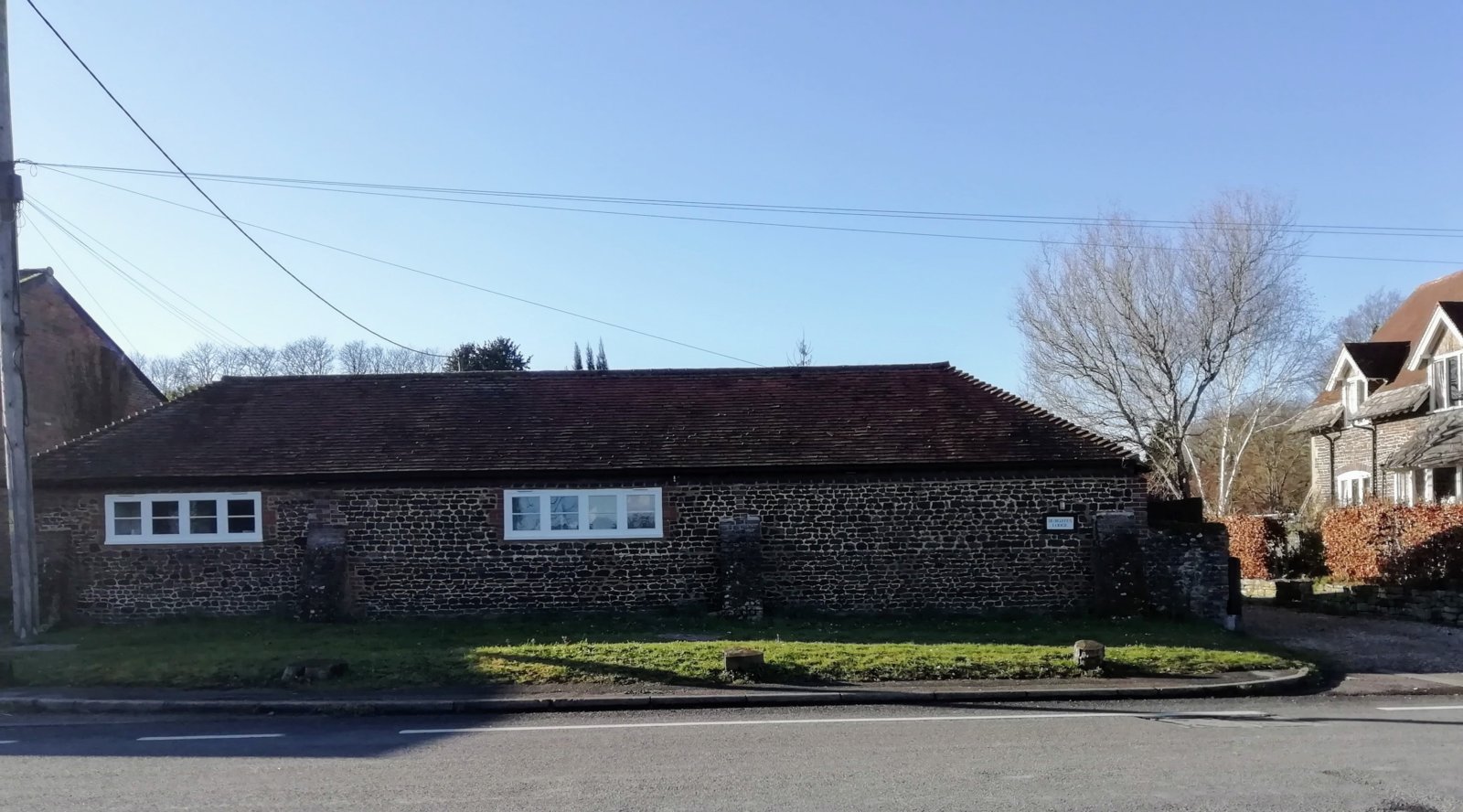

Thank you all for such considered comments and yes, it was never going to get LBC according to the planning consultant, even with the drop kerb scrapped. Eventually I plan to sell the property so am keen to make the frontage appear more appealing but staying respectful of the setting and the fact that it fronts a B road but is adjoining the entrance drive to a listed building.

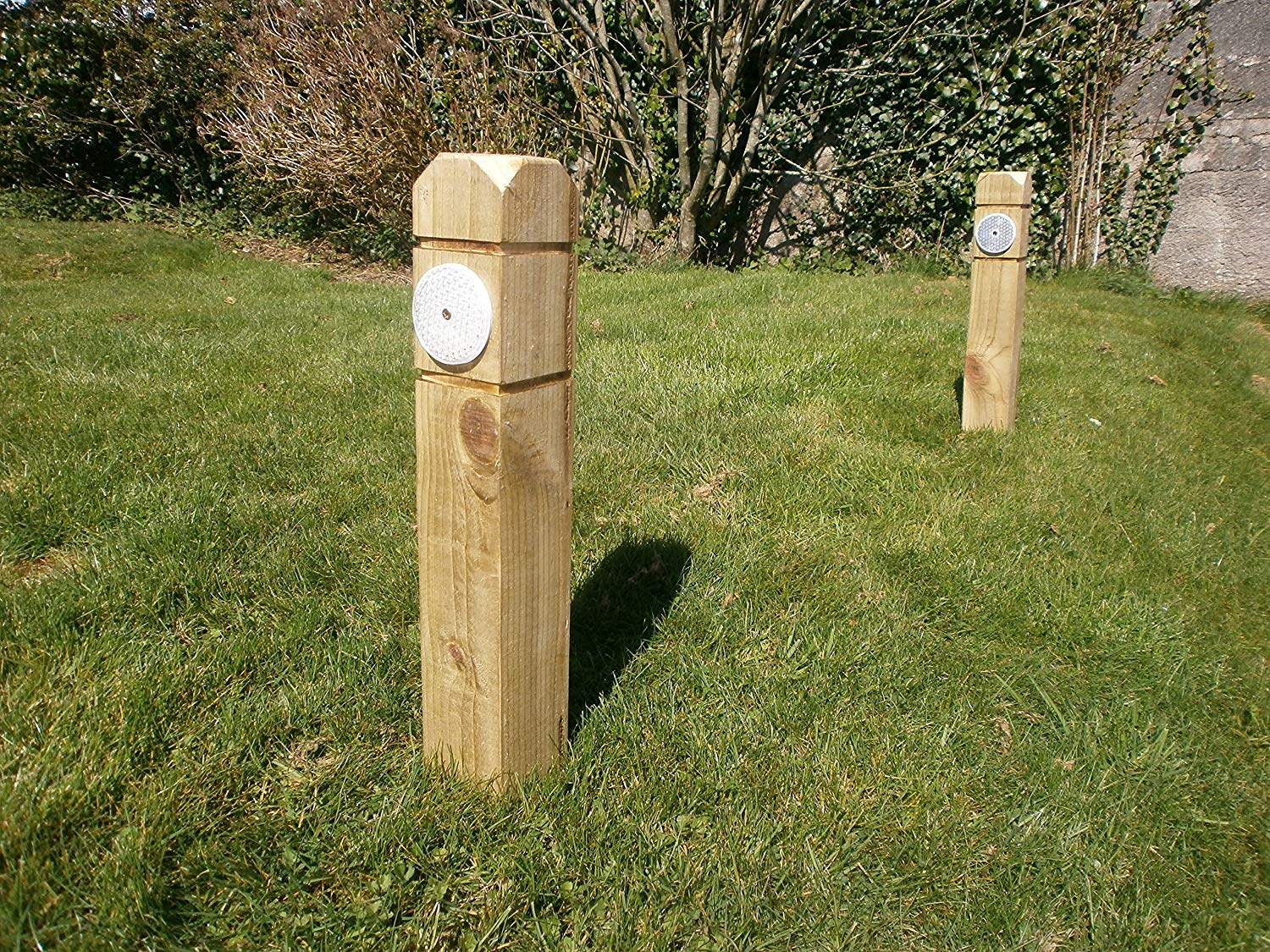

I need to consider the sight lines at either end and want to be compliant with conservation area and SDNP policy. I'm thinking of putting a few low posts along the boundary as shown in the last thumbnail and would like to put something quite impactful but within the spirit of the environment... any ideas?
Hanging basket at each end? A foot-wide run of white stones/gravel along the wall of the house and planted with shrubs? Maybe a couple of large tubs with statement plants in, although I believe anything would need to be under 1m in height?
You can see that it's not symmetrical as the 2 long windows are set to the left, so it's quite hard to envisage how to make it appear as if the frontage which is essentially a large grass verge, is part of the house and is actually the front garden. It's 19m by 5m.

In our area the Highways requirements for visibility splays for informal access roads ,access courts and minor access ways are for a clear view over visibility splays at the junction with a road with visibility at 0.6m above road level. If you are already using a planning consultant they should be able to advise on the requirements in your area and possibly offer suggestions for the best way to delineate your front garden without upsetting the local authority.

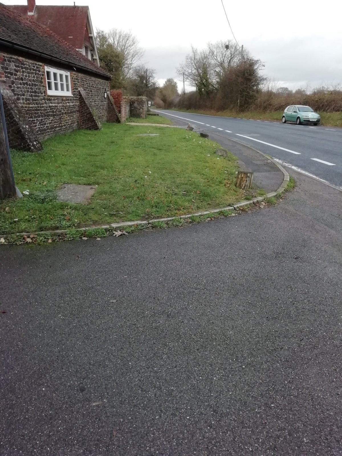

On a different note, given the previous troubled planning history there might be one other consideration. Looking at the photos I would say that grass verge, even if it is shown on your deeds, could be classed as public amenity space. If you are going to start putting up timber posts and planting using it more as a garden you might need to get change of use. I'm just flagging it up before you go and spend a load of money only for the Planners to come back and slap you in the face.

Thanks for this, I went though Extinguishment of Highway Rights over 10 years ago and all utilities pay me a wayleave sum each year, so ownership is not an issue thankfully, but really appreciate your input!
Do you think if I planted things next to the building wall they could be over 0.6m, the highways dept had no problem with the sight lines/splays on the proposed plans so as the porch was to be full height I'd assume that would be acceptable?

Just to clarify it's nothing to do with ownership, it is the use of the land. It can be in private ownership but the use is public amenity. It doesn't mean the public have access to it just that it has to be in the public domain providing a nice view or a vision splay for the highway etc.
The vision splay will have a notional diagonal line running between the side road and the main highway forming a rough triangle. Nothing in that triangle can be higher than 0.6m, not even plants you are expected to keep plants trimmed down so they do not get too tall. From the photos it looks like plants against the front wall of the house would be outside of the vision splay. The porch possibly not.
Ah I see, the land was deemed 'surplus to highway requirements' and a stopping up order was granted, the notes that came with that said that this process removes public highway rights. There is a suggestion from the local authority that I retain a visibility splay which this would do, and that no structure on the outside boundary should be higher than 1m.
I haven't heard visibility splays at road junctions called public amenity space before but if the visibility splays were shown on your plans can't your architect and planning consultant advise on simple things like suitable boundary treatments that maintain the sight lines?
