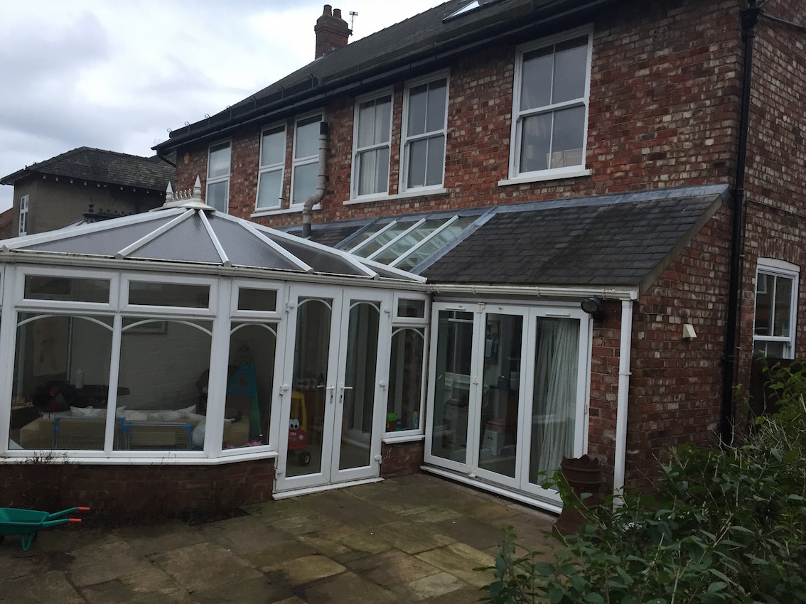

I had the planning officer out today to talk about my extension at the back of the house.
It sounds like it is 60% no and 40% yes. It is not a straight forward no. I am using a current original lean-to extension as part of the new one and loosing a conservatory and free standing garage.

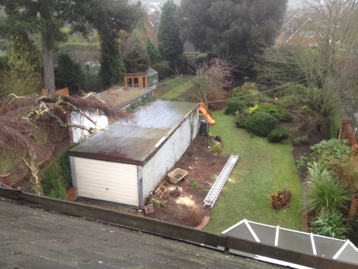

I intend on building a new garage at the side of the house and infill between this and the conservatory with all new extension (so conservatory will go as well).
So i am not actually adding a huge amount of new space, but because it is being organised as one block on the back of the house this mass is probably going to be too big.
It will be the full width of the house, plus 3m out to the side where the new garage will sit. The depth of the extension will be 5.5m from the back of the current lean-to extension, or 7.1m from the back of the actual house.

She was a bit vague. She was surprised the tiled/glass lean-to wasn't coming down as she thought this was happening. This changes things a bit i think. I really think she needs some help with this one.
She didn't suggest anything as i asked her about this. I could do my extension on the back to cover the conservatory area and outside the sliding door into the kitchen. All under permitted Dev rights i think. Then i could probably build a separate garage next to this new extension, but it would have to be separate and free standing. I would loose 300mm of garage space and it would look odd. The garage would need the PP though and may not pass.
I asked about lowering the final roof line on the garden side. It is supposed to finish at 3m, but i could get it down to 2.6m. So the pitch would be a touch steeper and less impactful for the neighbour on the left side of the plot (current garage side). She said this wouldn't make any real difference as this isn't the issue.
My house is 100 years old and i think they are looking to try and keep things in a certain style. A big extension on the back just doesn't look right somehow in their eyes.

She noted a lot of examples in my location of extensions (big ones). My neighbour has a monster garage and conservatory next door. Next door but 2 there is a long extension on a much smaller house than mine. She commented on these two things. My house is a 4 bed semi and i would get my extension under permitted dev rights i think, minus the garage.
It is the garage which is causing problems. It is stuck in the garden and prevents us from really enjoying this space. This is why i initially thought about moving the garage up to the house and use the dead space which is patio. But if you use this space for a garage, and then fill in the full length of my house i get an new garden room and utility and the conservatory disappears.
The issue seems to be this is a big mass of building stuck on the back of my house and so it isn't wanted in the planners eyes. Thats what i understood from speaking to her. Individual units of garage, garden room would be ok, but not all set together.

PLUS i will build a new storage shed at the bottom of my garden. I want this to be 9m in width by 4m in depth. I think this is also ok. This way i can then get rid of my horrible sectional garage which will be right next to the new extension. This will then become patio and garden.
