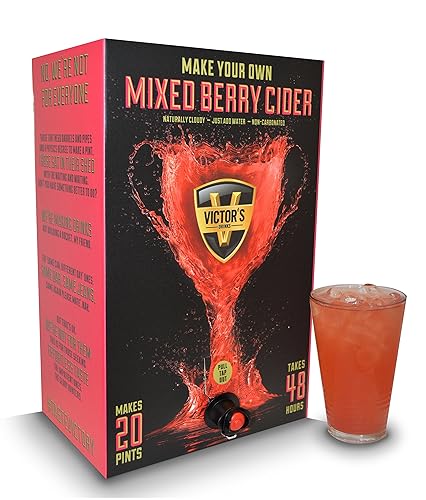

I told my wife this and she returned home with a £15 kit to make 20 pints of cider in 48 hours. It comes with it's own container, simply add water and drink 48 hours latter. Is it really worth juicing all those apples, storing demijohns and bottles and making what in my case was a very dry cider when it comes ready to drink in 48 hours?
OK twice the cost of kit beer, but 10 times faster to make, no need to bottle comes in ready to serve container with tap already in it. However I prefer taste of beer so freezer will still be used. And at the moment it is making some Orange Brandy Liquor claims to be 40% proof so expect that is US proof so around 20% ABV. At £10 for the kit plus sugar for 6 bottles of 20% ABV liquor that seems well worth the effort.

Well the kit
has been made, first 48 hours in a controlled environment at 19.5°C waited three days before trying, it was a nice sparking drink, rather cloudy with a s.g. of 1.020 which is rather high pointing to fermentation is not really complete, put some in bottle to take to daughter, and squeezed the bottle first only half full and when got there is was turgid with pressure. Just re-tested the s.g. and down to 1.002 however hydrometer sticking to test jar side so could be out a little, however a massive drop to the first test, and cider drier as one would expect. In both cases still a nice drink, but very different in taste, I would say at least 5 days are required not 48 hours. The cider has remained cloudy but it claims it is a cloudy cider anyway.
