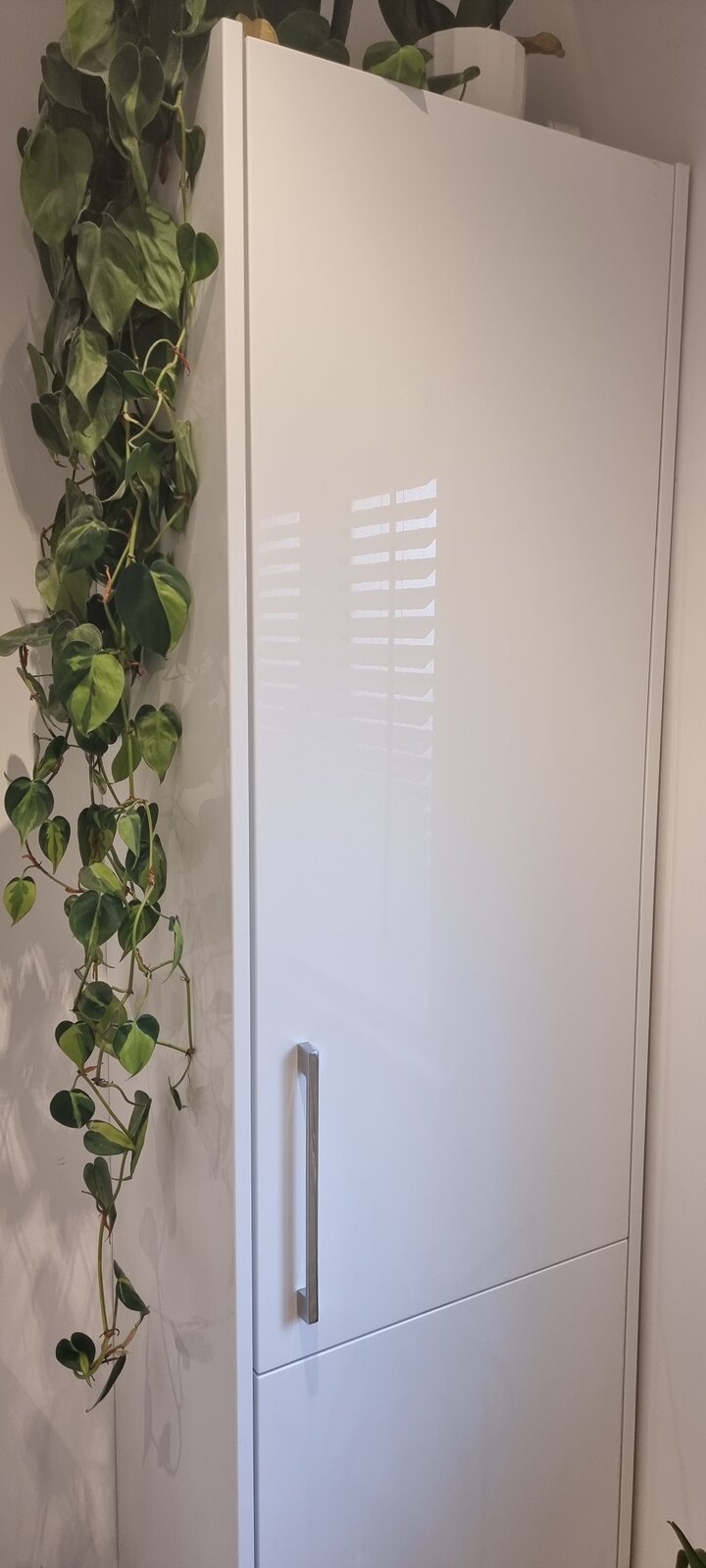

I have a Worcester Greenstar 30Si in a cupboard in the bathroom.
There's a warning sticker about keeping the cupboard door closed
Is this just a generic warning or does it need to stay in a cupboard for some esoteric reason?
Could I swap the cupboard for a louvre door affair? My only hesitation is it's not really enclosed with a louvre door.
I really don't think it's an issue but would rather check first.

Wifey doesn't like the "melamine monolith" and thinks a bamboo/pine style cupboard with louvre doors would "soften" it.
As long as your boiler is a room sealed (draws air in from flue, not surrounding space), it is unlikely to need ventilation for cooling or combustion unless Manu Instructions say so
Good idea, I'll check the manual. The room itself isn't well sealed (big gap under door) which aids the ventilation. However, the cupboard is well sealed.

The question isn't about cabinet ventilation - the OP is intending to add more, by fitting a louvered door! :)
@jacko555 , how far away is the door from the bath/shower?
And the big question do you want to change the door or not?
I'm sure we could come up with convincing arguments one way or the other! ;)
Nope only requirement is stated in the MIs minimum distances for servicing is all that is required , louvre door or welded steel wont make any difference
A boiler can only be installed within zone 3 of a bathroom, that means anywhere closer than 0.6m to the bath/shower or basin is considered a no no, unless it's within it's own enclosed space
