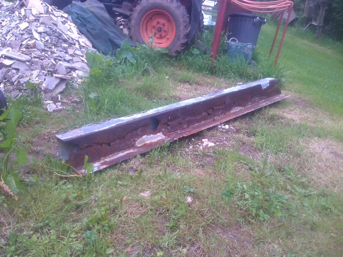

Over 700 ft altitude , southwest facing and blown rockwool cavity insulation which I have now sucked out.
No tray!!
litl
Having said that, the insulation was dry and I have 7 identical catnic lintels that have been laying directly on the soil for 30 odd years with not a spot of rust to be seen

Any weep holes?
Could I borrow that image, as I'd like to get some other thoughts on the failure. It must have been constantly damp, with possibly some freeze/thaw action to break the galvanising, but I would also expect there to be some sort of manufacturing defect with the coating too.
Any weep holes?
Yes that would be interesting, heres another angle

All you need to do is look at the manufacturers brochure for a lintel for a single skin wall - an "L" shape. The length is the window opening plus 300mm, or 200mm at a push.
IG lintels - L10 or L11
Catnic - ANG or CCS
Or if you want the internal timber removed, a cavity lintel for the width of the wall.
You dont need to have an engineer calculate anything, and I can't see what value they will add.
A cavity tray will be needed. Bonus points for any builder that mentions this.
You just tell the builder that you want a standard lintel fitted, no angle iron, no bars, no alternatives. Just a standard lintel for the outer leaf, or if you want, a lintel for a cavity wall.
