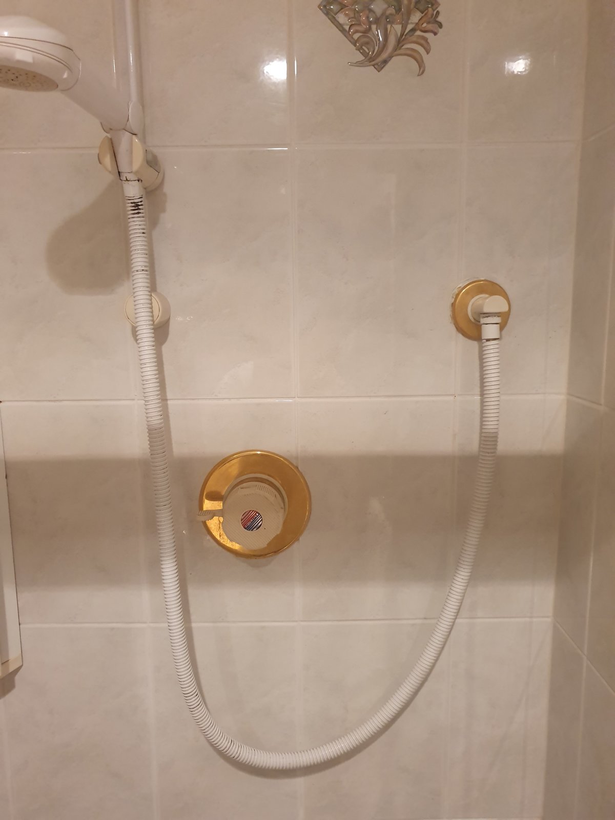

Hi moved into our new house 2 weeks ago. Ive just had a vented system put in. Everything is great now as i have mains pressure throughout the house.
Our ensuite shower room had a leak at some point. There is a old aqualisa shower in there ive sorted out the leak now. The cold water & pressure is great but when u turn the dial to hot no hot water is coming out its just cold. But the hot water pipe going into the unit is hot. Do u think it could be the something in side the unit it self gone wrong?? Sorry for the long message

you can get a replacement cartridge for these, which can be fitted from the front.
If it has been correctly installed you can get at the whole mixer by removing the trim ring.

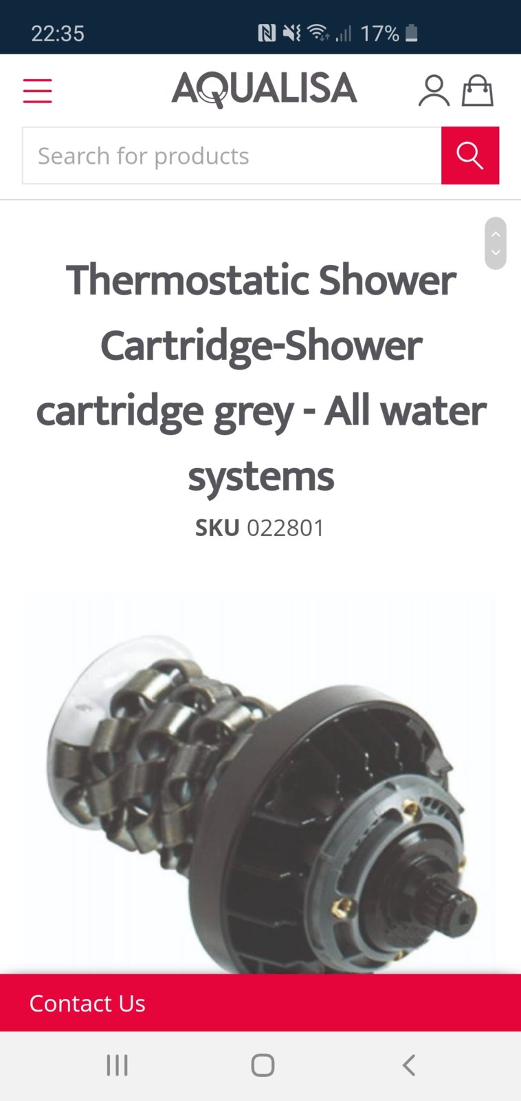

Can you see a model number or name? Most round-knob Aqualisa shower mixers are thermostatic, but there is at least one with a pressure-balancing cartridge. I don't recall if there is a manual mixer, their own design of thermostatic control was the big selling point that built the company's success. If you take out the cartridge it will have a colour identifier, a coloured plastic ring on the front. But the one you take out may not necessarily be correct.

You may be able to identify your model on
https://www.aqualisa.co.uk/parts-accessories.html
I've seen that knob type before.
