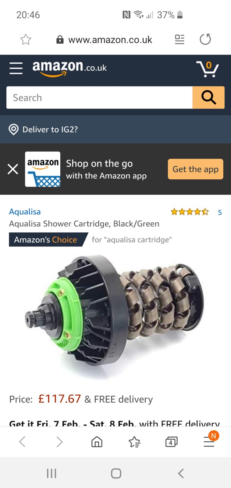

I think it's green ring for an Unvented.
You had better identify the model number of yours because I think older mixers do not fit the same cartridge.
Their Parts dept seem quite helpful, though.
There £125. It might be just as easy to put a new shower in ‍♂️

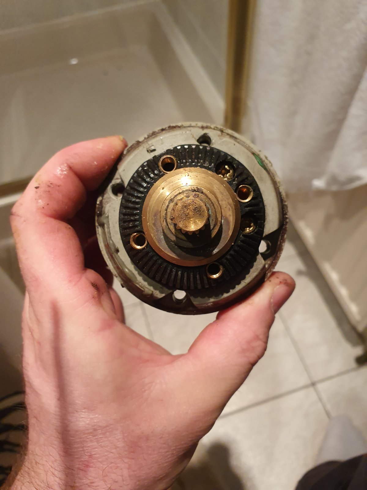

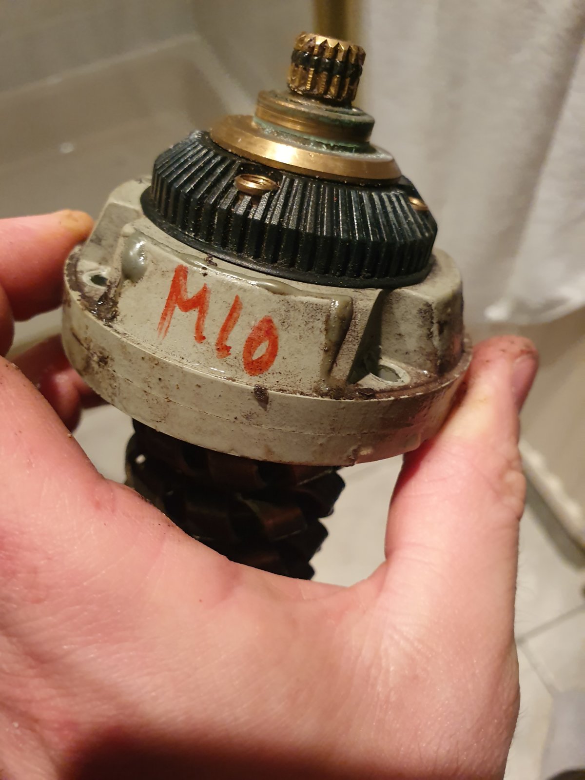

Cartridge removed dont look good to see what u guys think?
Well it's thermostatic, black ring, and looks clogged with rusty scale. Are you in a hard water area? I don't know where so much rust came from.
If you have a pack of kettle descaler you could soak it overnight but really you need new.
I'll look on my shelf tomorrow.
But now i have a unvetted system will i need the green one? Because before it was a gravity feed system.
see note below
glad you got it sorted.
Hi johnd thanks so much for taking the photos & explaining everything. I took your advice & went & got a cartridge today. Took me about 10mins to put in. & bingo fully working shower. Cant thank you again & the other people who contributed
