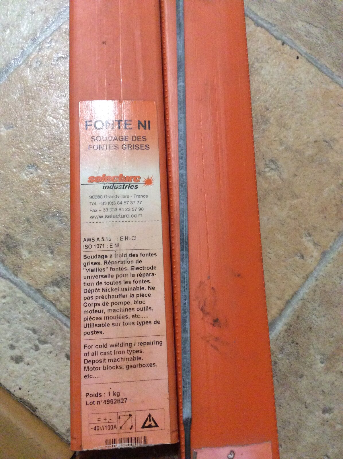

Trouble is - the original item is cast iron, but it looks as if he it patching with steel, as are the rods - so he needs to know which part he is grinding.
I am sure, that the sparks are orange, but not really sure as I have the welder mask on most of the time, and I can hardly see anything, even when full arc
so, I brought a lot of sticks, I believe they are different due to the numbering on the sticks, so what stick should I use for cost iron?

Cast rods are usually black and expensive, I keep mine under the wood burner

I am going to order some cast rods though

Ideally cast iron should be preheated, this helps reduce cracking.
Brazing as posted by Justin, would be an easier option.

I have loads of different rod types bronze, aluminium, steel, stainless steel but no cast iron… I have ordered some and should be here tomorrow, so should be good to repair. Okay… reading this back to myself I am unsure if it’s bronze or brass now…
