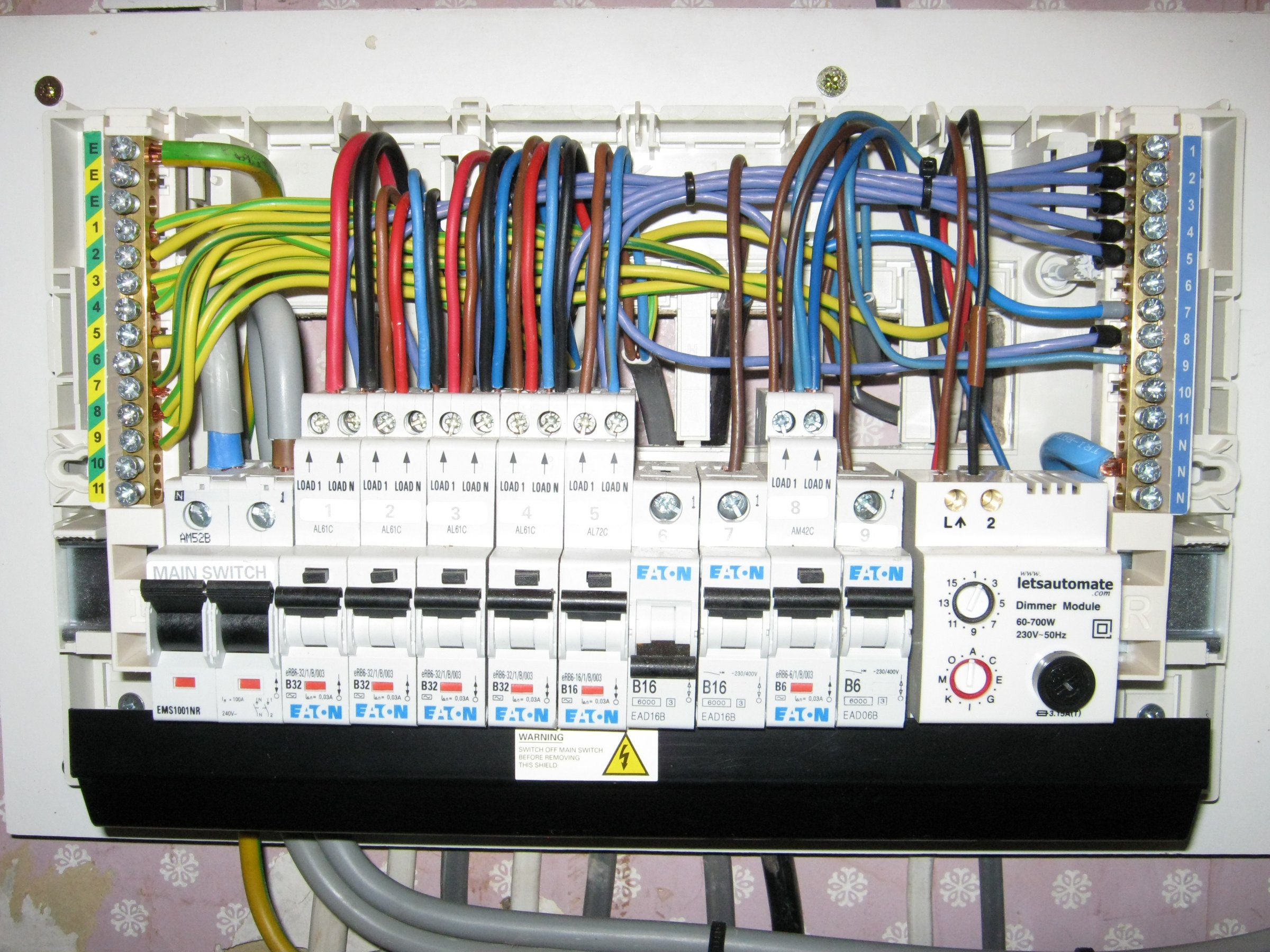

Could an older consumer unit that has an inputter switch and MCBs have the MCBs replaced with RCBOs? Or do the RCBOs need a special consumer unit?
Also am I right that not all brands of MCB can be mixed with other brands due to the position of the live bar that distributes the live?
You should not mix MCBs or RCBOs that are not type tested by the manufacturer for the board, regardless of busbar suitability!
Not all boards will take RCBOs, what type of board and what code of MCBs are present?
A few pictures would be very helpful!
It is best to create the consumer unit with compatible items from the same manufacturer. That help with retaining type approval of the consumer unit.
RCBOs are almost twice the height of MCBs and have four connections at the top thus considerable more space is need for wiring an RCBO than is needed for wiring an MCB.
The four connections are Live to circuit, Neutral to circuit, Neutral feed from bus bar and functional Earth.
Yes you are right, different makes of MCB do have different positions for the live bus bar. Some are compatible but not all.
It also varies between different RCBOs. On my Eaton units, there is one connection at the bottom - the live busbar input, and three at the top: the incoming Neutral on a flying lead which connects to the CU Neutral terminal block, L and N to the load on terminals. There is no functional earth. From looking at other makes I think this is probably the most common configuration.
This shows the size difference between MCB and RCBO quite well:
If you are thinking of replacing your MCBs with RCBOs you'd be better off replacing the whole CU rather than keeping what is essentially just an old plastic box. It will probalby be cheaper overall.
