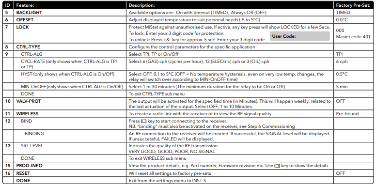

I actually looked into this for myself a few months ago. I only found one model these days on sale in the UK, with that level of adjustable hysteresis, and even that is a discontinued model. It's the Drayton MiStat (N) and it still seems to be available from Screwfix and City Plumbing. It is expensive, though, and some reviews suggest it sometimes doesn't last very long before breaking. Also, it seems to be wireless. The only other model I found was an Italian brand called Seitron, which you could get through EBay. I can find the model if you want. And @Johntheo5 had another Italian brand with adjustable differential.
I am only working from the manuals, though! It is possible that other thermostats might do be able to do this, but the info is not in the manual. I think that's unlikely, but I just thought I should say. The replacement for the MiStat is the Digistat range, and I couldn't find anywhere in the manual to adjust the differential. But it might be worth contacting Drayton to make sure.
The thing with hysteresis is that, because of overshoot, it always gives more hysteresis than you set it to. If you set it to +/- 1.0C, you might end up with +/- 1.5C or more in practice. Also, it depends where it is located. If you place it in the hall +/- 1.0C might mean the living room is effectively +/- 2.0C. EPH for example make a thermostat with a smaller adjustable hysteresis.
This is the parameter table for the MiStat. Parameter 9 is where you choose the method of temperature control and the amount of hysteresis. Full manual below.
