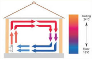

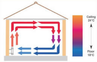

I also have an oil boiler, so simple on/off, and I also had a problem with over shoot, caused more by thermostat location than any fault with the thermostat, located in my hall around centre of the house, and hall radiator is other end of hall near to the door.
So we see these pictures, but that simply does not work in my hall, and the thermostat is located where the builder decided to put the wires for it, no real option to move it.
So attempt one was to raise the temperature in stages, rather than move from 17ºC to 20ºC in the morning, it went 17.5ºC for an hour, then 18ºC for an hour and so on until reached 20ºC so the boiler runs once an hour, so all the TRV heads have a better chance to control each room, it did help, and Nest Gen 3 will allow it to be set that way, however clearly if in the morning the house had not cooled to 17ºC then clearly the heating did not come on.

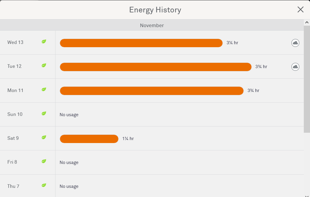

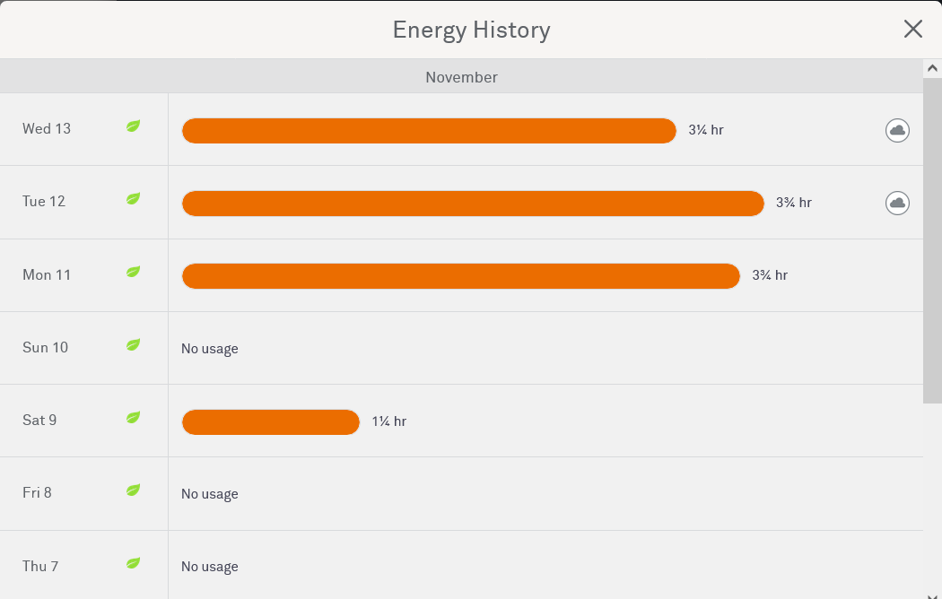

It came with a stand so could go anywhere, like on a table, so we tried it in multiple places, but cat sleeping on it caused heating to switch off, so decided it does need to be wall mounted. Now with two thermostats it is a lot better, I thought the Nest Gen 3 would only actually work the domestic hot water (DHW) but sun in the living room windows has some times resulted in living room being warm, but rest of house cool, so the old Nest Gen 3 does still some times turn on the boiler.

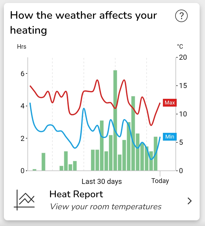

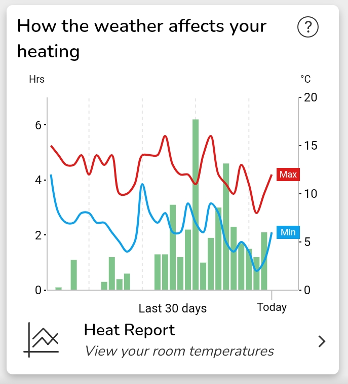

The history with the Nest shows it still brings on the heating, when living room warm from the sun, Wiser also produces a chart, as to what it tells me not so sure, I assume the bar graph shows when it fired up the boiler, however it works, and I can expand if I want latter. Had I gone for Wiser first, likely would not have needed the Nest, but I have used the CH only version of Wiser, it does not run my DHW, and it is unlikely it could run my DHW without a lot of messing around with relays etc.

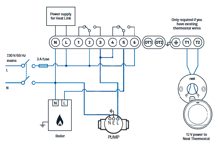

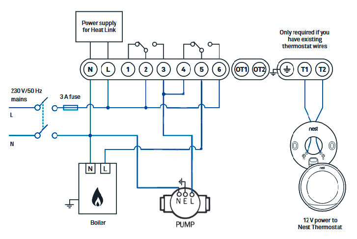

Nest Gen 3 do not publish how to set up C Plan, this is how Nest Gen 3 can work with C plan, will not work with wiser as no access to the Com terminal.
