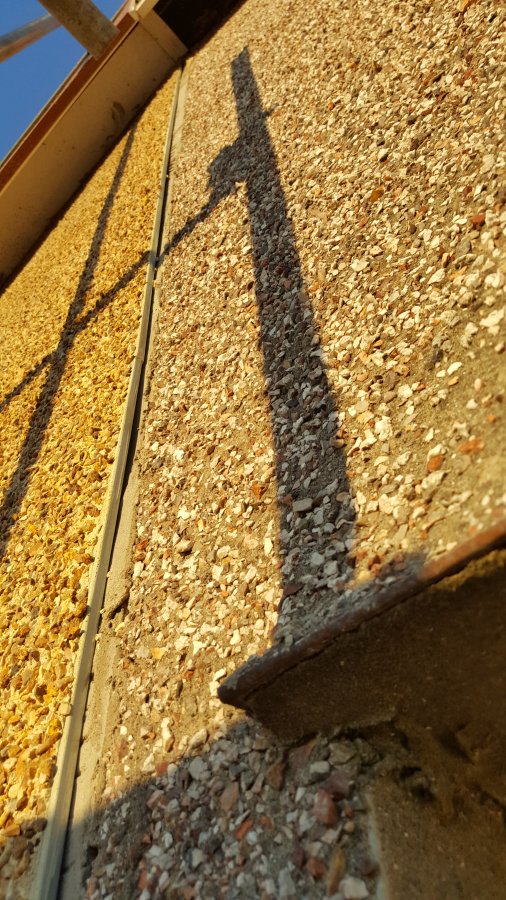

£3000 is what he told me. And for that he has no scaffolding, he is doing some of the removal of the render himself, no dowel for cutting a straight line, and no beading where he has cut the slot as the line is not straight. My wife who watched the whole thing said builder had ladder on the extention and just cut a line down.
If he does not patch the bit of render by my sill, and that little bit is now loose what do I use to patch It. My window opens inwards fully so it's easy to reach through that window. There seems to be some leading underneath the render in that part which is part of my extension with the loose little square of render on top. The render above is solid and not blown

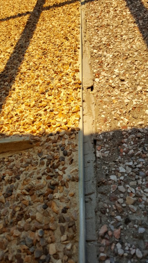

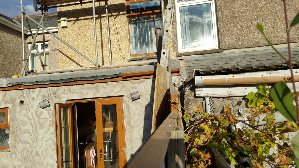

Is this normal. Yesterday they put the scratch coat on after cutting a crap line down the house. Today they use a metal bead but have left a few inches next to it on my side bare. 20161005_175648.jpg
Facebooked the builder to ask what was happening and he has said he is coming back to sort my side out. He at least admitted he did not cut a straight line.
It looks like a galvanised metal stop bead when it should be SS - or my suggestion would be a Render Plus Pvc expansion bead with a 50mm fin on either side of the upstand.
The galv bead will rust and expand and blow the render and dash.

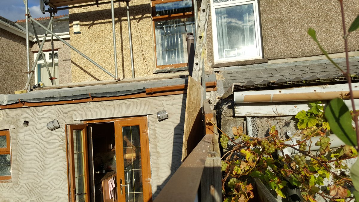

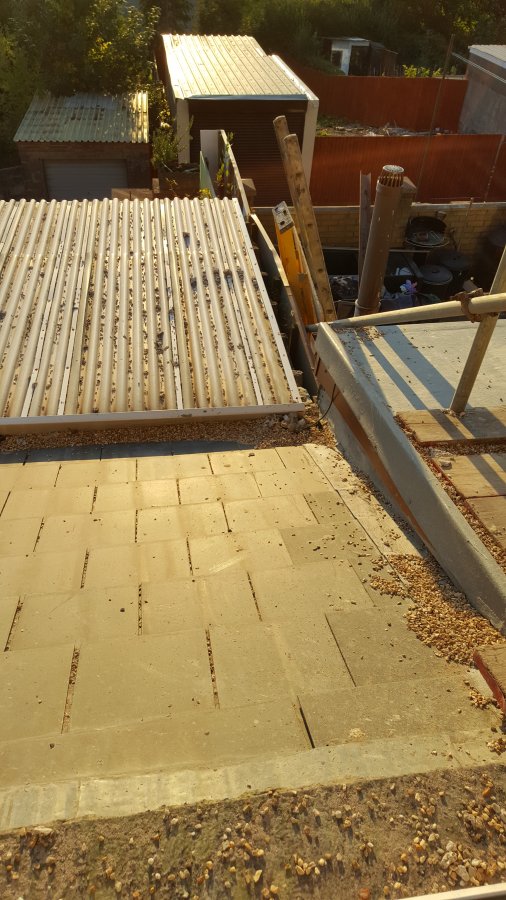

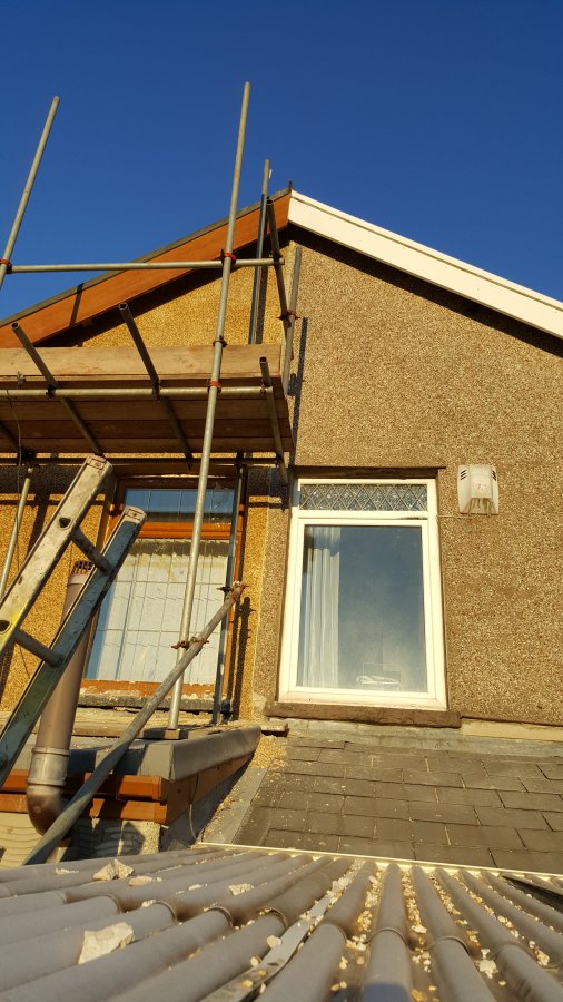

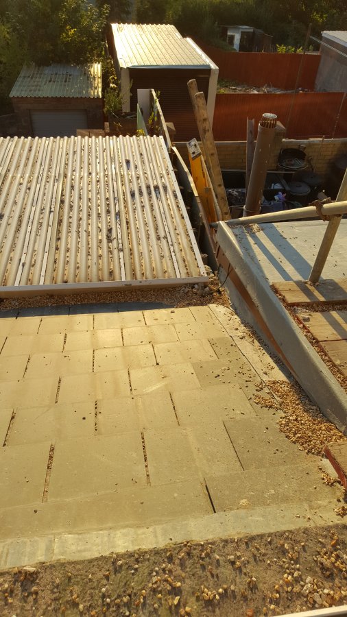

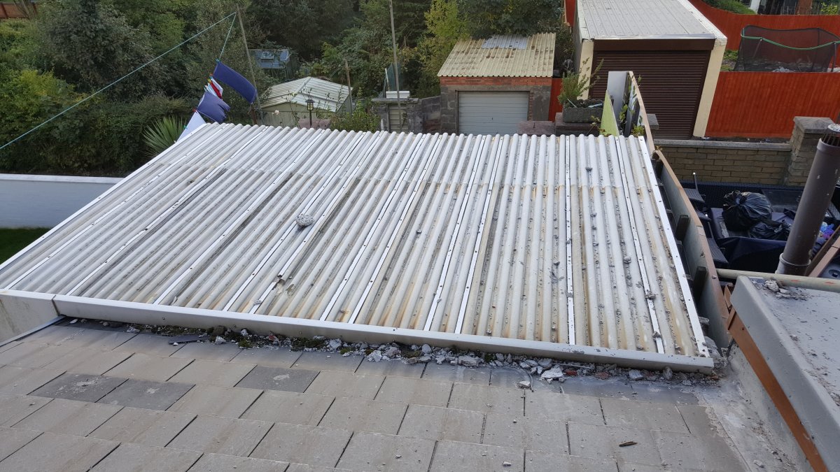

The corrugated roof was clean in early photos but now has debris on it likewise your slate roof - simple precautions could have prevented that. Is your gutter free?
Everyone to their own method but no way would I have erected that scaffold for that job - what next, a forklift?

Bluntly I do not like what i have seen on your digital images, I copied and pasted then Zoomed in [anyone following suggest you try this?]
There are gaps in the [what I assume is] Mortar, a really perfect way for rain water in a few days / weeks / months to invade your property?? -- What no good quality Mastic?? -- and no space for it to actually fill the space and do its job?
By all means get the Builder back, but it is very important to now get the neighbour seriously involved, the Potential ! for on-going serious damp problems in your property is very high ! it is in my opinion you now need to place your neighbour on notice that the work undertaken has placed your property at risk of future damage by rain penetration !
I would be sending your neighbour e mails and recorded delivery letters stating that the work undertaken by his builder WILL seriously compromise the water-tightness of your home.
Don't mention my roof. Here it is

If that bead is a stop bead then it will only have the one fin - the fin which you can see has been placed on your side of the line which means its your render that has been disturbed not the neighbour's.
Dropping a chalk line would have given a plumb line for the centre line cut - the stop bead upstand should then back on to your render at the chalk line cut. This would place the fin on the neighbour's property where it should be.
To apply the dash you need "wet" render - how do they propose to make good the dash on your side if the render that the builder has applied is dry?

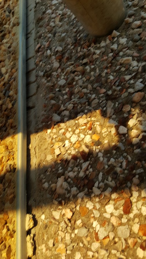

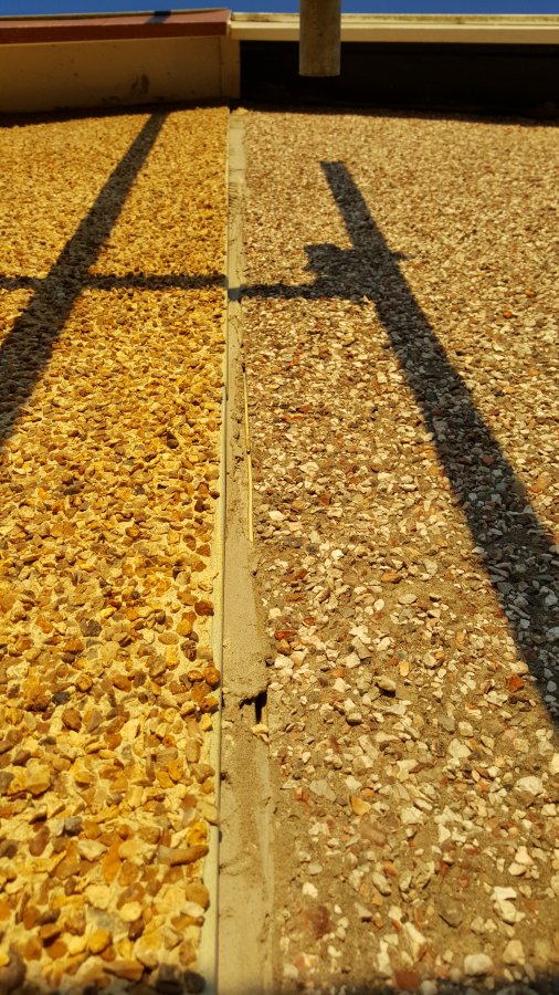

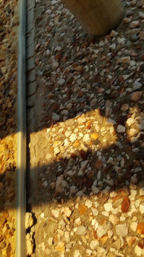

Here's a close up of the beading
It appears to be a typical galvanised one fin stop bead - there does, however, seem to be room for more wet render now I've seen the new detailed photos.

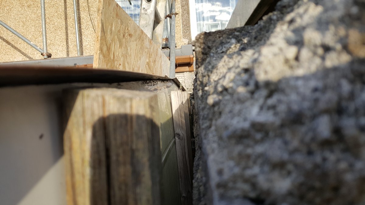

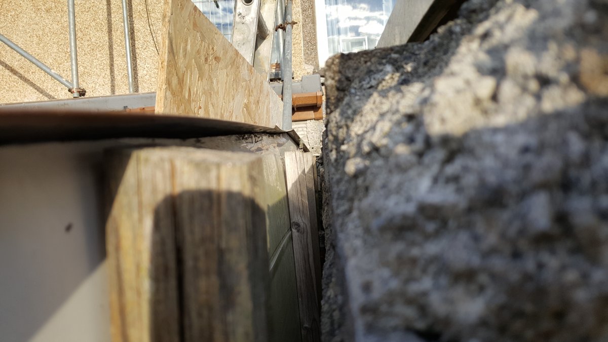

I never noticed before but it's definitely over hanging

Another image showing his roof just under my sill
