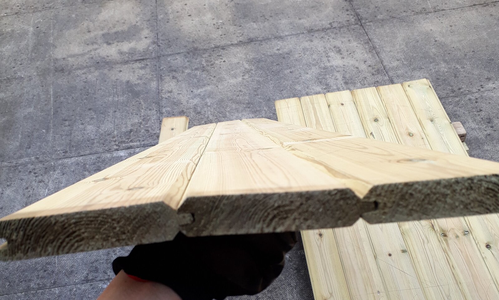

On a tongue and groove ledge and brace garden gate , does it matter which side the orientation of the growth ring on the tongue and groove boards face?
Should the heartwood of the boards face the outside of the gate or inside or does it not matter?
My understanding is the outside of the board can expand and shrink at a different rate to the inside, leading to cupping. So if the heartwood is facing the outside of the gate the screws/fixings clamp the boards to the batten keeping it as straight as possible.
By the way both sides of the gate in my case are going to be exposed to the elements.
Any advise appreciated.

that only looks like 7.5-8mm cladding you want the next size up at around 11mm
and you cant alternate as the groove is uneven and as said a "V" to the front
just select the best planks

sorry those arnt the correct boards in the pic - they were just to illustrate the growth rings. The boards I have are 20mm thick and have 'V' on both sides. what I was trying to ask is does it matter which side the orientation of the growth ring on the boards should go i.e. does the heartwood go on the outside or inside face of the gate.
How about reversing alternate strips. Then if they cup in the usual way the edges are more likely to stay lined up?
OP. decorative T&G boards are machined with a chamfer at both sides on the outre face (the upper face on the photo you posted), That face goes outermost.

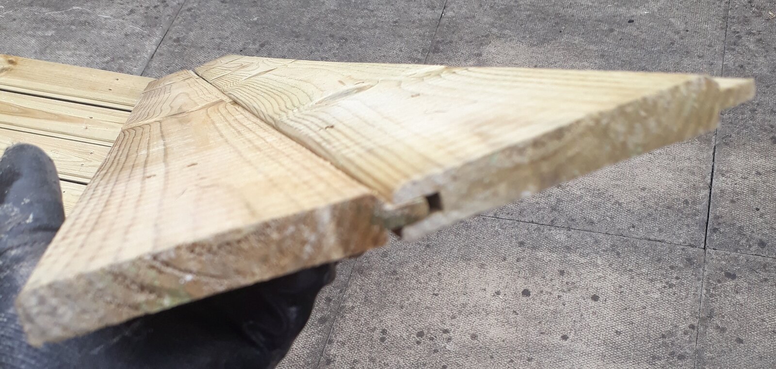

The boards I have have a chamfer on both sides. One side has a fractionally larger chamfer - see attache dpics. Does the large V go on the outside face and the braces fixed to the other side? If so then most of these boards will then have the heartwood (orientation of the growth rings) facing the inside and reading through the following link it discusses that the heartwood should be facing the outside face. https://www.secrets-of-shed-building.com/building_a_shed_door.html
Or maybe I'm just overthinking everything.
How noticeable is the V when you alternate them?
I can see the difference in the first picture but it may no be so noticeable in real life so long as the face of each side is level.
I can't see anything wrong with putting the smaller groove to the outside if you really want the heartwood on that side.
Well, the stuff in the second photo is a bit different to the first photo you posted!
Personally, I do think you are over thinking it. I also think that you've got the wrong end of the stick about what "heartwood" actually is (see below), and your understanding hasn't been helped by referencing an American web site where the author takes waney edge boards (which are pretty much always sawn hardwood) and where he clearly doesn't understand what heartwood is either (he actually means growth rings - yes, I did skim the site, that's 10 minutes I'll never get back):

If you look at the top edge of the timber, it's the growth rings which are the important bit, and if you want to go that way you'll need to orient your boards as above to get all the boards to cup outwards equally. But here's the rub - at college I was taught two alternative methods; in the first all the boards are set-up to cup outwards (or upwards), in the other method you alternate the boards so one cups outwards, the next inwards, the next outwards and so forth. Take your pick because in reality, it doesn't really matter how you do it.

Many thanks for the explanation. So if you take the boards I've got which would be the outside side. Is the side that has the slightly larger V profile the outside with the growth rings facing toward the inside of the gate?
More than likely. Just don't depend on the guy who's been doing the machining to have been consistent
I'm I going to see huge cupping effect if it keep it that way - large V profile to the outside, or should I use the smaller V as the outside face as suggested by conny?
It is outdoors. And it's therefore likely to get wet. It's a gate, so it will get wet on both sides. So there may be cupping and rotting. That's why you should use treatred timber if at all possible (and seal the cut ends withj end seal - asl the yard) and also why you need to protect it with something once it's been installed. And yes, I think you worry a lot
It is treated timber and will be sealed once hung but which side should I use in your opinion as the outside side of the gate - the fractionally larger V profile side with growth ring facing toward the inside of the gate or flip it around and use the smaller V profile and keep the growth rings facing toward the outside?
