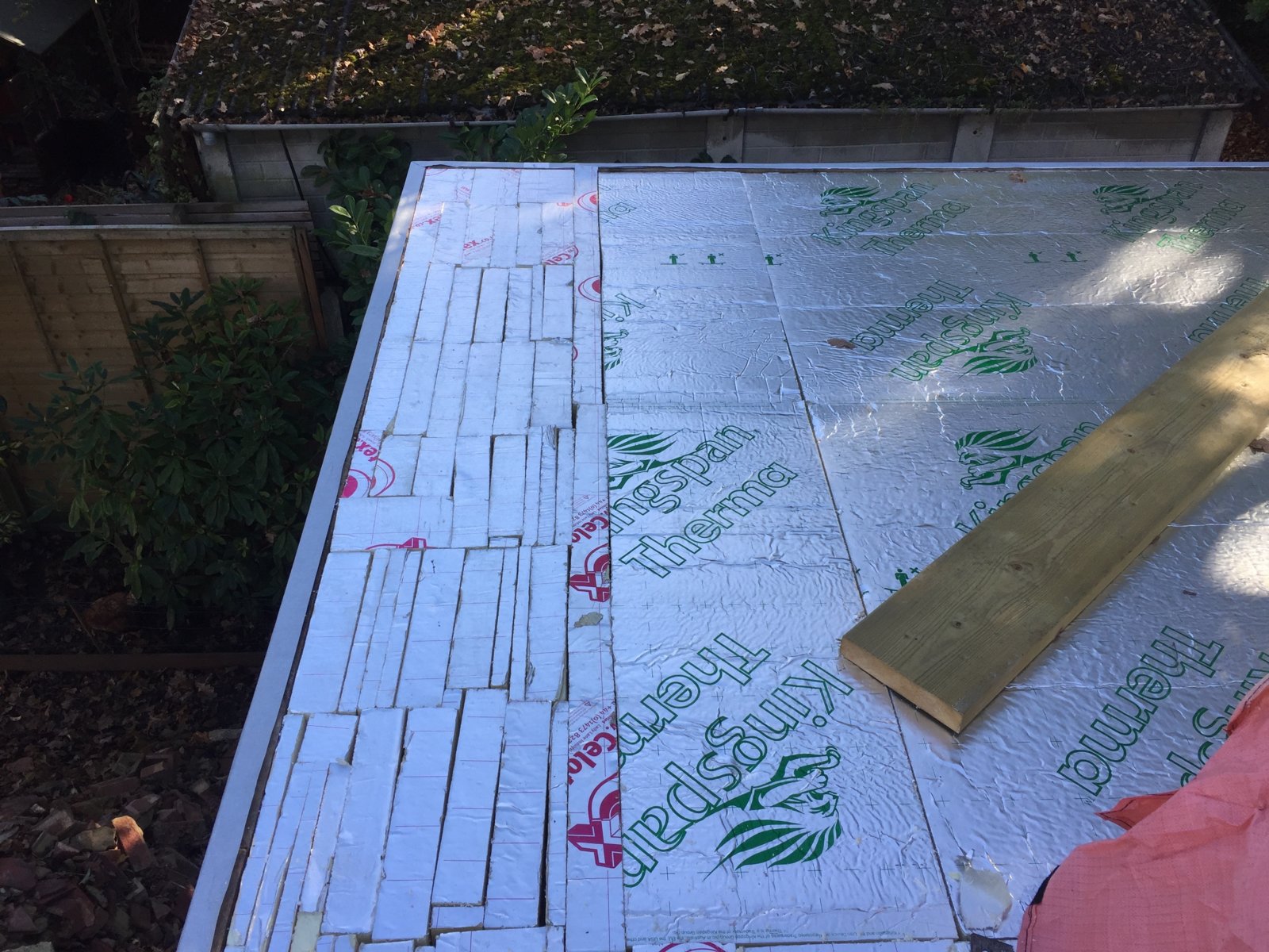

Okay, update time- the roof is now done!

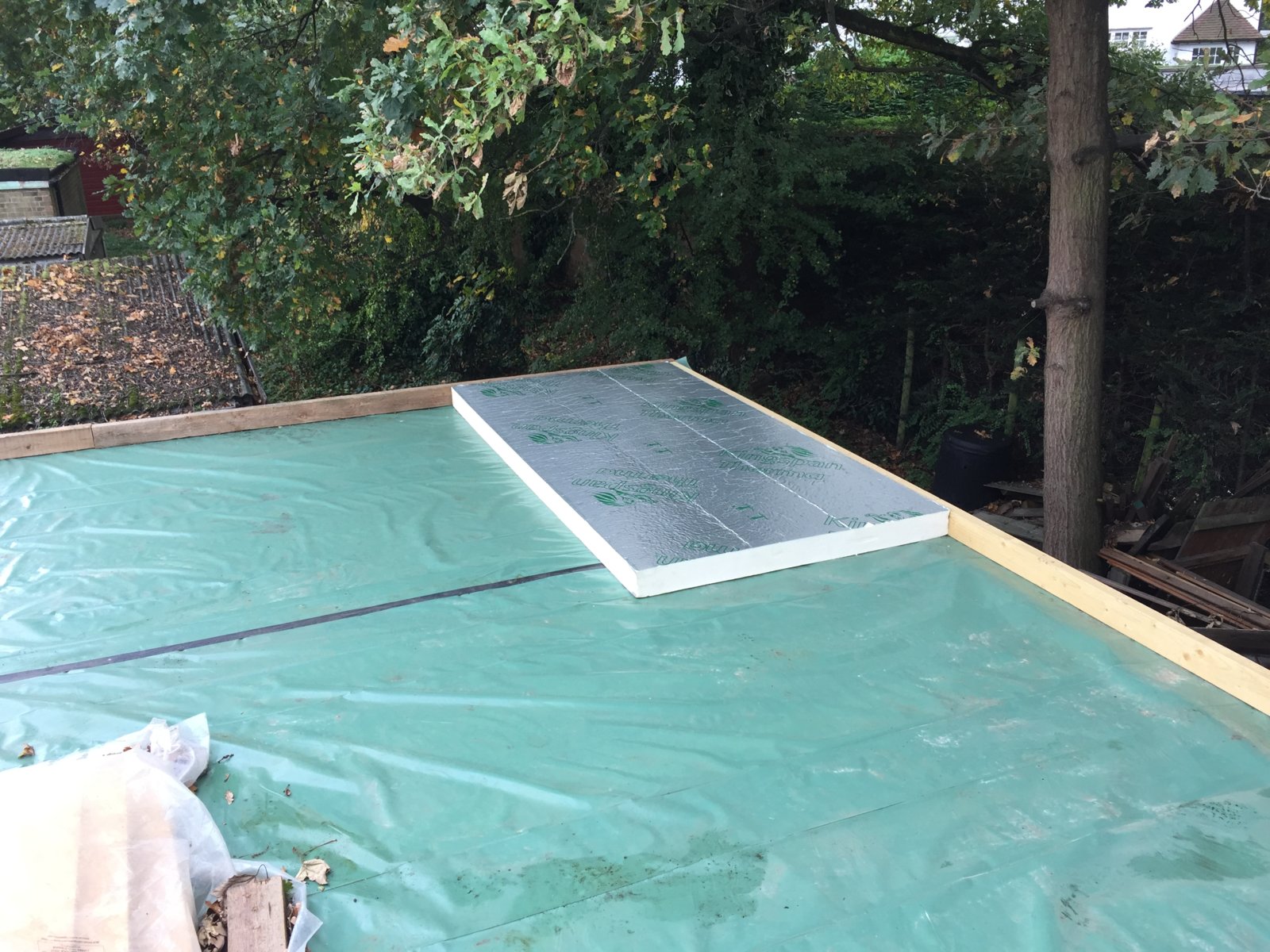

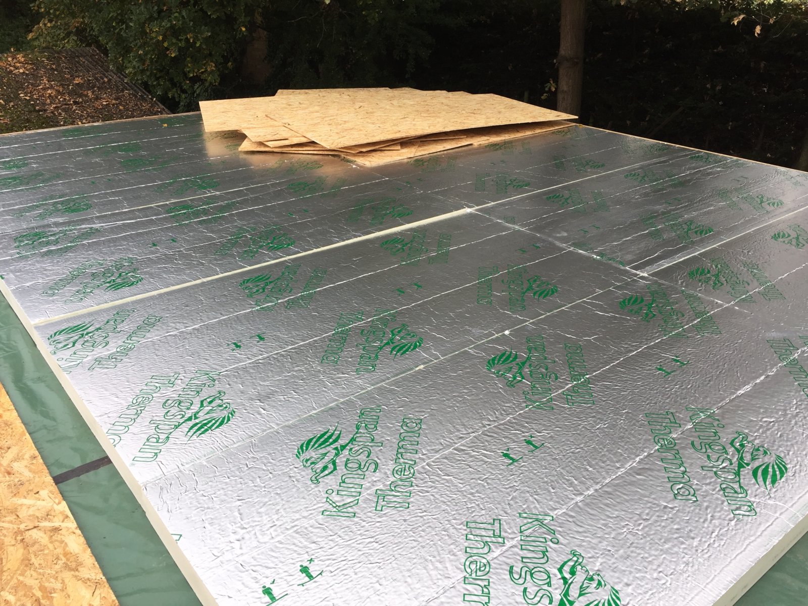

I attached 100mm timber to the periphery of the roof over the vapour barrier and then lay 100mm insulation:
Above the front roof overhang, where insulation isn't really needed other than to support the OSB that went on top, I made a very nice jigsaw of offcuts from my floor insulation to use it up:

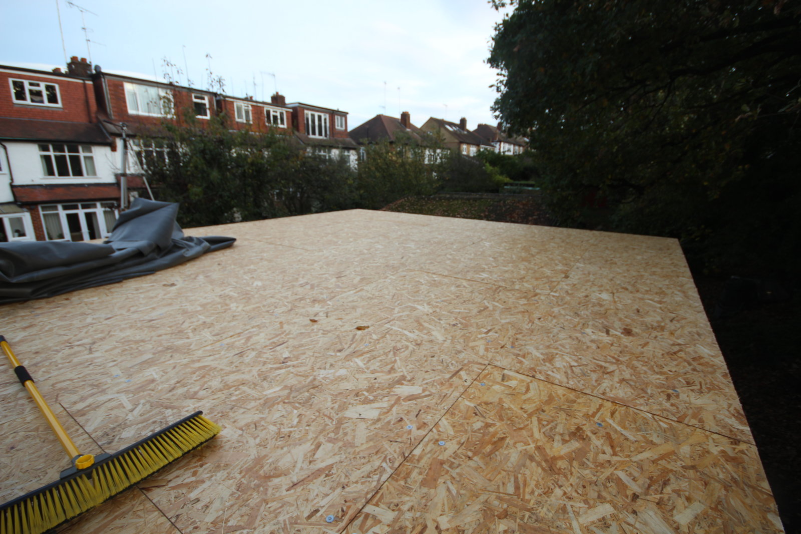

I then overboarded with 11mm OSB to make the top deck (very stable I can tell you) and for the used nails/screws to attach the outer boards to the periphery timbers at 6 inch intervals.:

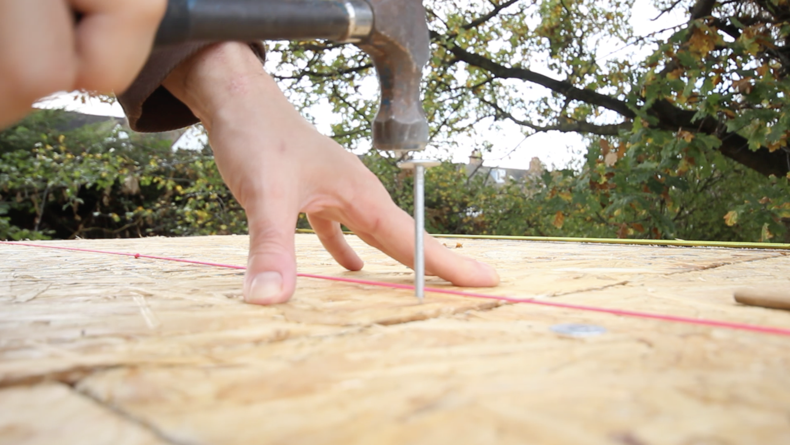

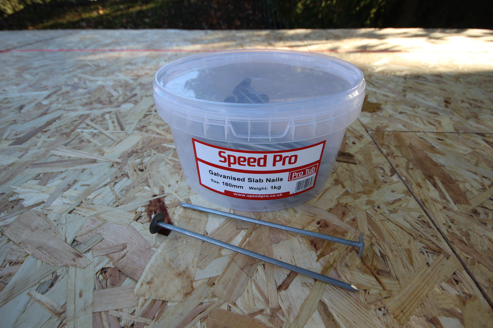

I used these nails to fix the centre areas through the top to the rafters below. 180mm long:
To find the rafters I used a pink string line from front to back over the OSB from where I could see the rafters underneath the overhangs. This was accurate about 75% of the time so I hammered them in to within a couple of cm and then check they weren't protruding underneath (i.e. missed the rafters). Ones that missed I could pull back out and reposition and the good ones I could just hammer home:
Here's the top deck finished with nails in:

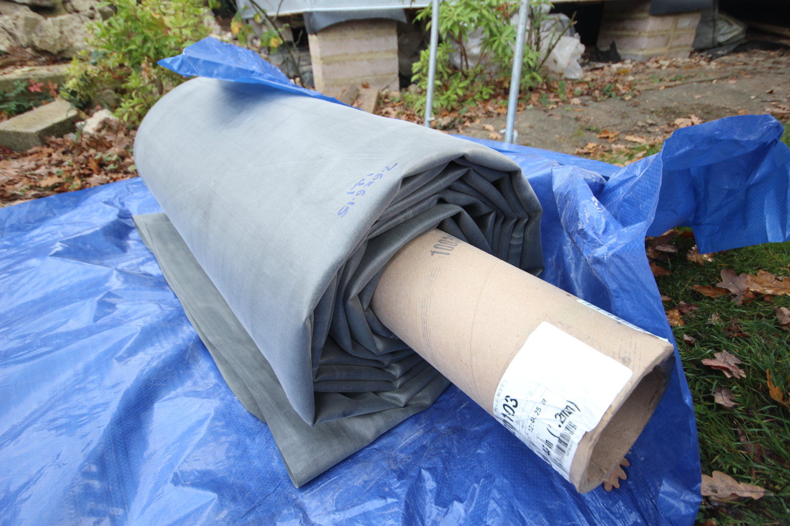

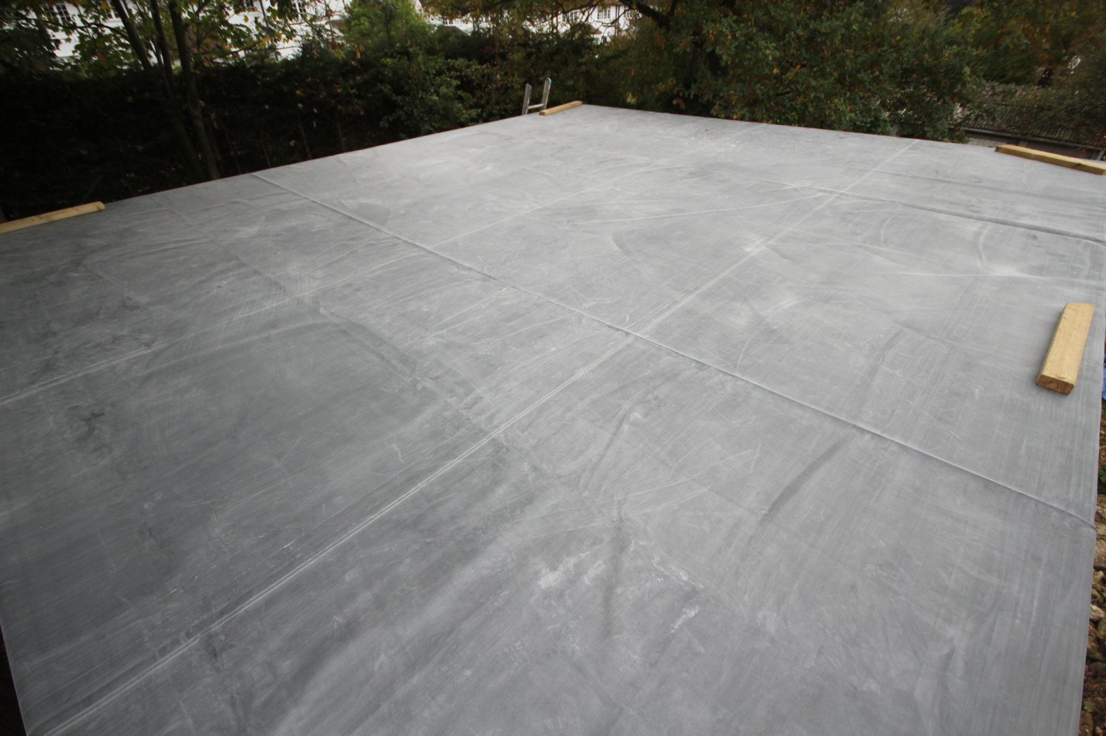

MY EPDM roof arrived which was so friggin heavy to get up I thought my fingers would fall off from gripping so hard. I unravelled at ground level and pulled one end up as I went up a ladder, then pulled it up a bit at a time:

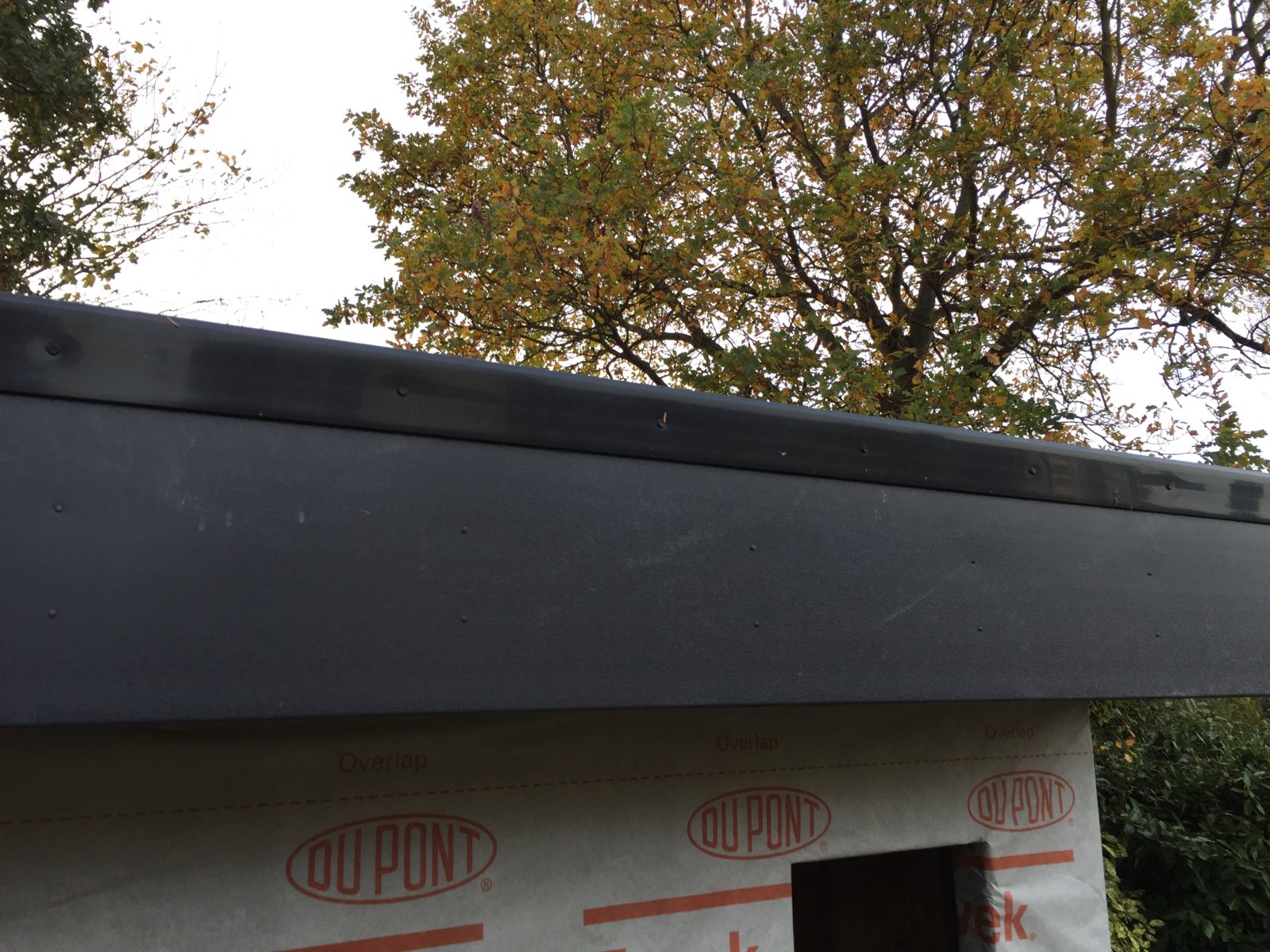

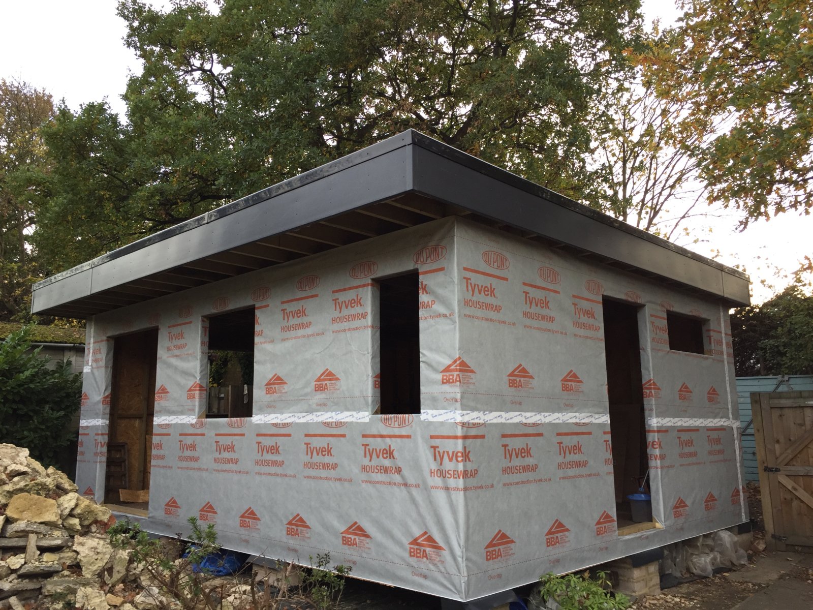

My anthracite grey UVPC fascia capping board arrived so I fixed them on. I left a 9mm gap at the bottom in order to fit soffit board into later on. To achieve this I used some 9mm ply pieces and attached to underside of the wooden fascia. I couldn't find UVPC capping board exactly the width I needed so I ended up using strips of 9mm ply to batten out the top so I would have a plumb face to attach my Sure Edge trims:
The back edge which will have a gutter was a bit different as it needs to come out away from the fascia. Here I used a 25x50mm treated batten and one half of the Sure Edge drip trim:
....The EPDM was spread out to relax this whole time to get rid of creases and to keep rain off the roof. I folded it back half way and rolled on water based adhesive to stick it down in stages, then did the other half. The 150mm around the edges are left clear of adhesive for a more permanent type of glue. This photo shows it relaxing, not stuck down but you get the picture:
Lastly I trimmed off the excess EPDM and attached the Sure Edge edge trims x3 sides and 2nd part of the drip trim to the fourth side. This covered the 9mm ply strips nicely:
The EPDM, adhesives and trims all came as a kit from Rubber4roofs-I'd highly recommend them. Loads of instruction videos. My EPDM is the 1.2mm Classicbond that has a 50year plus lifespan-how flat roofs have changed! Try 'SALE10' for 10% off.
Next task is to order windows and doors in the same anthracite grey grained style as the fascias and doors and get rid of this mess:

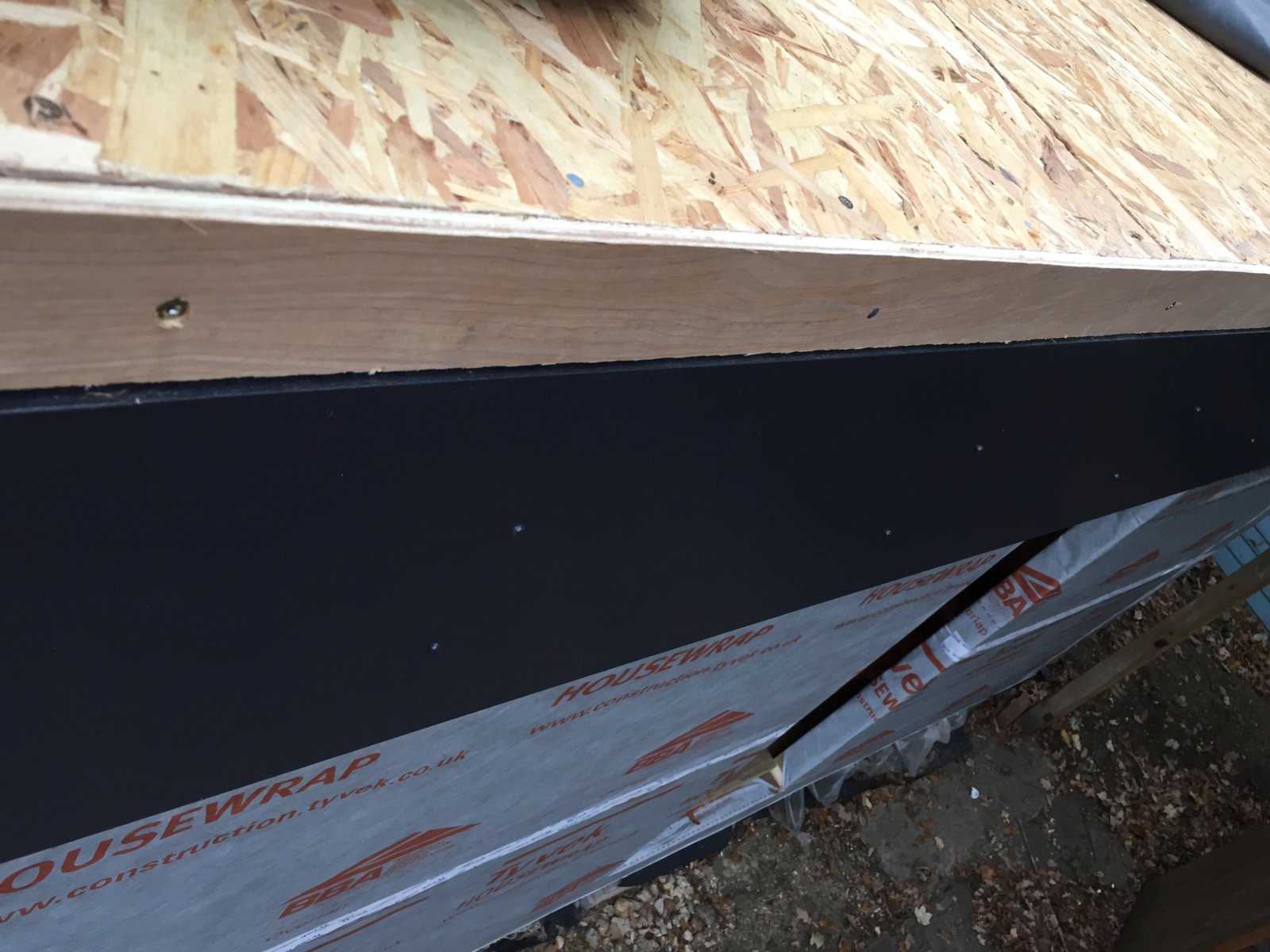

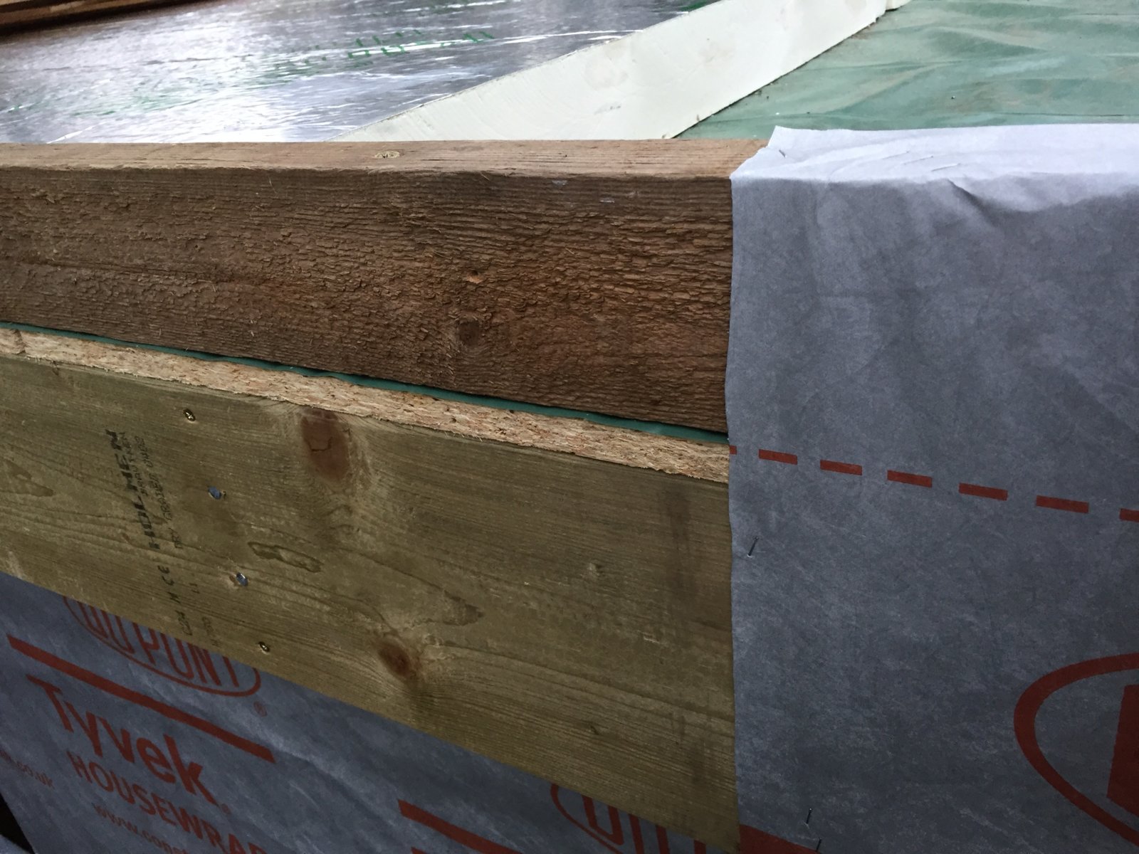

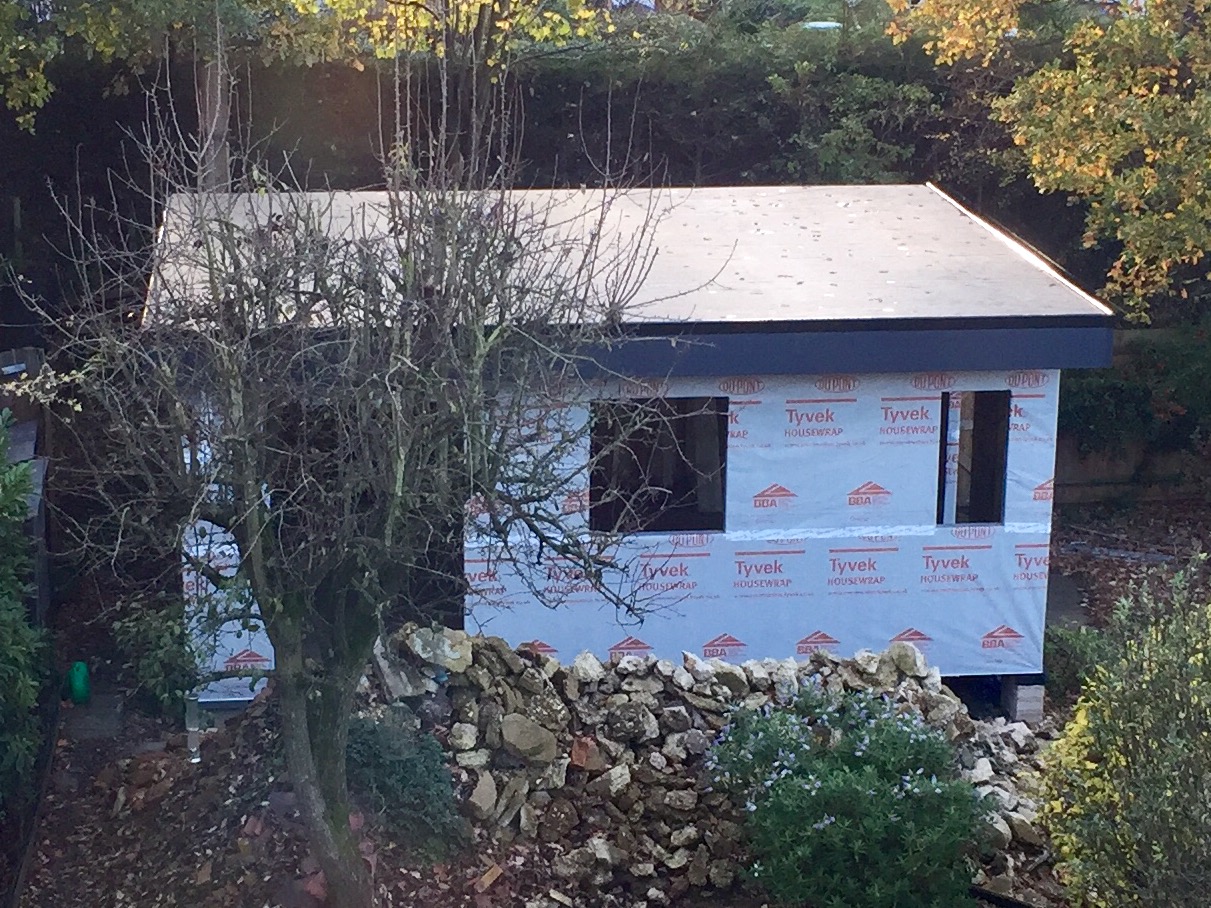

***Oh, before I attached the top deck of OSB, I added more Tyvek to the fascias for extra protection and because I had it. Here's a nice pic of the build up:

Hers one more pic:

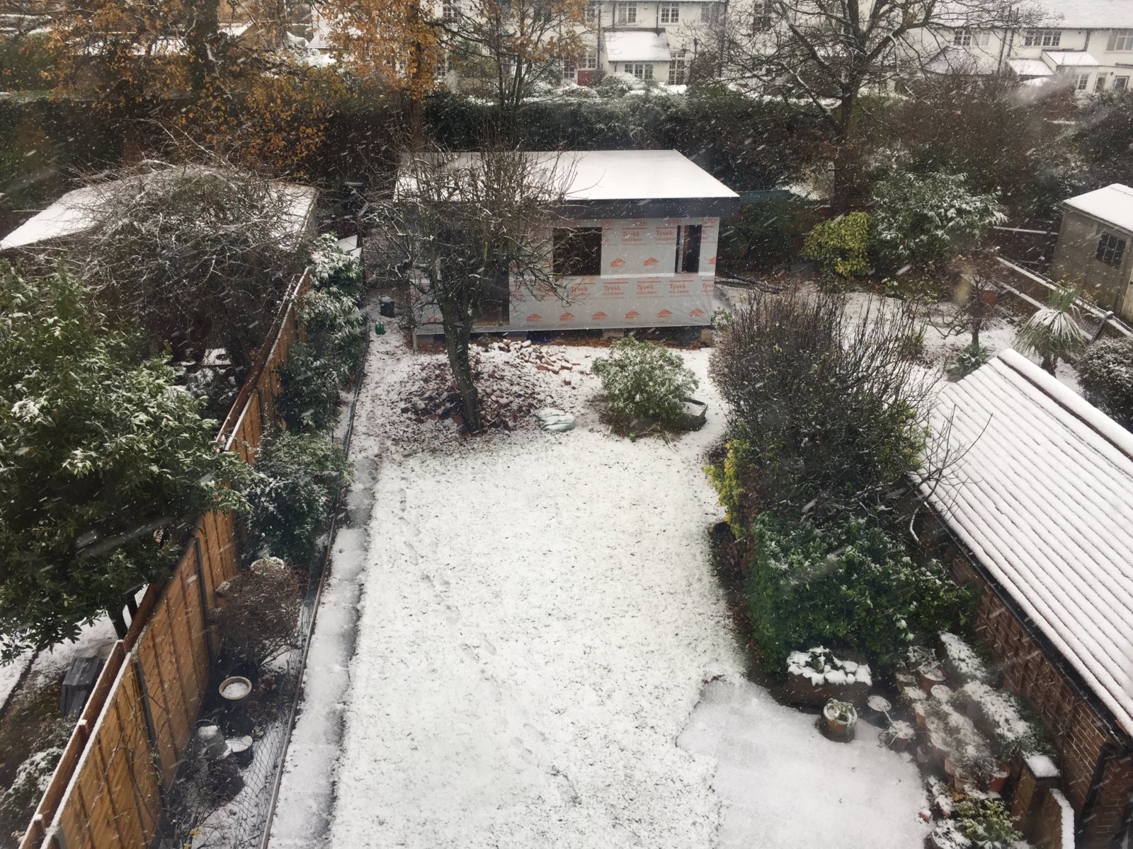

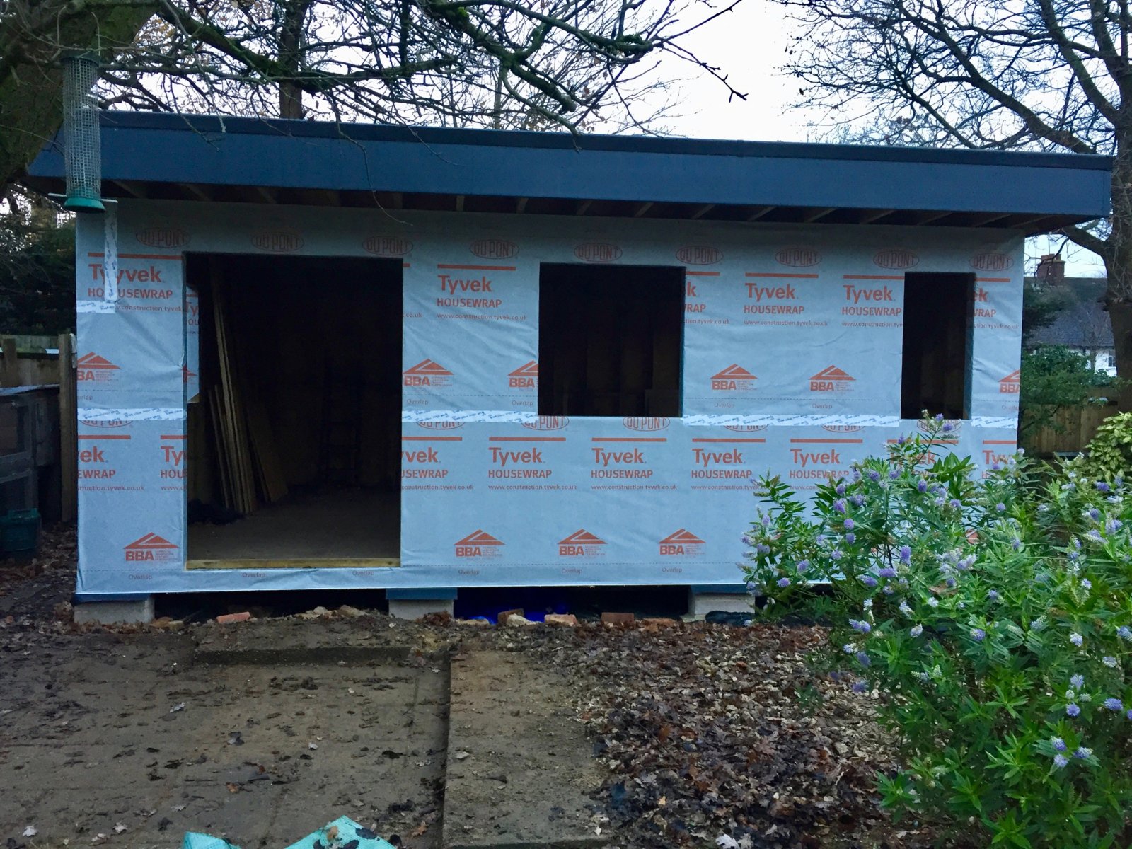

Quick Xmas update. last few weeks have involved me wheelbarrowing 3x 8-yard skips' worth of rubble from the previous garage and soil I excavated. A very good workout. Skips were £238 each where I am, so not cheap but saved by doing the hard work myself.
Here's a pic of the front now the rubble has gone and also one in the snow
Windows and doors coming in January. Hopefully get electrics from house done soon too.
