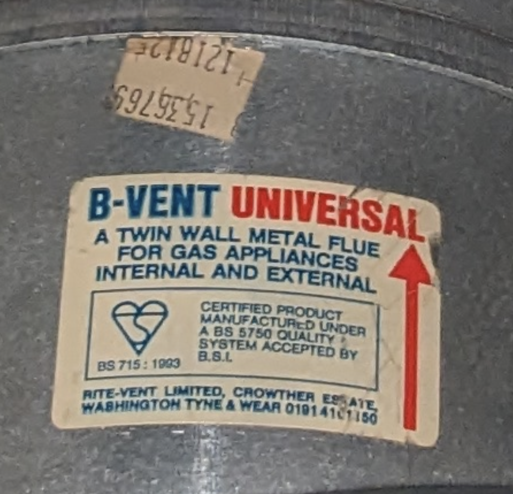

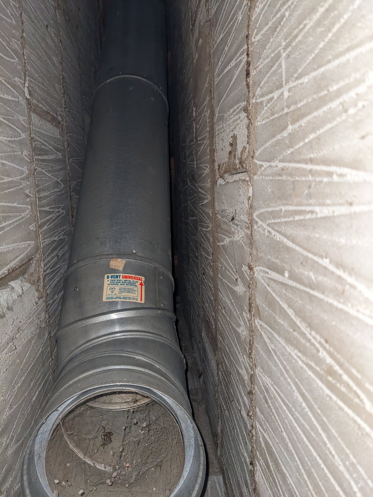

I removed the kitchen panel to have a look from the bottom up towards the first floor.
I don't think there ever was a air heater system, rather the flue seemed to serve an old gas fire only. This also makes sense as I cannot locate any old vents or plasterboard filling in old vents.
The flue also to me looked to newer to be dated late 70's when the house was built.
Assumption per photo the kite mark means the flue and heat tiles were put in (cut around) on or after the kite year 1993 when asbestos was well known and at least blue and brown was banned?

I'm a little less stressed now, knowing it was not a boiler flue and two the kite mark dated in a safer time zone closer the the outright ban ~1999.
