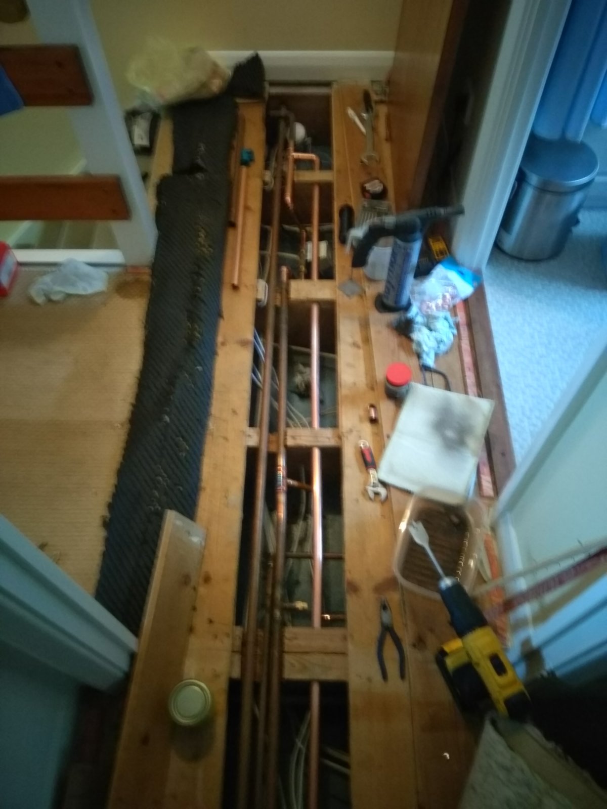

I made some good progress, ran (almost) a new hot water return right back to the boiler, and to go belt and braces I decided to put a 2 port valve on the heating return, so there is absolutely no way that it can backfeed through the heating system. I`ve re-piped the bathroom radiator to make room for the new pipework.
But, the pipes won`t solder. I`m using Yorkshire fittings, everything is spotlessly clean, fluxed etc, everything to the letter. I tried 2 joints, heated, and heated, and heated - nothing, just damaged copper
Don`t know what I`m doing wrong, but time to get my trusty gas/heating engineer in to bale me out - he`ll probably tell me where to go haha, and I don`t blame him

If you're new to soldering I'd suggest trying it out on short lengths of copper in the garage first. It's quite satisfying to see the bright silvery ring appearing at the end of fitting for the first time.
Any residual water creeping back along the pipework will b*gger things up - might be what's happened here.
I did exactly that yesterday, and it worked really well which is why I was confident that things would be ok. I couldn`t see any water lurking, if that`s the issue how is that overcome?
I`m tired of it today to be honest, those that do it for a living deserve a medal :)
Not sure what you mean by a 2 port valve, a Non Return Valve would be what you need. (Make sure it's the right way round! ;)) Edit, just seen it, I'd swap it out for a NRV and remove that dip in the pipework, that could be a recipe for further problems....
Only way to overcome the issue is to get the water out the pipework, if it's getting in at a certain point, then leave that disconnected, solder the rest and worst case scenario, use a compression fitting on the wet part.
Evening all :) I did admit defeat with this and contacted my friendly boiler engineer. Expecting him to tell me to do one, he was more than happy to come and have a look at my mess, and help out!
In 4 hours it was all sorted, refilled, and working again, and far, far better than it was before. I can also sleep easy knowing that nothing is leaking.
Thankyou all though for the help and advice, as I said, I`ve never soldered pipes before, so a lesson learned - start on a smaller project!
