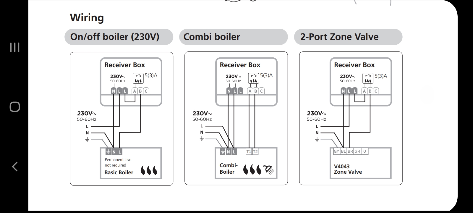

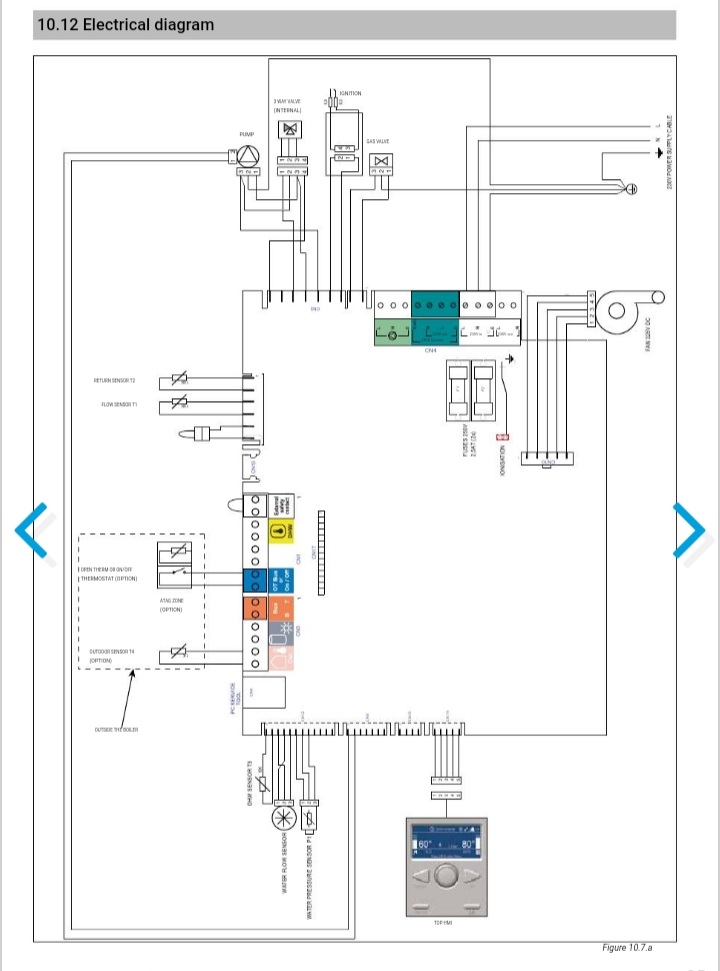

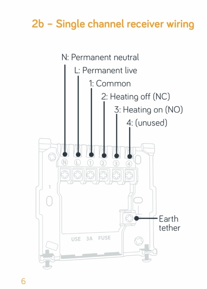

Hi there,
I want to connect a Hive Active Heating system to an ATAG i24c boiler. Currently fitted is a Center RF Wireless Thermostat.
Is this a straight swap or is their additional/rewiring required?
Pics attached below of current wiring of the Center - middle one for combi. Wiring of ATAG combi boiler and the single channel Hive receiver.
Many thanks in advance for any help.

You'd be much better off with an OpenTherm capable stat such as Nest, Honeywell T6, Salus Quantum etc. Much more suited to your boiler & more energy saving than Hive
Thanks for the reply, I've already got the Hive however so will stick with it for now.
Do you know if the wiring is compatible as is?
L - L
N - N
A - 1
B - 3
