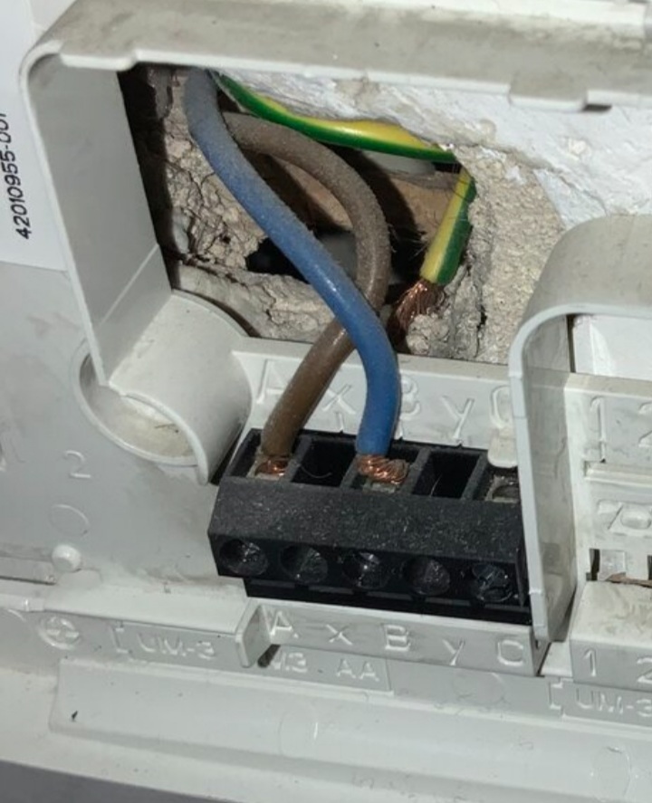

Though a 3-core cable runs from the boiler to the Honeywell CM907 thermostat, the SwL isn’t connected at the Honeywell

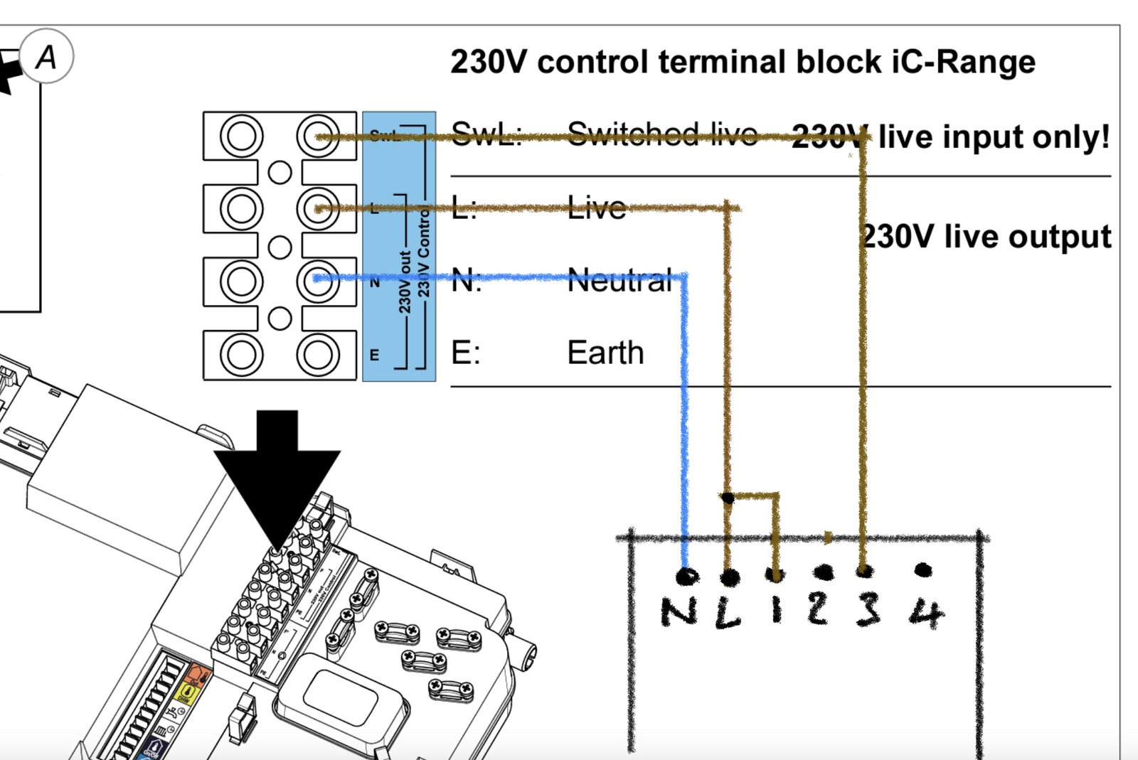

believe that I need to connect the existing L & N from the boiler to the L & N of the Hive and the SwL to the Heating On (Terminal 3 ) of the Hive.

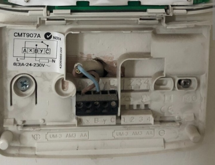

Did your original CM907 wiring look anything like this?:
Yes, exactly like this!
I'm afraid, that's the problem!
In the above image, the brown is live and the blue is switched live.
You don't currently have a neutral.
What is tricky - you would still measure 230V from the live, to the switched live.
If you can find where the cable connects to the boiler, you need to make the wire that wasn't connected (what you thought was switched live) into a neutral.

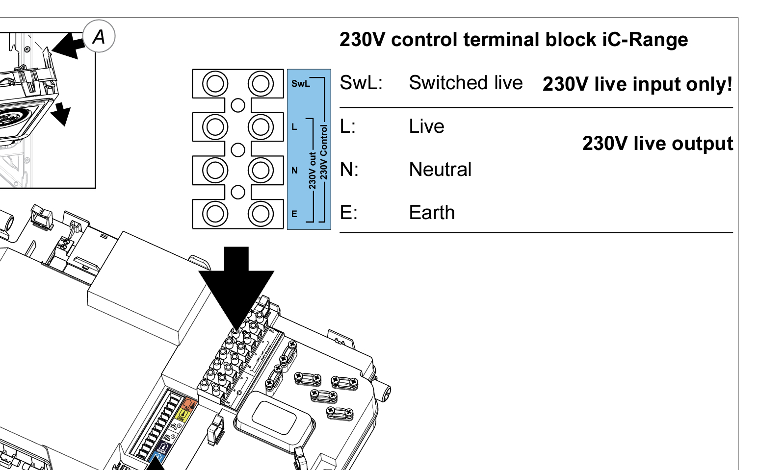

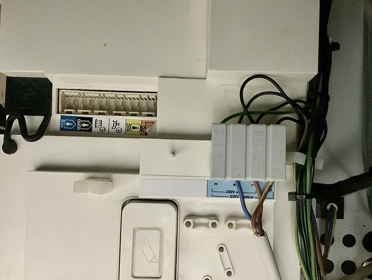

I will send some photos in the morning but I looked at the wiring connections yesterday and there is a 3-core cable connected to the L, N & SwL 230V control terminal blocks in the boiler (as attached image). The SwL is connected at the boiler but not at the Honeywell. The Earth isn’t used.

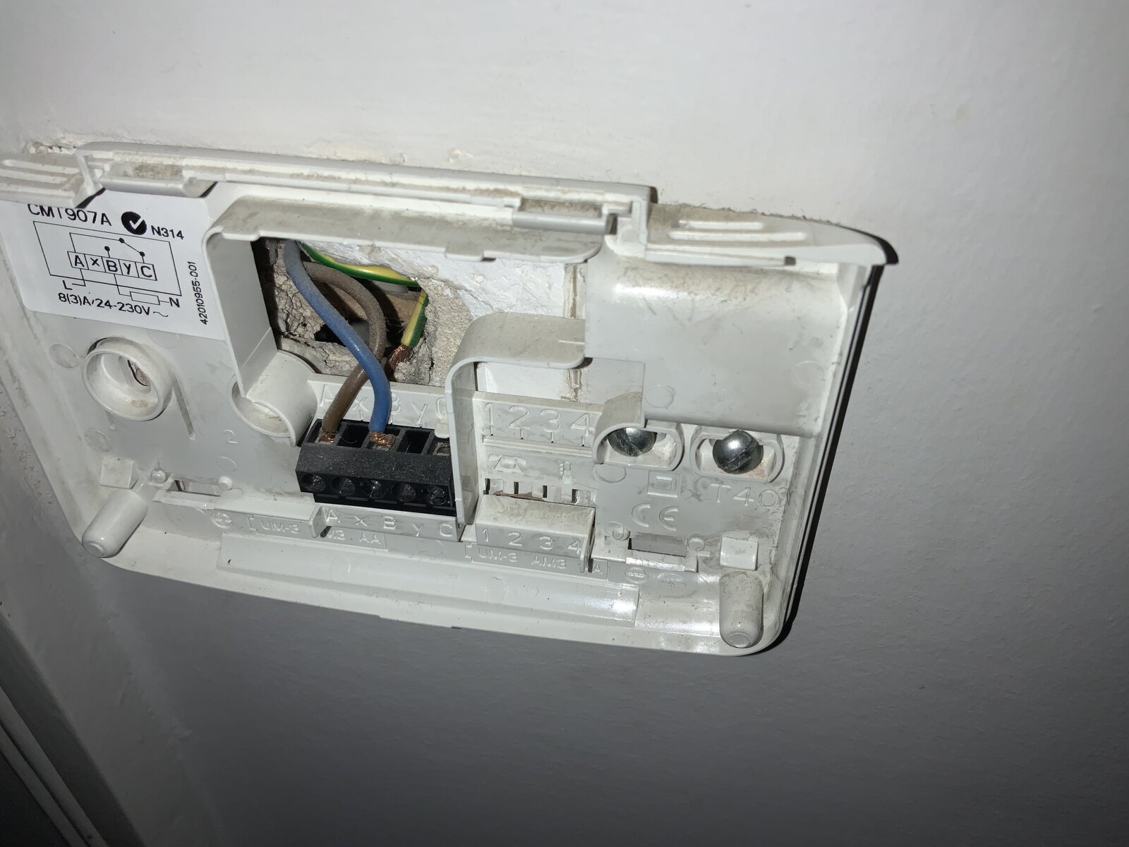

Herewith some photos of the wiring inside the Atag boiler and the Honeywell that I took before I started.
As you can see, the boiler installer used the earth of the 3-core as a SwL and marked it as such with brown felt-tip at the boiler end only. This seemingly however was never connected at the Thermostat and just left bare.
Also, the Atag terminal diagram, marked-up with the wiring connections that I tried last night without success.
