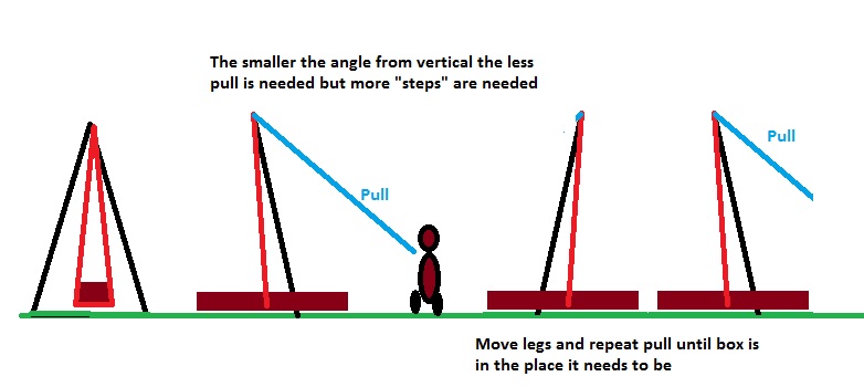

From days gone by this method of moving heavy items worked well using nothing but a couple of poles and some rope. ( and muscle power )
