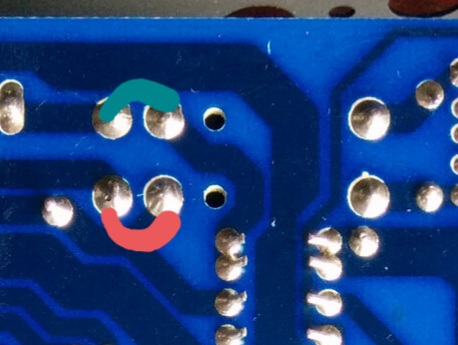

There is power to the relay, 33 volt identical reading on two end pins, presumably for energizing the internal coil. Have yet to learn the mechanism, i would have guessed a pusle is sent such as a square wave on one of the pins to move the relay switch but don't understand why there would be a diode accross those pins as would mean pulse might only work one way unless relay has a spring inside or voltage required is less than forward .6v of diode ? Am in process of constructing a probe to earphone testpiece as kindly reccommended by Harry Bloomfield above.
Did you mean these pins?
The relay has a 24v DC rated coil - if 33V is correct across those pins, the relay could well be damaged.

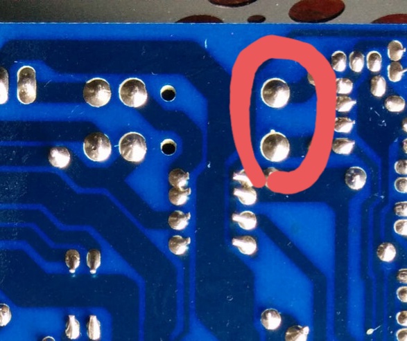

Yes it is those pins ringed in red, there is no voltage across them under power, the 33v identical reading mentioned in post 37 was relative to ground, i should have been a bit clearer.

Resistance between the pins is 1087 ohms in both directions, taking about 8 seconds in time to get that figure from a few ohms higher prior, perhaps suggesting both diode and relay are broken ?
1087 seems a higher value than I would really expect, so the coil is possibly suspect. You need a diode test feature on your meter, to be able to test the diode - you need to apply enough voltage to forward bias it to conduct and the display should show the forward voltage drop in one direction and a different higher value in the other.
One testing technique to avoid removing components is to simply cut tracks - using a Stanley blade, to cut a thin break to isolate a component. You could do that easily, to test the coil resistance in isolation. You can repair the breaks by simply scrapping the solder resist away from the copper and solder tinning across the break. Any value of resistance less than infinity across the coil would then suggest the coil is usually OK.
