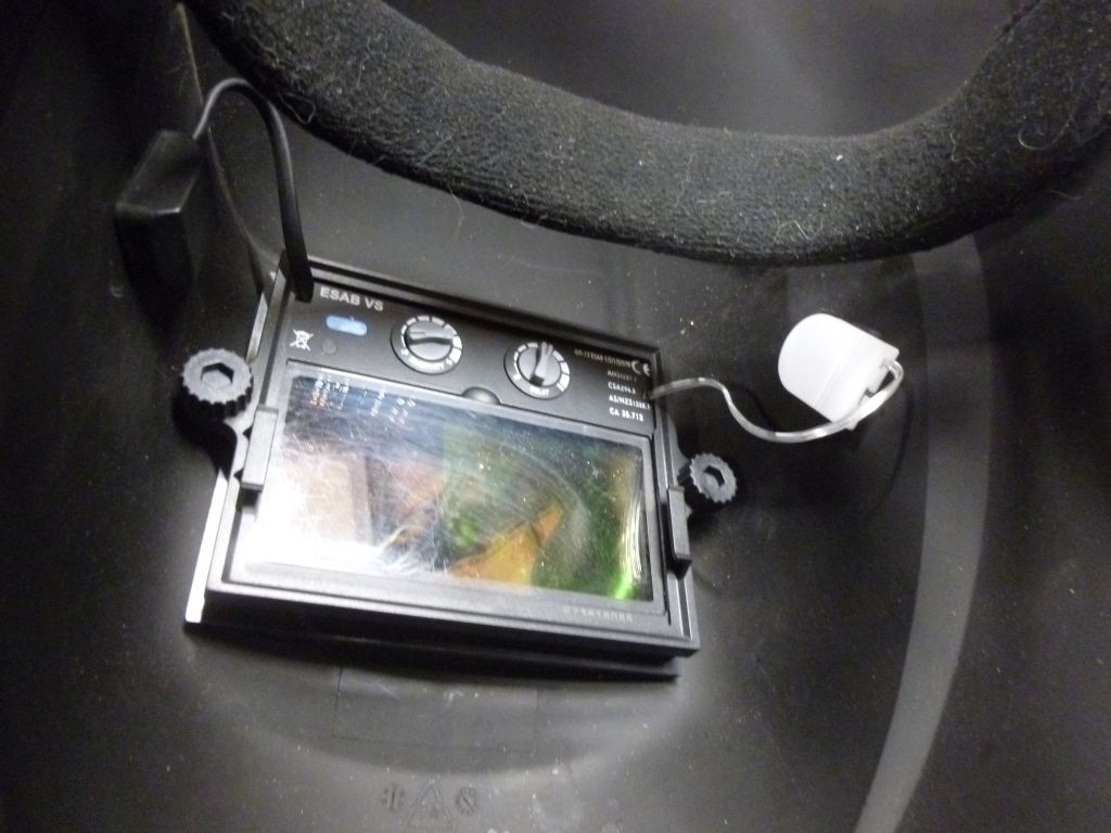

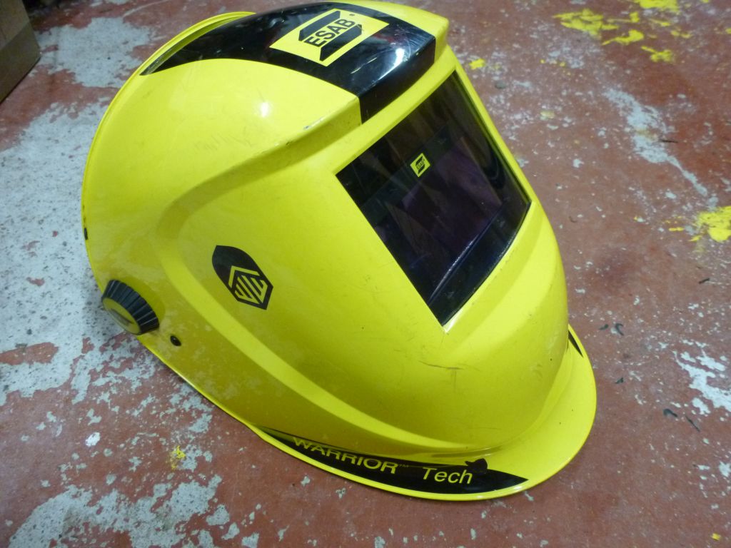

The batteries aren't always replaceable; can you post some pics of your helmet inside and out?
I think the solar panel is just to run it whilst you're welding, the non rechargeable button cell does the switching. So yes they do need replaced after a good few years. You'll probably need to do some soldering.
On mine I soldered in a new battery.
On a friends one more recently, I soldered in a cheap little trailing battery holder, to make the next time round easier!
Yours has a Lithium-Ion Battery, see specifications, bet yours is similar to this...
Nearly all modern helmets have an easily changed battery.

Think that is a bit like my helmet, will check later, but think the batteries are inside the black plastic section next to the dim/sensitivity 'grey' selector. Might be better to buy a whole new 'auto dimming' panel with easier to get to batteries. This is what I'm going to do.
