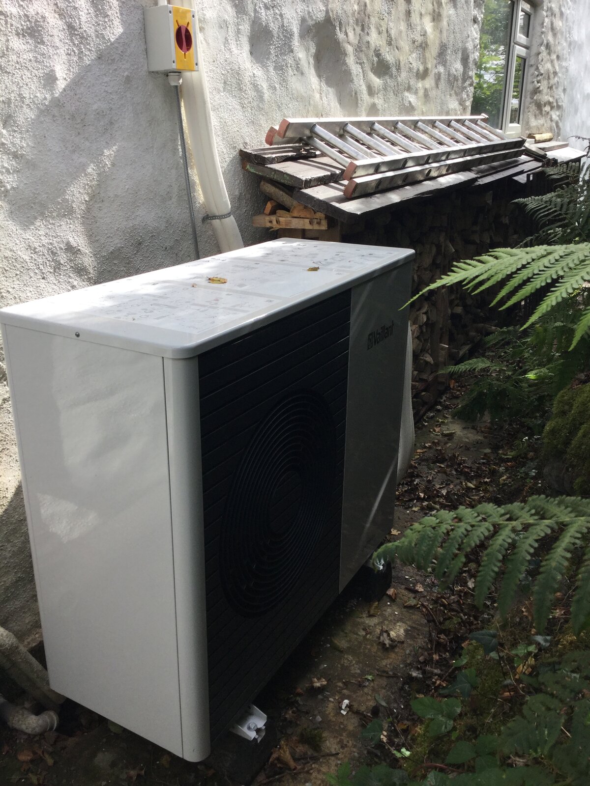

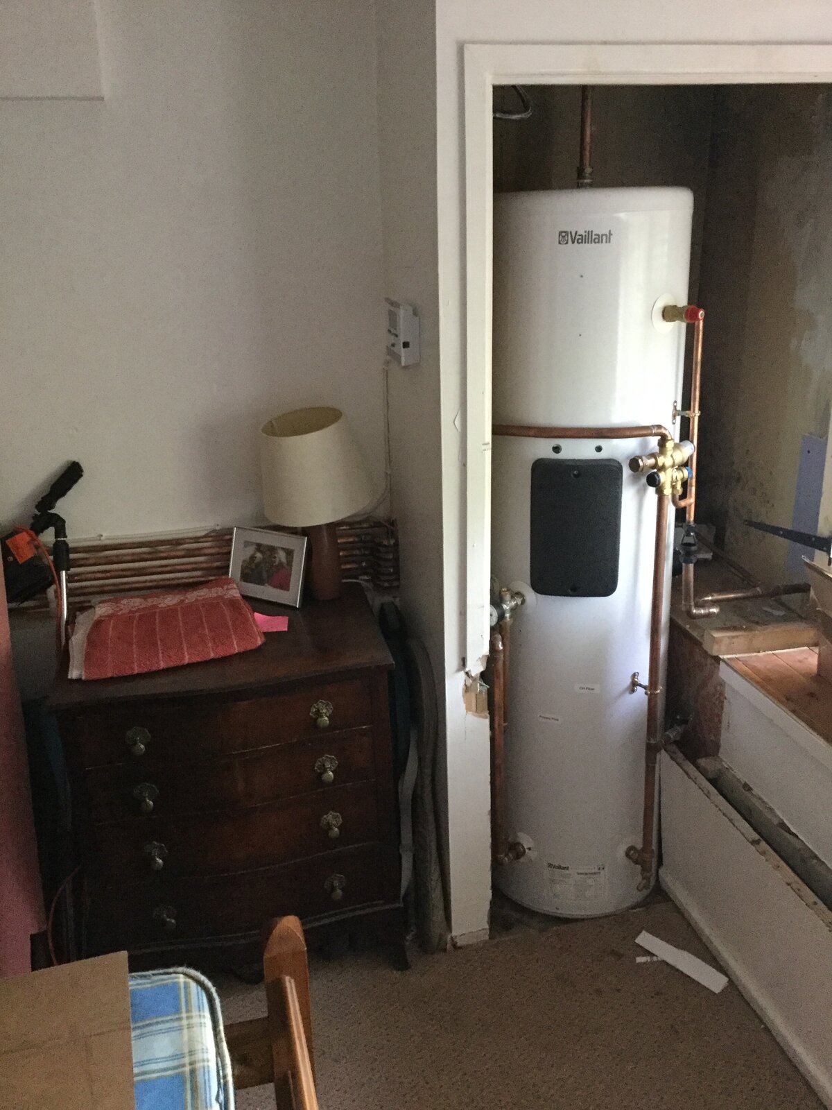

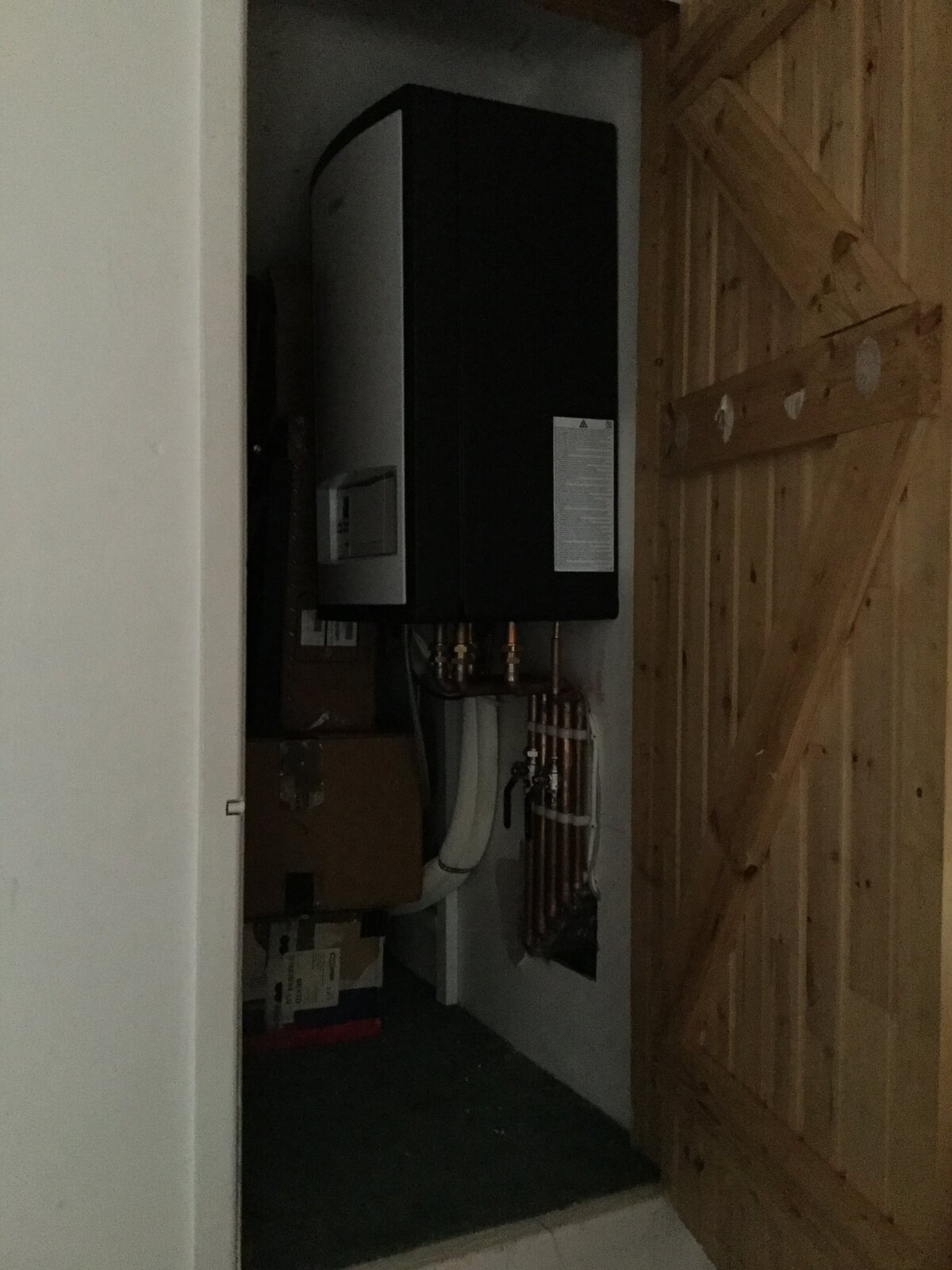

outside fan/ compressor unit, problem hydraulic box unit, cylinder (both in spare room 1st floor, which is bang in middle of house).

The issue is overnight noise. Not from the outside unit (fan, compressor) ..no. Only from the indoor 'hydraulic unit'. Suitcase size box near cylinder, both in spare bedroom. It is this.. a very pronounced whirring pump noise, loud enough to wake me 3 bedrooms away, incessant on-off-on-off bursts 2 am to 6 am..
..it is the -overnight- noise which is the problem due to time it does it, plus the fact that it goes into extra noisy mode during them...
...I know a few things definitely about the noise: it occurs only when outside temp hits 3.5*C & below: screen says 'Heat compressor active' (so the outside fan unit -plus- the problem indoor unit both spring to life, but only one is disruptive): these awful noisy active periods last 10 mins: the silent time between them approx 40 mins: noise is the indoor unit's pump, more specifically engaging at its highest 'rate': it seems to have a few 'gears' ranging from its usual daytime "2nd gear" (just bearable, tho a continual annoying pump whine in the spare room) to a far more prominent "4th gear" high speed mode infuriatingly only heard during these awful overnight 10 minute bursts, prominent enough to be easily heard in every corner of the house (annoying is an understatement: it is prominent enough to wake you rooms away, & infuriatingly audible).

In that noisy indoor unit there will be a refrigerant to water heat exchanger (almost silent), and a pump to take that heat away (to your rads, or other heat load). Clearly if the water cannot circulate because of some external valve (no mention of this, nor photos) then that water may well flow over a by-pass arrangement. This could be the noisy element.

If possible can you take a photo of what is making the noise and how it is attached to whatever surface it is on?
Something like dynamat might be suitable, something with a bit of mass to it not lightweight like rockwool.
