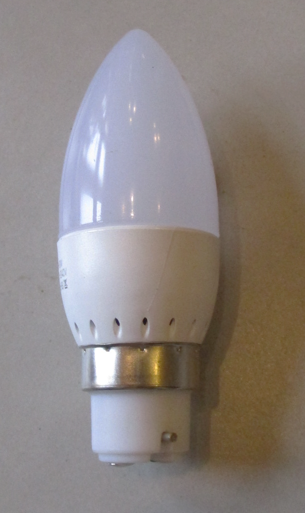

Having just had a look at the cheapo B22 LEDs 'on my shelf', a lot of them look like the below, and I therefore wonder whether there could/would be any reason to think of them as 'Class I'. The only external metal is the small 'ring' - and, if one assumes that the underlying plastic is regarded as providing adequate insulation, there would be no point/need to earth that ring (even if it weren't a 'silly idea'), would there?
Kind Regards, John
