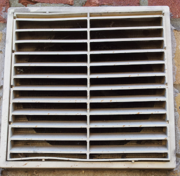

I need help with the cooker hood vent. The space around the the ducting opens into the house letting in air and dust, probably some back flows as well. How can I make it all better please? The americans on youtube cry about plastic ducts are bad for fire safety. Is the situation same for the UK? I can see aluminium ducting available. I believe aluminum burns just as well. Is there any point to it at all?
The ducting end isn't attached to anything.
What are the sizes of the ducting and of the opening?
Also, where are your flaps?
The ducting is 125mm (or maybe 120mm). The hole on the plastic face plate is 150mm ID. The face plate will be destroyed if I were to take it off.
There are no flaps. But I do want flaps. The face plate dimension is 172x172mm.
There should be enough play in the ali duct to enable to secure it to the flap using a really big jubilee clip.

After extensive research, a flappy vent has been ruled out. It wears out, or gets blown apart by wind. I can now see the reasoning behind metal vents. On balance, the original vent is best. I am unable to find a direct replacement. The closest is the following, with a 5 year warranty. Not that I care about the warranty, but the plastic should be reasonably robust. Once installed correctly, it should last a liftime.
I beg to differ, our extract hood 'flappy vent' and likewise the bathroom, were installed by me 20 years ago and the are still good as new, working how they should. Idea is - the pressure of air from the running fan should be able to open them, but if the wind blows against them, they close to prevent dirt/cold air entering.
The existing vent lasted 30 years. If I didn't have to destroy it to redo it, it would last forever. There is only one flappy vent on the market with insect guard and it looks flimsy. For lowest risk, I will stick with the old style. One possible improvement is adding an inline non-reverse thingie near the vent. At the moment this is part of the cooker hood, which means I have a whole column of cold air inside the ducting inside the house. This acts like a heatsink and bad for the winter.
