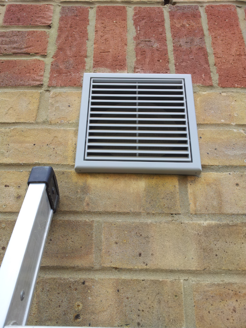

Bad cooker hood vent

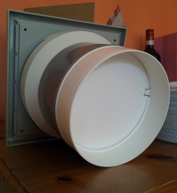

I believe I have a solution. I will get a non-return ducting valve and sand half of the flap to unbalance it so that it becomes a gravity flap. This will keep the ducting closed off from the elements. A potential problem is wind pulling it open and pushing it shut resulting in clacking noises. Wind can actually suck, people in cabals probably don't know this. Wind doesn't care what type of flap it is. It will be an experiment, I will take it off if I don't like the noise.

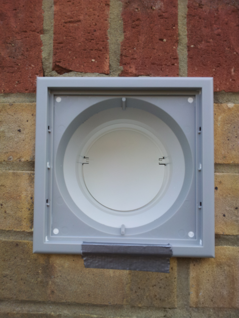

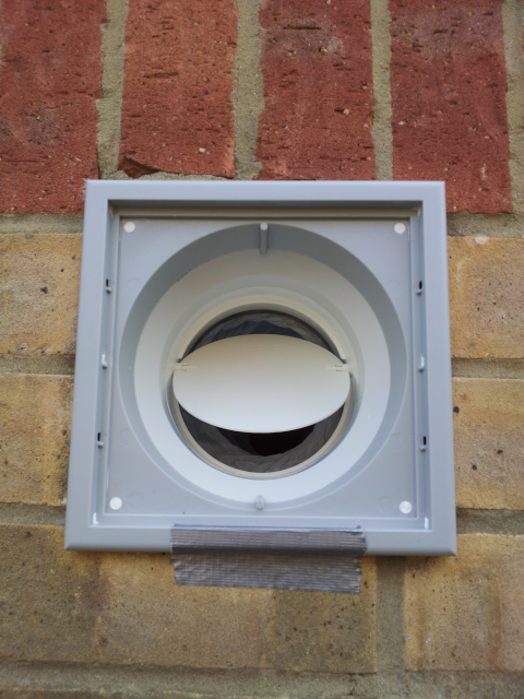

Got my gravity flap vent. The flap was unbalanced by design, allowing gravity to work.
Well, that's done it. I have not yet fixed it in place with hybrid polymer sealant beads. Will need to give mortar repair time to harden.
