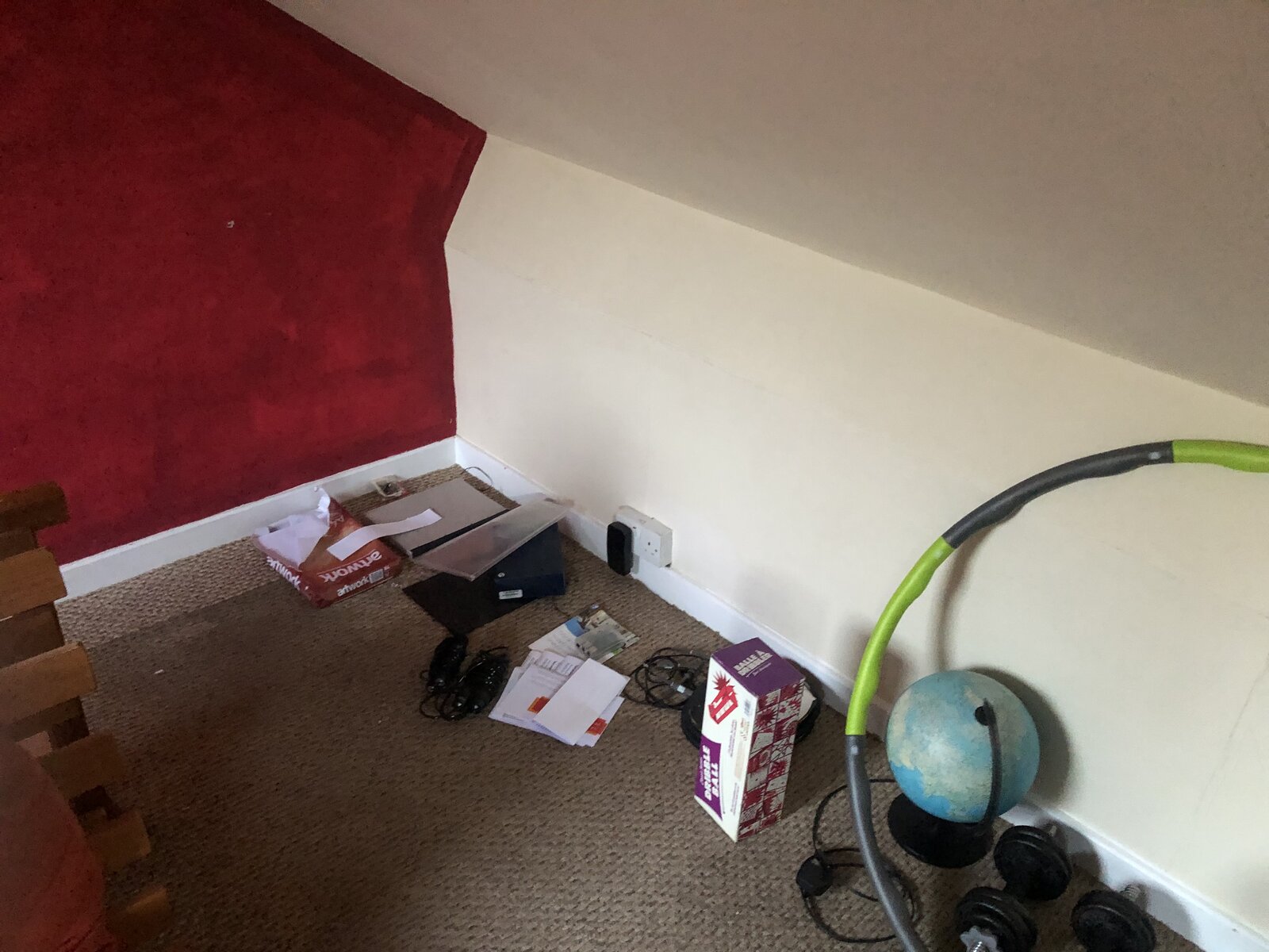

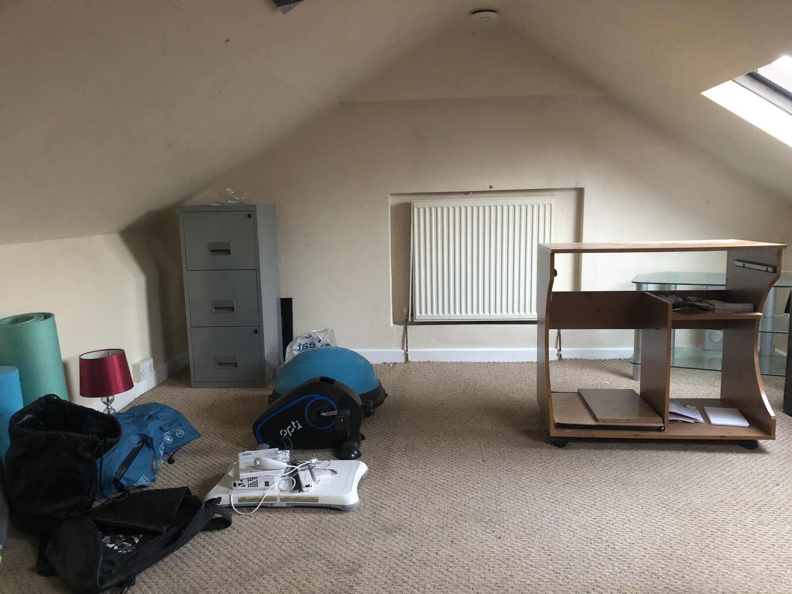

He only wants to use it for storage, but would rather be able to walk on floorboards rather than floorboards having insulation on top of them (mind you, that could be the cheapest solution), along the lines of what Old Duffer did in post 9, could he not get some sort of thermal board and simply attach it to the existing plasterboard?
Then he's heating the entire loft. For storage substitute the "mineral wool on the floor" with celotex with chipboard loft boards laid on top.
If you insulate the floor the loft will get very cold and therefore mouldy. You would have to add plenty of ventilation to outside and maybe a fan on a timer to blow air from in the corners. And ideally some dehumidifier or background heating.

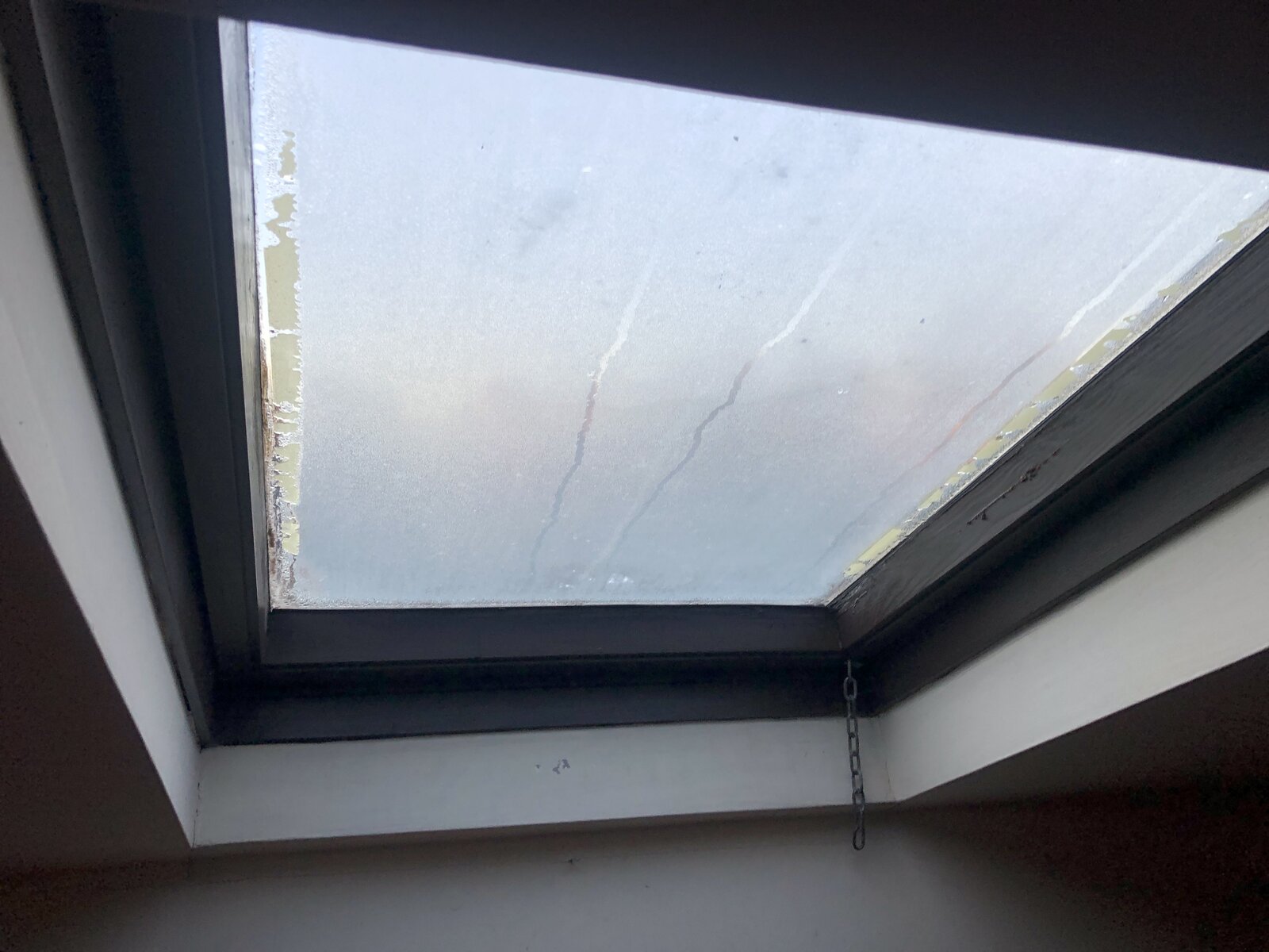

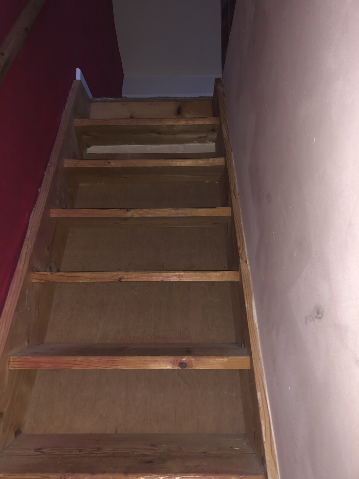

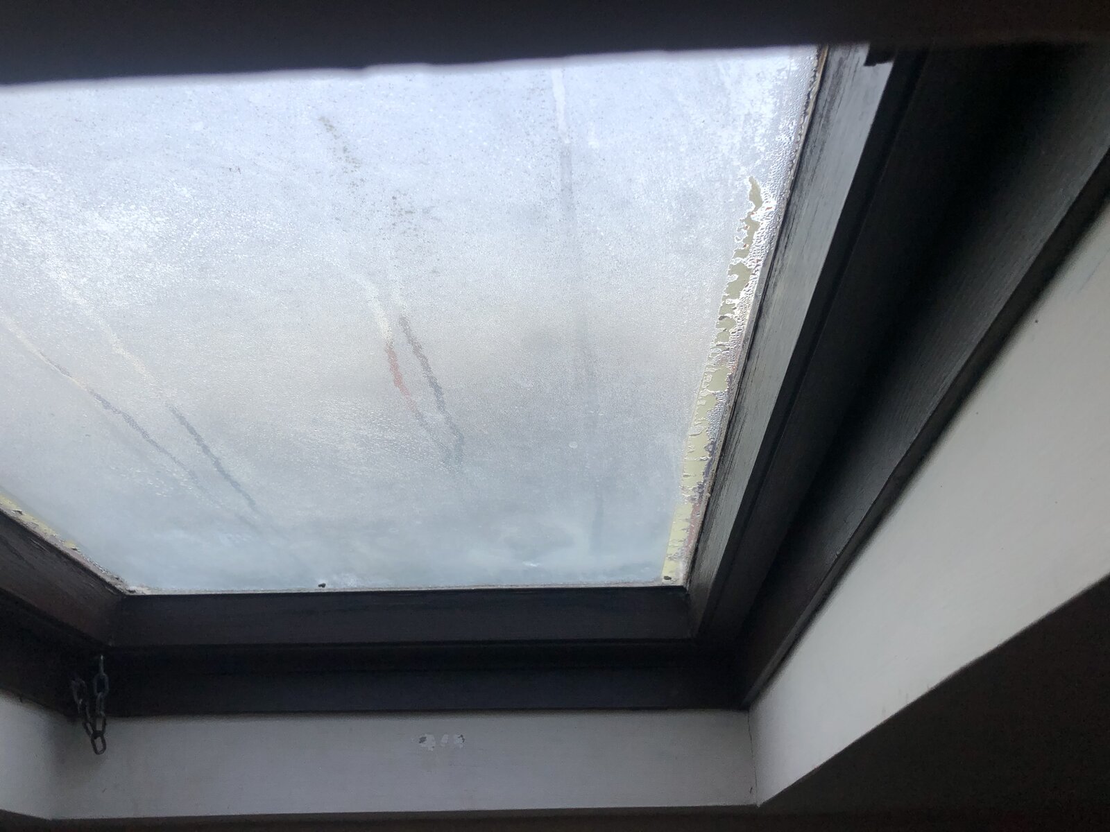

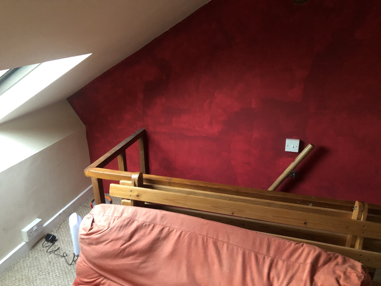

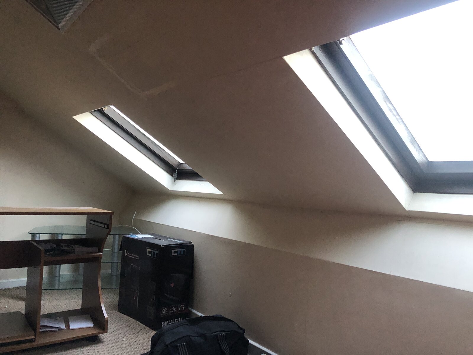

Here are more pics of the attic, loads of condensation on inside of both windows

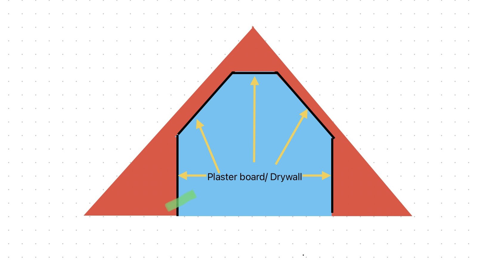

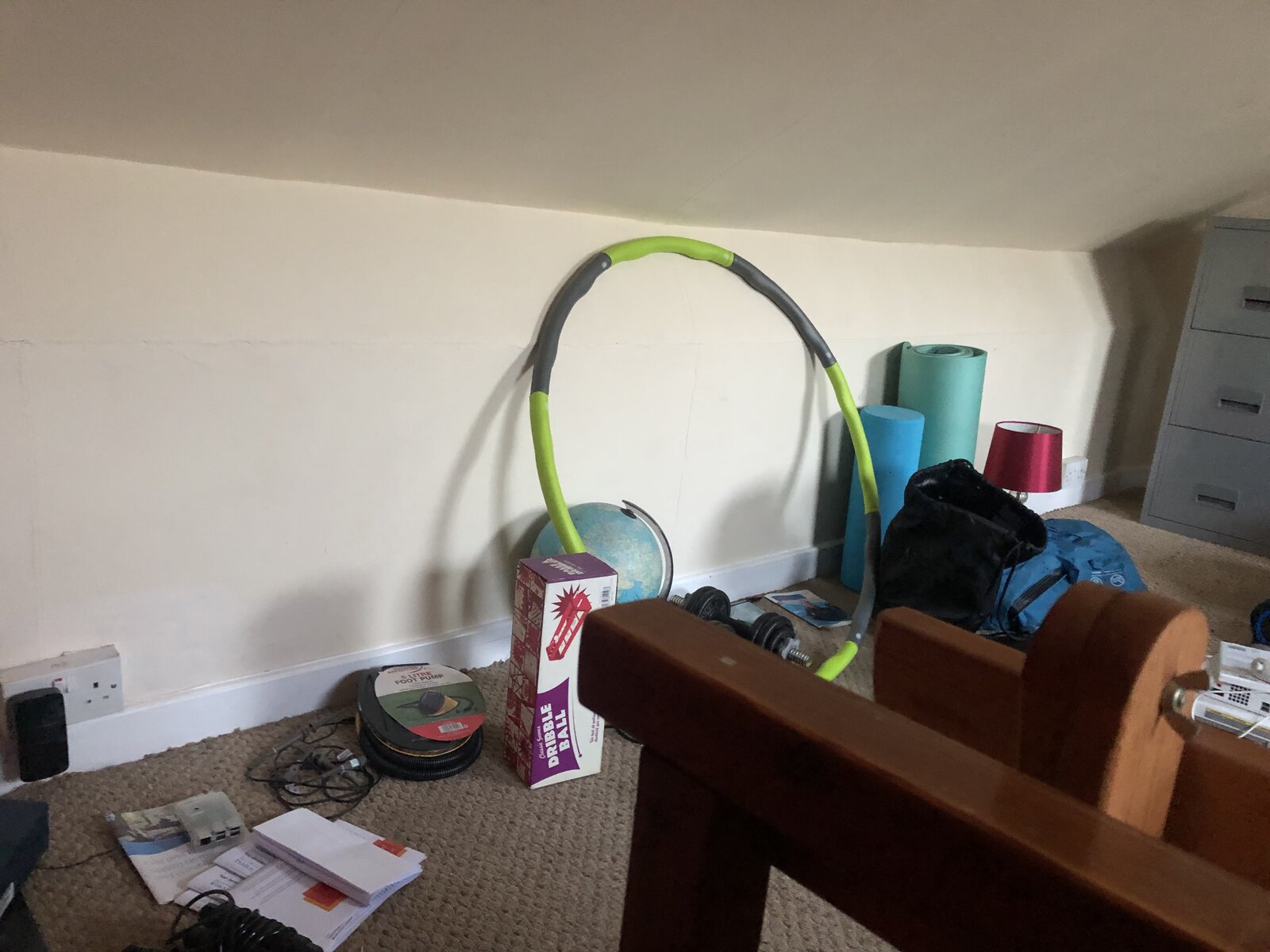

Attached is a crude drawing showing the attic, the blue being the accessible part, and the red is behind the plasterboard.
I‘ve just drilled a couple of holes (green mark on pic) so I can see the attic floor behind, zero insulation.

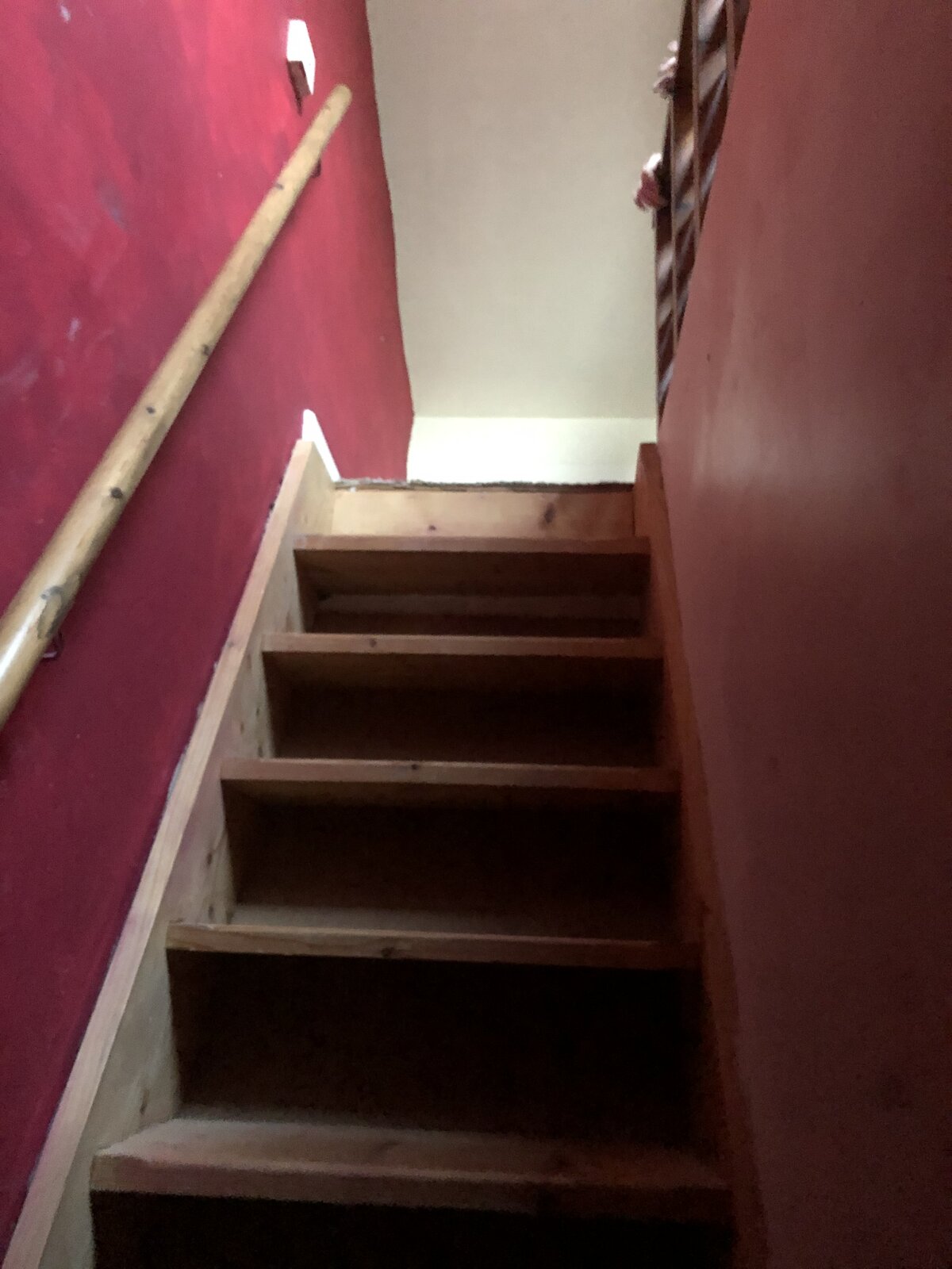

If the stair is open to rest of the house, moisture from cooking, washing, bathing - will rise and condense out in the coldest parts, which are the windows.
Surprised you have had to drill holes to investigate - usually access panels are made each side, to gain access to the wings. Might it not be worthwhile to make some proper access panels, to insert insulation?
