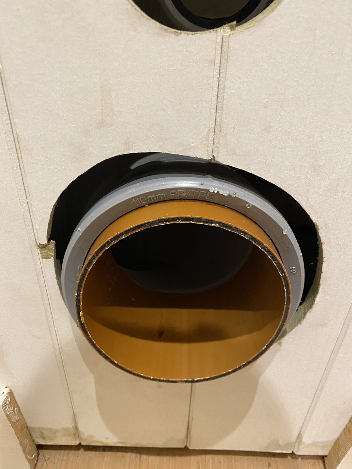

Bad plumber = leak and more. WC connector help please.
Found a photo of the connection to the existing stack. It's a mechanical coupling like the one in the link below. The old pan was located to the left of the room so the connection was a straight one. Cast came straight in to the room and connected to pan. The plumber cut this back and connected to it with the below.
https://www.drainagesuperstore.co.u...e-ductile-coupling-with-continuity-100mm.html
Don't think i have much choice but to stick with the existing connection height.
Thanks though.
I'm now thinking i'll put a plinth under the loo which will raise it enough to allow a straight pan connector rather than 18mm offset connector that the 'plumber' installed.
Bah!
Perhaps you might find a pan with a slightly higher foot-spigot(outlet) distance.
Best of luck.
Anyone know if the terracotta pipe will be solvent welded in or is it push fit? The female end (grey) says 110mm pp/tpe?
I cant seem to pull out the terracotta pipe but was under the impression that PP wasnt to be solvent welded?
Thanks.
