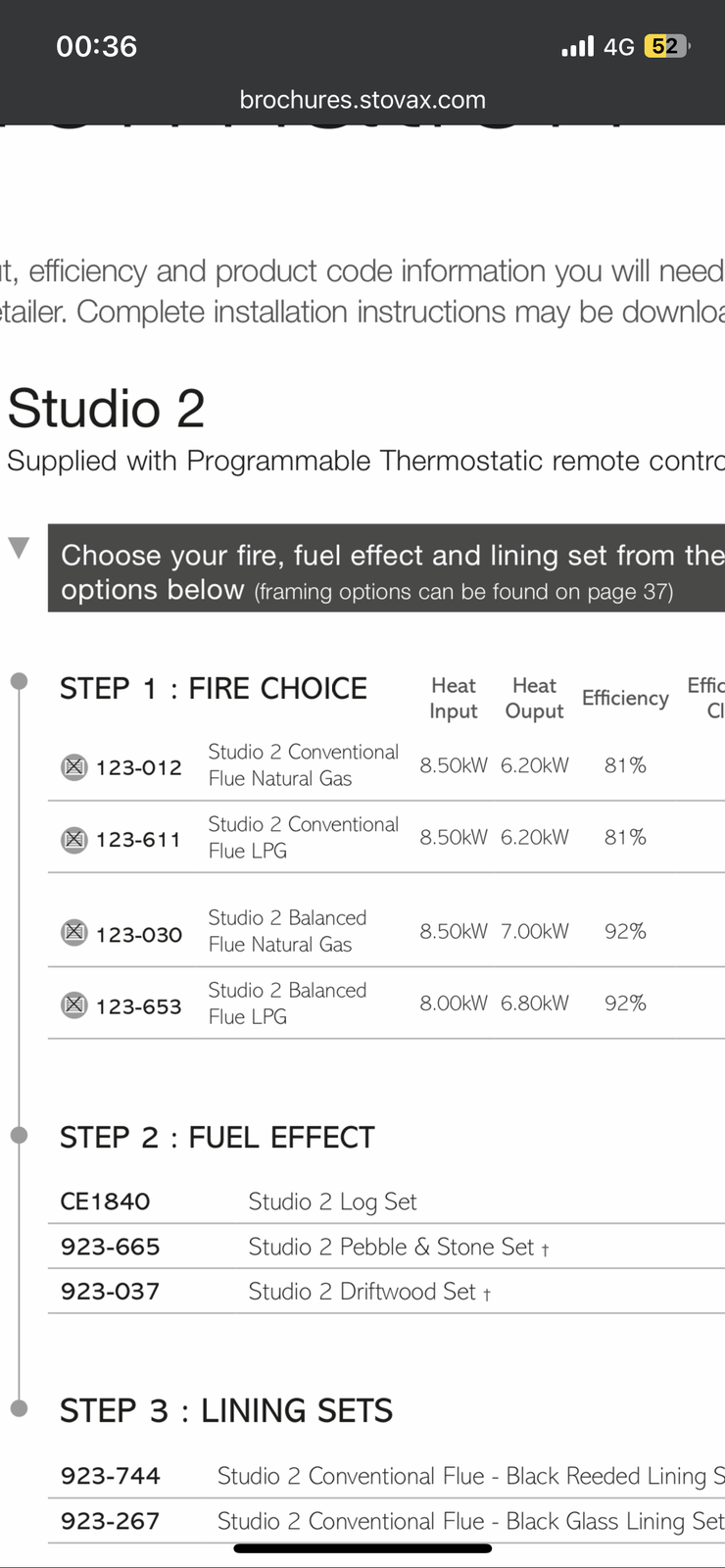

if they check it out and say it’s all working as intended etc. then I may look to swap it out for something larger and a diff brand.

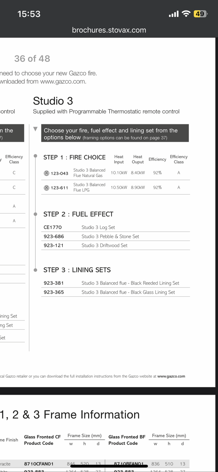

I saw this thing from Gazco called the “Studio 3” but it’s the same thing again…. 8.4kw output…. 10.1kw input… 92% efficiency.
Though I don’t know if that 10.1kw is Hs or Hi…
It's all a bit confusing. I know more about boiler efficiencies and how they are calculated. I've never looked at gas fires before. I actually had no idea they were anywhere near this efficient, I would have guessed about 70%.
I’m wondering if the difference between the input and output only partly influences the efficiency.
it definitely looks like it’s part of the calculation. Like on the image below the lower efficiency conventional flue types have a bigger difference between in and output. But still don’t add up. So there must be another factor that affects the calculation?
To be fair I don’t think you’re far off in real terms. They’re all like 75% based on in and output
The figures are very confusing. These people seem to know quite a bit about it. They have a number of articles on the website about modern gas fire improvements and mention a British Standard for calculating efficiency BS 7977-1:2009

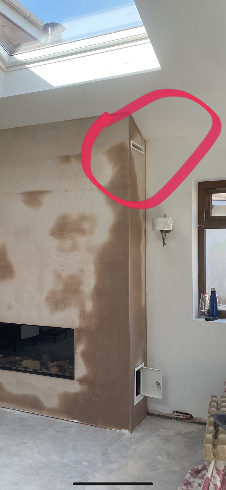

is that an opening velux window if so that flue terminal looks far too close the usual distance is 2metres away when below velux
